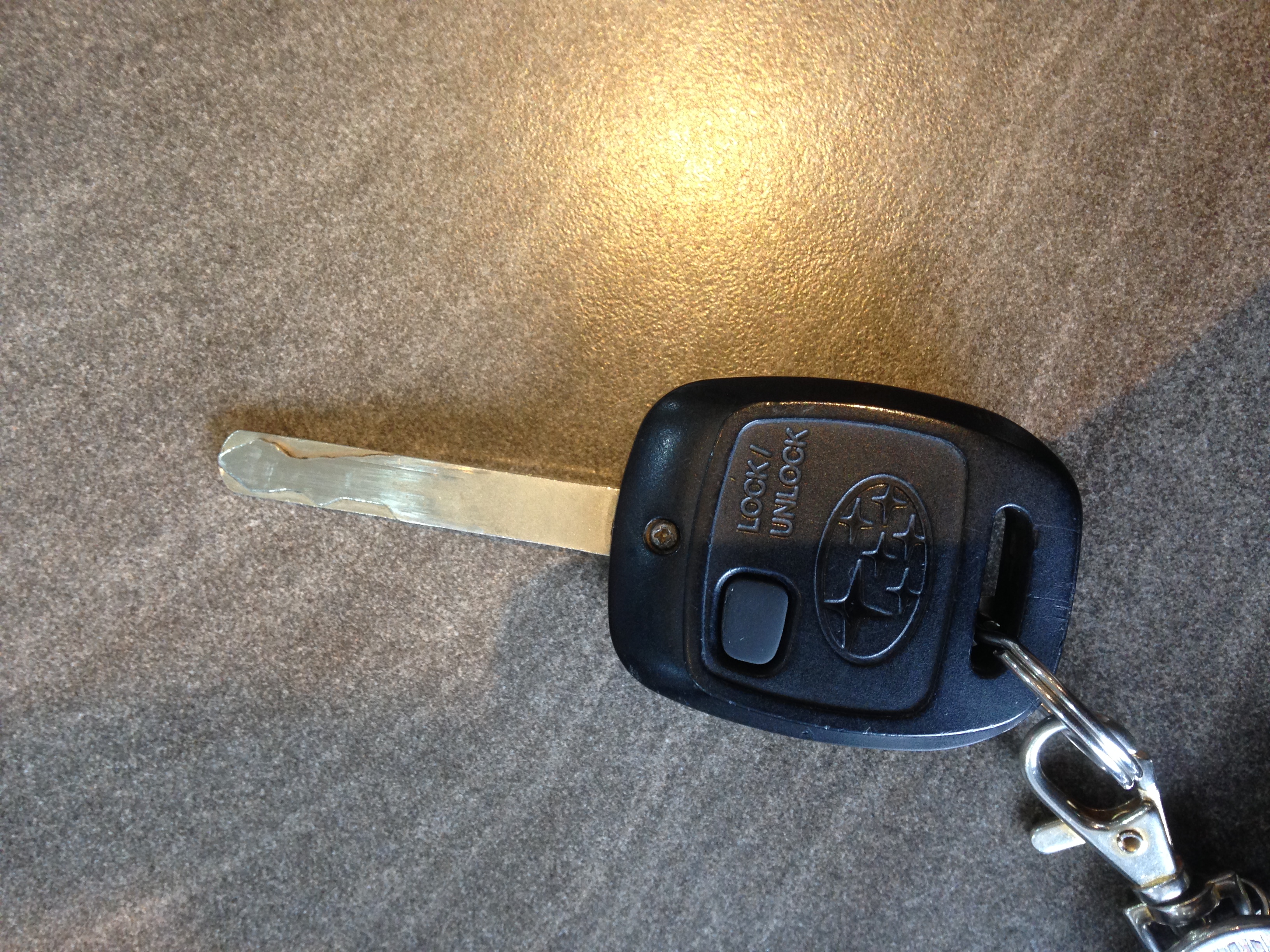

Hi,
I am with family for Easter.  The alarm on my Subaru is going off.  I can unlock the car with the key, but the button does not work. So my alarm goes off and the immobilser wont let the engine start.  When I turn the key ignition lights do turn on.  I have recently changed the Battery, but changed it again this morning to be safe.
As I am away I am desperate to get the car working again. Please help
Greg
Car Battery was changed last summer as was the key Battery (I changed it because the range was poor and hoped this would improve the range, unfortunatly it just seems that Subaru have a woeful range).  When it stopped working today my first option was to re-change the Battery in the key just in case, but no change.
I have since discovered a key pad in the fuse box area, but don't have the code.
Im considering driving home (6 hour round trip) in a friends car to see if the code is in the service book.  I have called subaru who say they dont hold the codes on Subaru UK do who wont be able to get back to me until Tuesday after the Easter weekend :(

Hopefully your remote at issue, go home get other key which assume is remote key same as one shown above & use that to disarm the car then use it to code a new 4 digit pin number >

I drove from Bournemouth to Nottingham and back last night to collect my spare key (yes as pictured above) and my code.  Luckily the spare key worked so I am now back on the road.
The first key still doesn't work, does it now need replacing?  I will get home before I try anything with the code, but is there any guides on how to use the code and the key? Mr B you mentioned that it is possible to re-program the code, although I'm sure it is simple I would like to read a guide first as the consequences of !Removed! it up I assume will be very steep financially.

If your key needs repair look at this service > http://www.ebay.co.uk/itm/Subaru-1-Button-Remote-Key-REPAIR-SERVICE-Impreza-Legacy-Forester-/191793198064?
