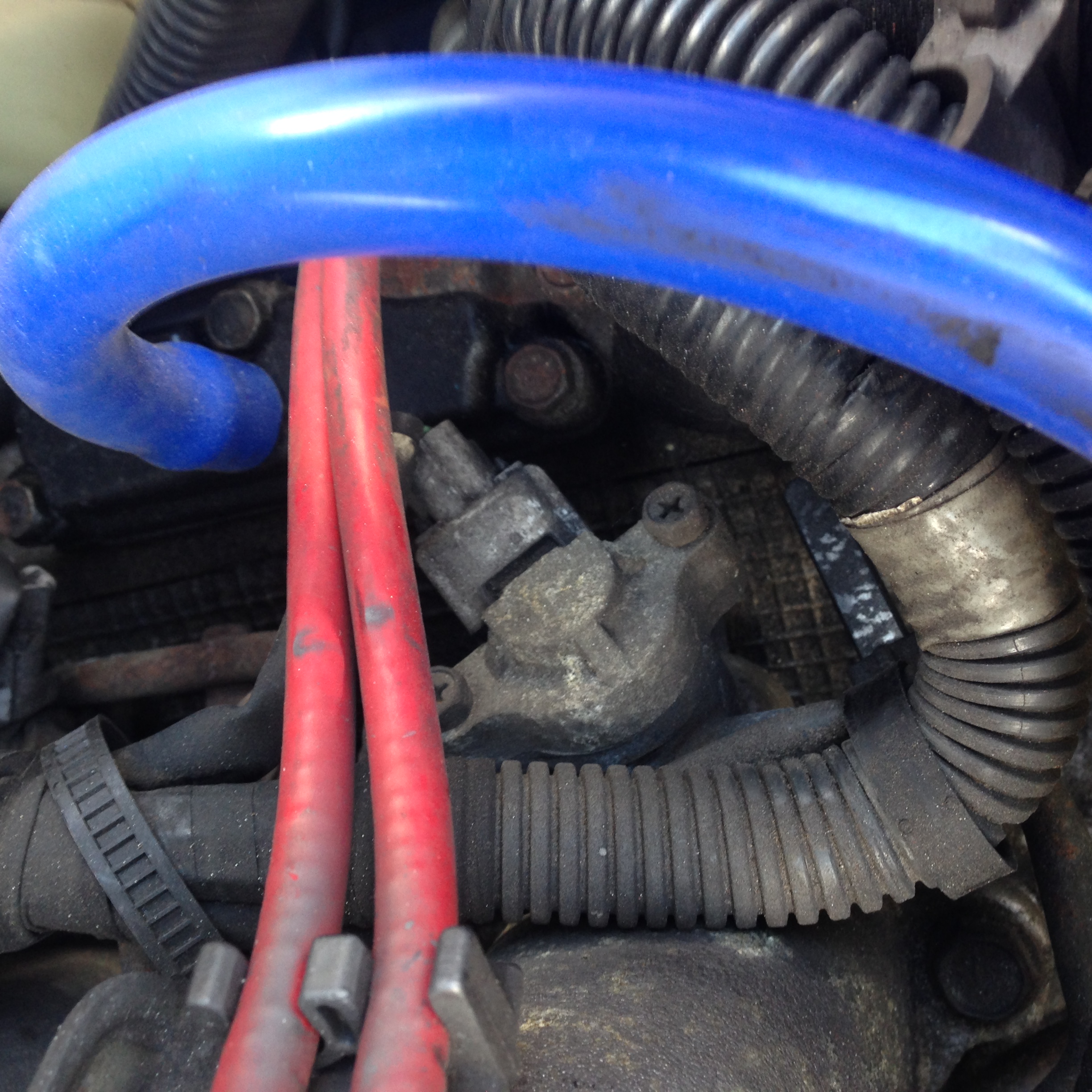

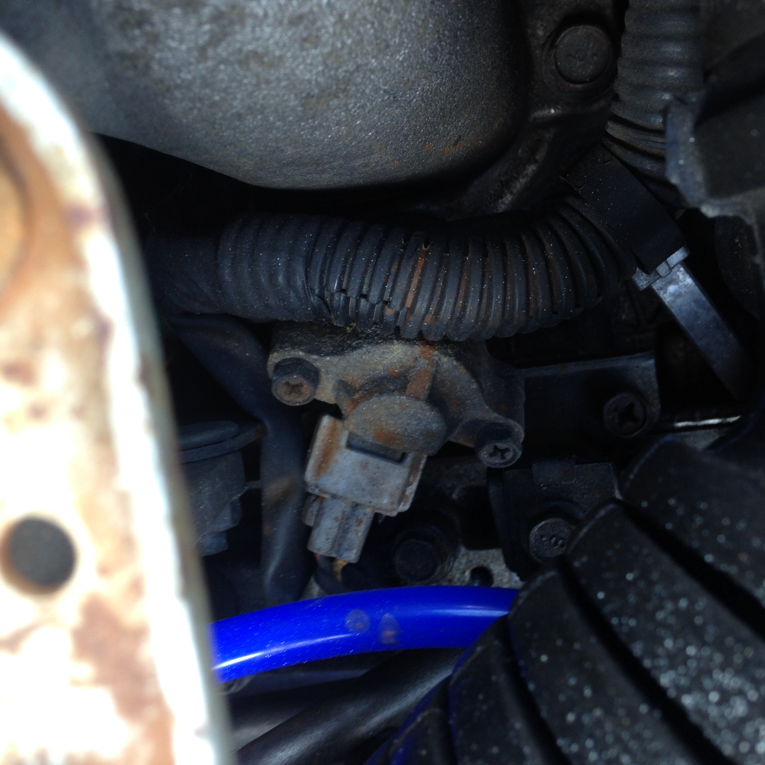

Youngy Posted July 23, 2016 Author Share Posted July 23, 2016 I took a picture of my injectors so someone can tell me which ones they areย Quote Link to comment Share on other sites More sharing options...
savage bulldogs Posted July 23, 2016 Share Posted July 23, 2016 Just seen your pic of the front mount intercooler on the other thread , nice work [emoji106] just stay off boost a bit untill it's mapped in [emoji6] I also noticed it's got a preface front bumper and the coilpack is in the centre of the inlet manifold. So it's probably a late v4 uk and will have grey 380 cc phase 1.5 injectors (good for 290 hp) . Cheapest option is to find some phase 2 yellow 440cc injectors from a v5 /v6 and buy some "phase adapters " total cost about ยฃ80 . Unless your 100% sure the second hand yellows are good, it might be worth getting them flow matched or cleaned (about ยฃ120) . You won't want to drive it far once you fit bigger injectors, cos it will be over fuelling, so keep it under 2.5k and fit em the day before the remap. [emoji6] If it's not broke .....upgrade it ๐ Quote Link to comment Share on other sites More sharing options...
