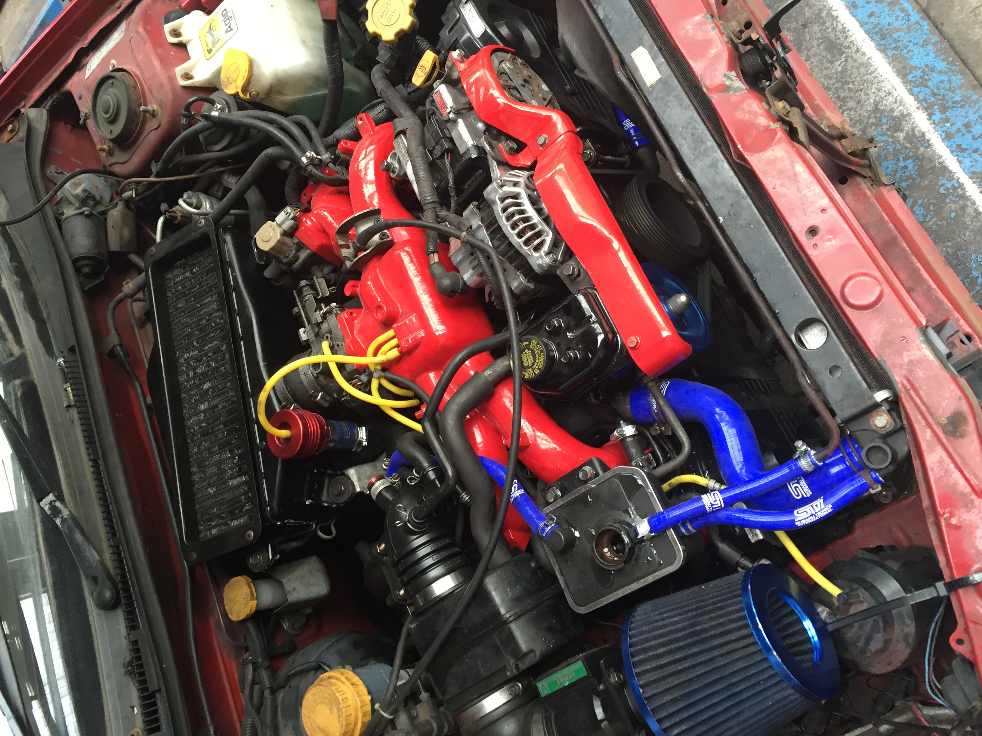

Just rebuilt my impreza gc8 2 litre turbo ej20, just want some advice on the best oil grade to use?

In general, has td05 an air filter not much more really i do have some 10w 60 from my m3 but not to sure about that? And i have 5w 30 petronas fully?

I currently have 5w 30 semi just whilst i started the car, but have ran it for a good hour on idle, and done about a mile so far just wondering if i need to chamge it before i do the 500 mile bed in?

Yeah i built it myself i was just going to drive it at low revs about 0.5 boost ? Guessing you guys reccomened unpluging boost controller?
