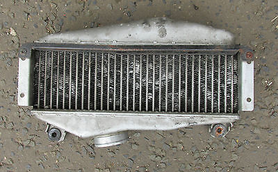

I've been wanting to upgrade my black slanty intercooler to something a bit bigger, but don't want front mount due to my ARC intake, and don't want to chop the engine bay around to fit a newage. I war told that an STi slanty wax the best bet, but that they're rare to find.
Well, I've justy got one, for the huge price of £12!!!!! It's serviceable add it is, but could do with the finds being replaced at some point. All I need now is the correct pipe for it and I stick it on. A good deus work!

I'm fairly sure that the tmic to y pipe bits will fit the sti tmic . The uk/wrx ones will fit the sti tmic on the v3/v4 shape like the pic bellow .2ee7f800ba30507e8b3e0ed302dba5c9.jpg
The v3/v4 uk /wrx tmic has a small bore plastic y pipe which is very restrictive and prone to cracking over time. Most upgrade the plastic y pipe for a bigger bore silicone y pipe to help them flow better .
Maybe you'd be better off buying a silicone y pipe for your current tmic and try swapping the y pipe to tmic bits over . That way if your existing tmic bits don't fit the sti tmic you can upgrade the y pipe on the original tmic. If you do swap the bits over to the sti tmic try to source some new gaskets to lessen the chance of boost leak once refitted [emoji6]
The V2 doesn't have a y pipe. It's a single entry unit with a long hard pipe section. I haven't got any part of the connectors I could fit a silicone part to, unfortunately.

After weeks of searching I found the intercooler, then after another few weeks, the hardpipe. Guess what, they dont fit! The holes for the bolts don't match. Not even close. So, either I've got the wrong cooler, or wrong pipe. Aaaggghhhhh!!!
I'm not sure. It was sold on Facebook so there's not much comeback. It cost me 3 times more than the cooler! I'm going to get the old cooler out tomorrow and see if the new one fits in place. If it does and the pipes line up underneath, I may look into having the pipe welded to the cooler. I can't see me removing it any time soon, so can't really see a downside. I can always bend a silicone pipe from the turbo to the hardpipe.

No mate, in trying to upgrade the standard WRX slanty cooler for an STi slanty cooler. They're much more effective, mainly due to the larger end tanks and the alloy pipe.  I want to keep it as standard as possible, and don't want to chop bits around for a newer tmic, and don't want a fmic.
