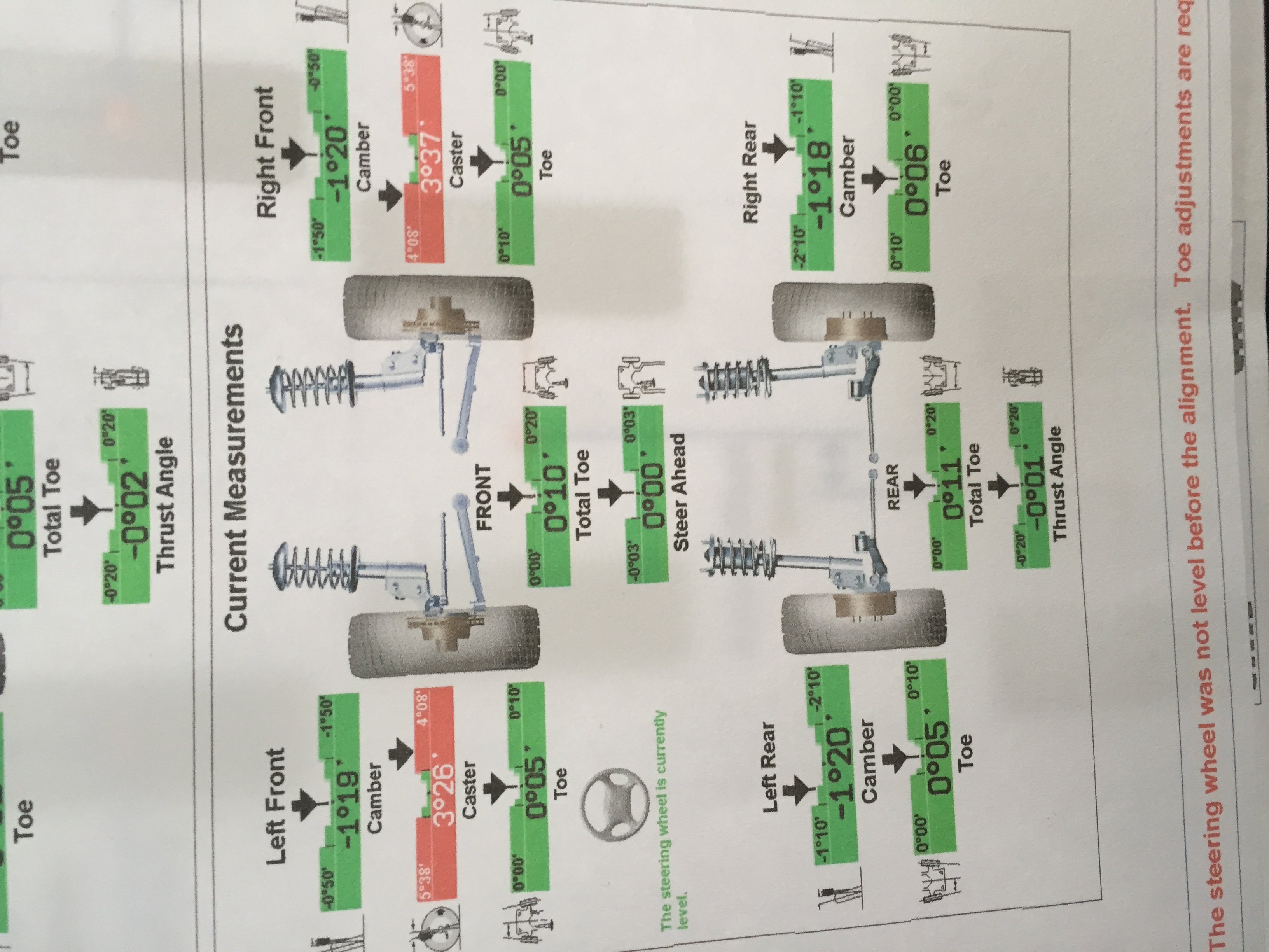

Been looking for that to post on here but I can't find it on my phone lol .
That's the geo set up I went for on my classic as I read (somewhere) that the classic prodrive set up works well but tends to scrub the front tyres a bit .
Like ghost said " I don't know if it's any good for newage" but after 1.5k miles of mainly b road driving I haven't spotted any odd tyre wear yet .
I'm sure a few newage drivers on here have had a "none oe" set up done , hopefully one will spot this post and point you in the right direction.
