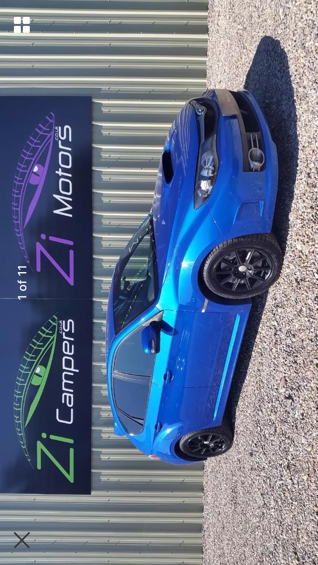

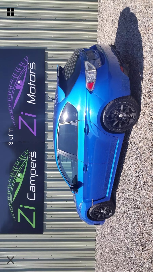

IMG_0598.thumb.PNG.9b6241085da50e213a1c0IMG_0600.thumb.PNG.f76beaf60ea87ba72dadd
Put a deposit on this one [emoji3] waiting for the history fro Subaru
Full service history and the seats go down lol.
Completely standard apart from a stainless backbox.
Just waiting on Subaru as it had a private plate so had to get the chassis number [emoji1]
Great stuff; I'm sure you'll love it [emoji106]
Hope so!
I am so excited for the email tomorrow from Subaru to say its all ok :biggrin:
