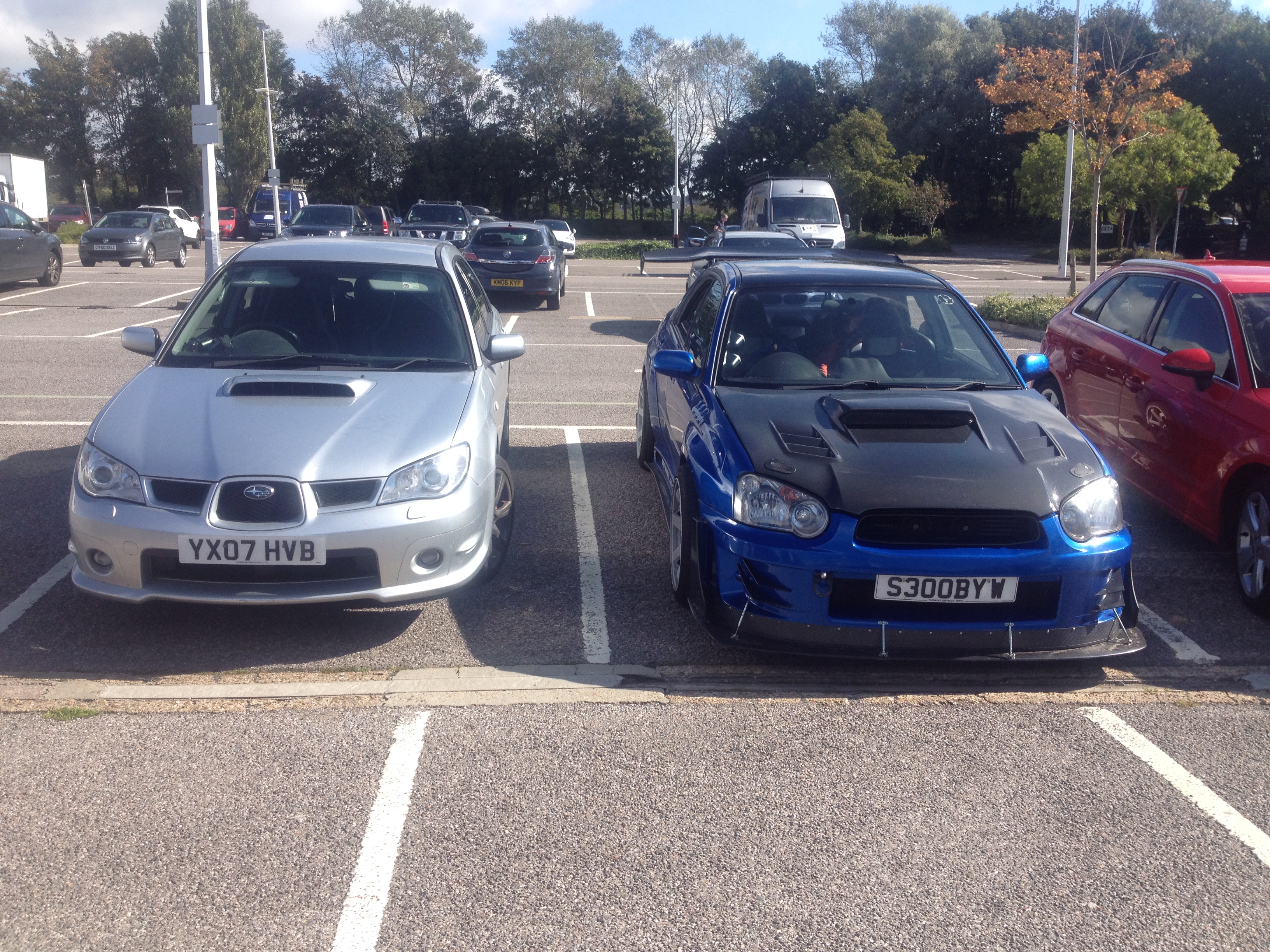

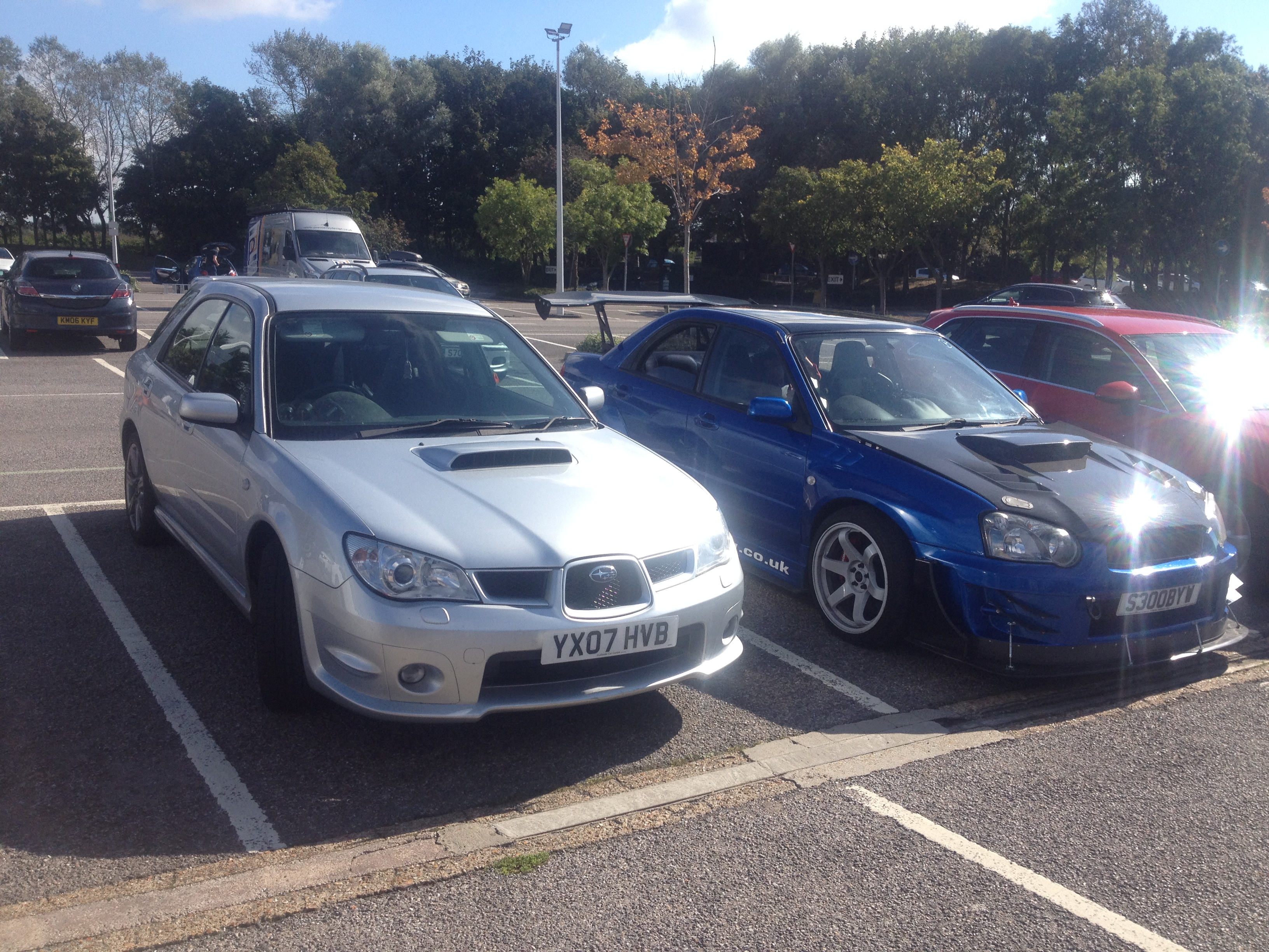

Nice to meet ya mate, shame we didn't sort it, had to go home and polish my car after seeing yours lol mine looked awful
You to mate, !Removed! hell she cleans up well haha and I'm not really sure where to go from this point to be honest...not sure if it's worth taking it to the garage as it could rack up a nice old bill but will tell me what the problem is right away or try and tackle it myself.
