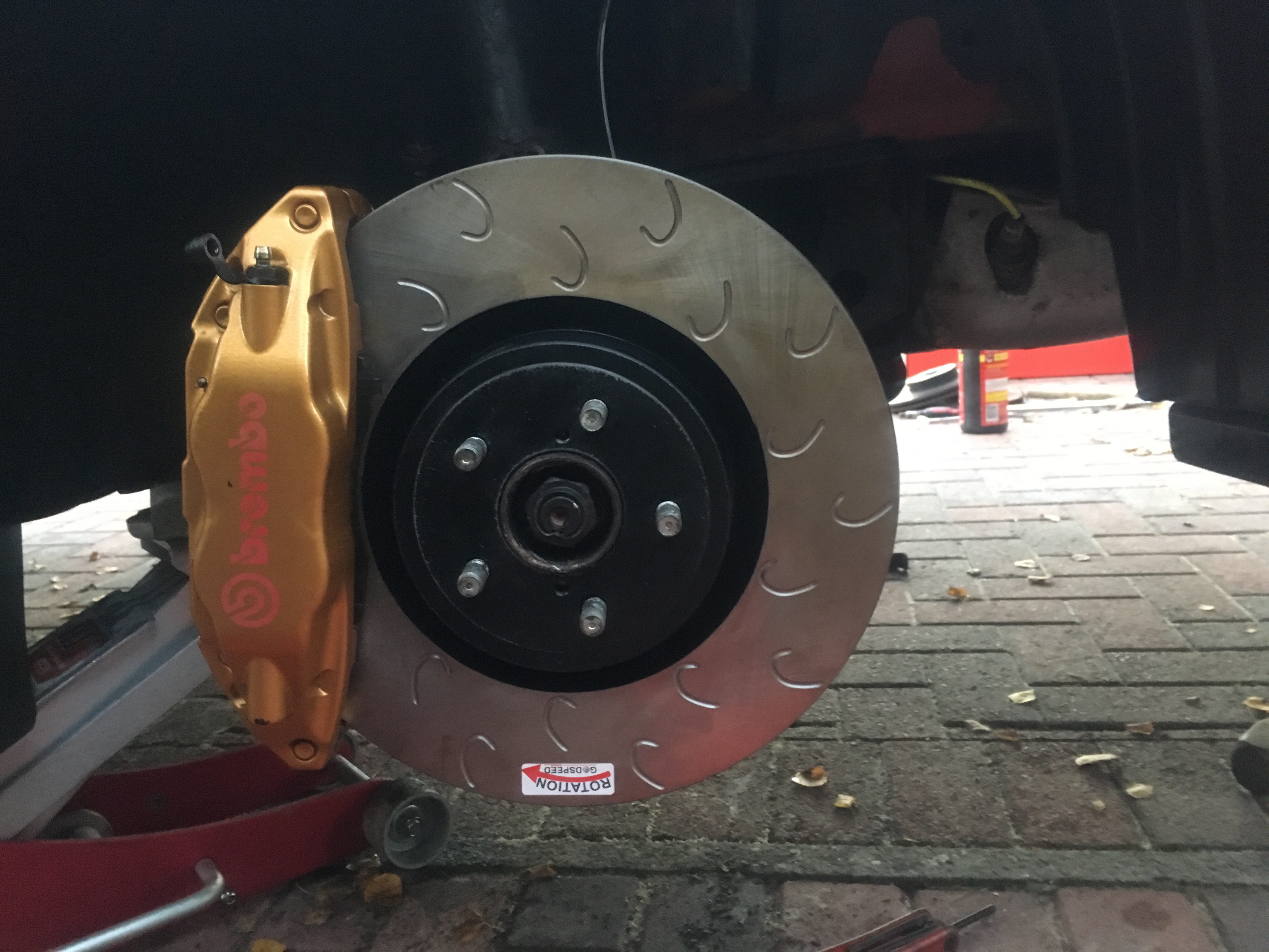

Yeah it was actually a very easy swap. Mine came off a 2005 blobeye and just bolted right up. Haven't got rears which seems to be the complicated part. I got a new set of discs from Ian at Godspeed. Just the same as what's on 2000-2004 sti's I think as they were 5x100 pcd. Think they are 326mm. Went for the g-hook ones. Don't think you need new hoses but I got some stainless ones on while I was in there. Old ones should work though I think. Calipers came with brand new set of PFC pads which seem really good. No noises when cold which I was worried about

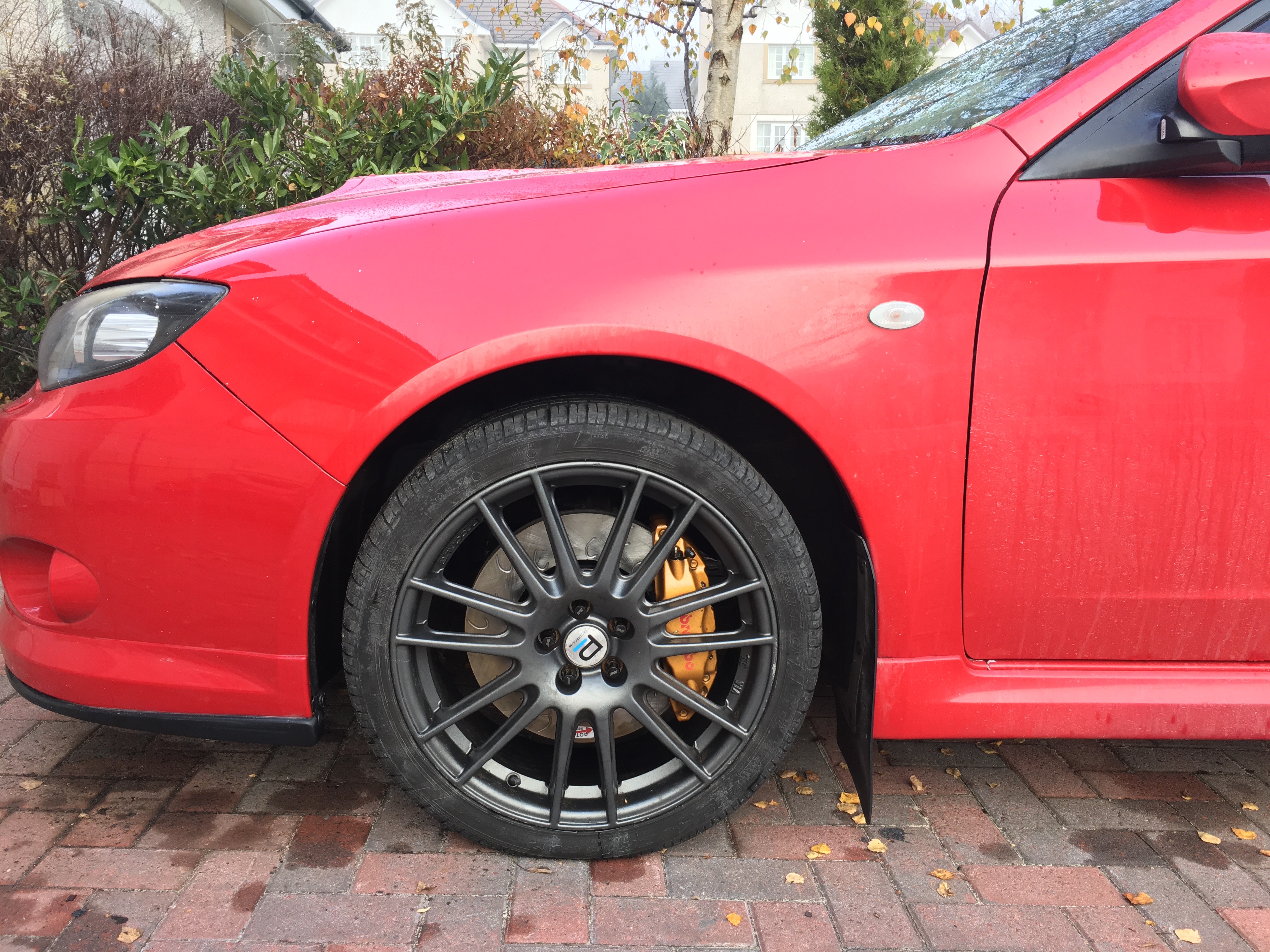

I had a spacing issue when fitting my brembos on the front . Like you , I did my homework to make sure the et of my rota boosts would clear them .
According to the wonderful Web I'd be fine with a et48 but in the real world the design and profile of my rims ment I had about 1 mm clearance.
3mm spacers now give me just under 5mm clearance and put me on the limit for width ,so they're now flush with the front wings
Looking good them mate.think i will take plung and get some gold brembo now av seen them,thanks for info.
