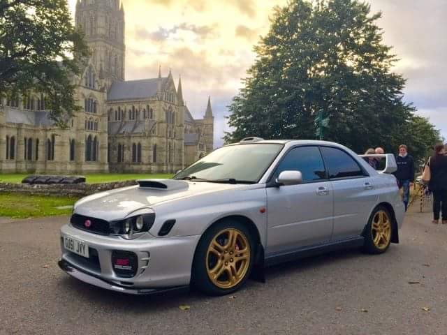

huge Subaru fan' - Totally in love with my Bugeye Wrx! I've previously had a classic, 2 Blob eyes and a blob Sti' -

Welcome.nice looking bug you have their.i have a 08 wrx hatch runnin 320bhp runs great but was gettin chatter from turbo when changin gear,my boost is 14psi so to stop chatter i opened my dump valve to vent a little pressure which work but for some rrason make boost go over 15 psi and makes computer kick it into limp mode,so i closed dumpvalve again and its been ok back to 14psi.could it be something like that doin it to your car.i have read subarus sometimes dont like dump to atmosphere.

Welcome to S.O.C glad to see you have signed up, always nice to see more subaru lovers here:cool: And bug owners not enough bug love :biggrin: Car looks great bit like how mine used to look with the lights but mines blue. :happy:

Thank you Gambit! I don't know what it is but this bugeye has really got under my skin :) it's a keeper! You'll have to post a pic of your bug ;)
