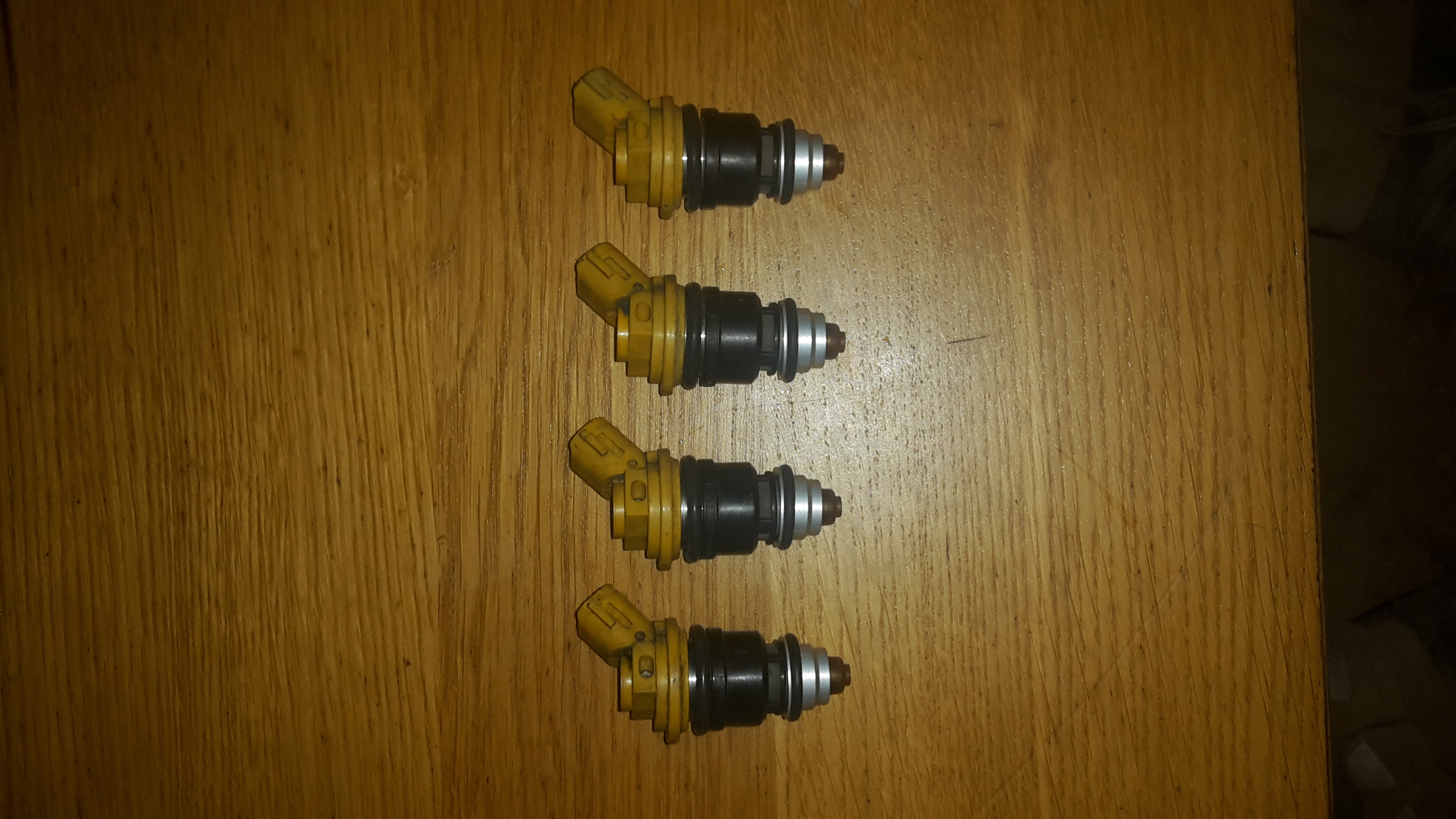

this is just the start of my winter hoarding getting the motor ready for going to see andy forrest in the spring time. Showed the mrs and got the look that only a woman can give haha even though it was her that bought them as an early xmas prezzie how lucky am i lol :clap:

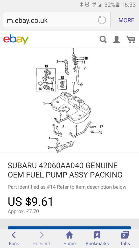

Is yours the oval shaped hatch ? If so I'll dig out the part number

I didn't have a issue with either of my tank gaskets but you'd probably have to not drive it untill you got a replacement (if your's was fubar) .
