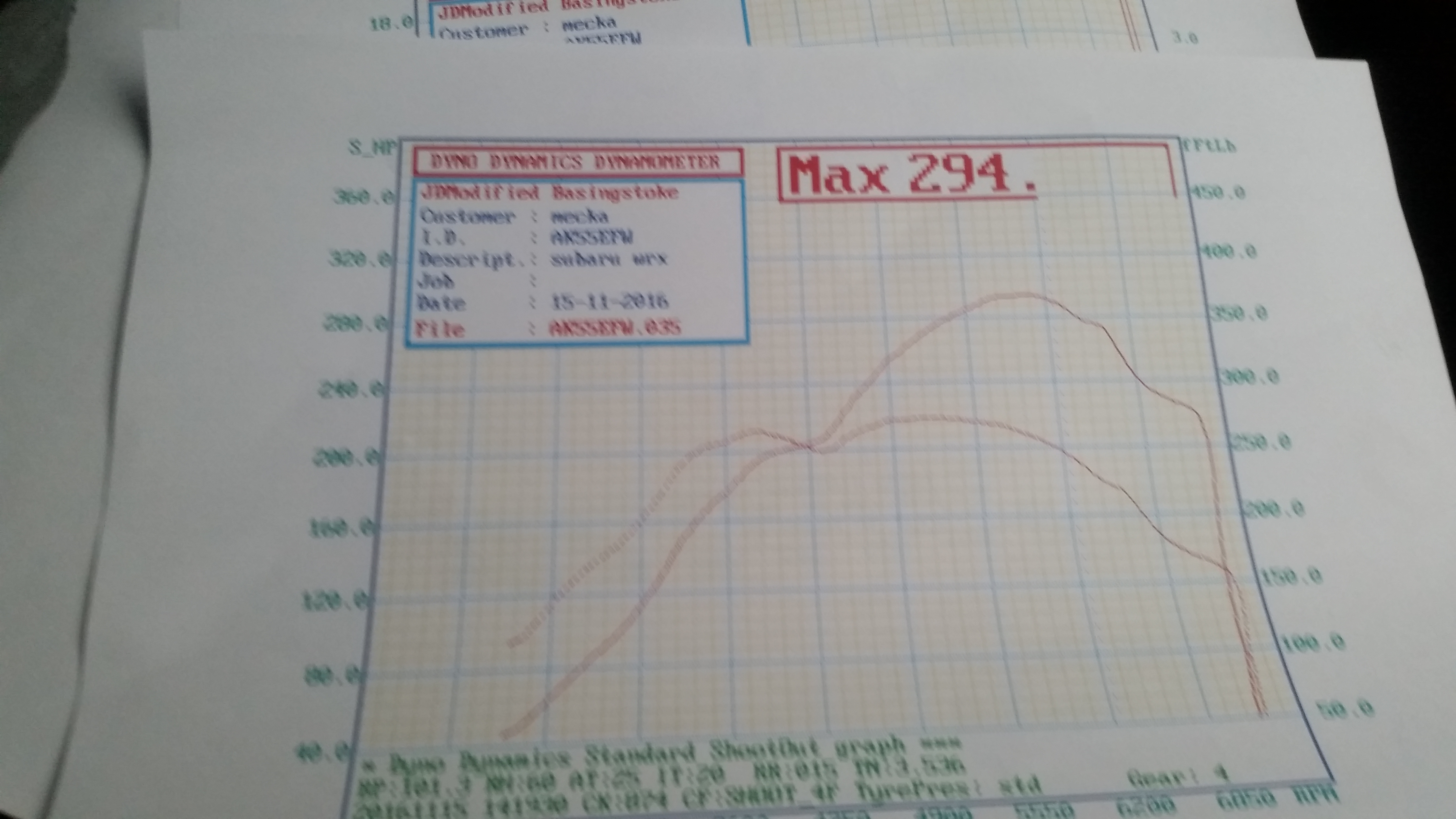

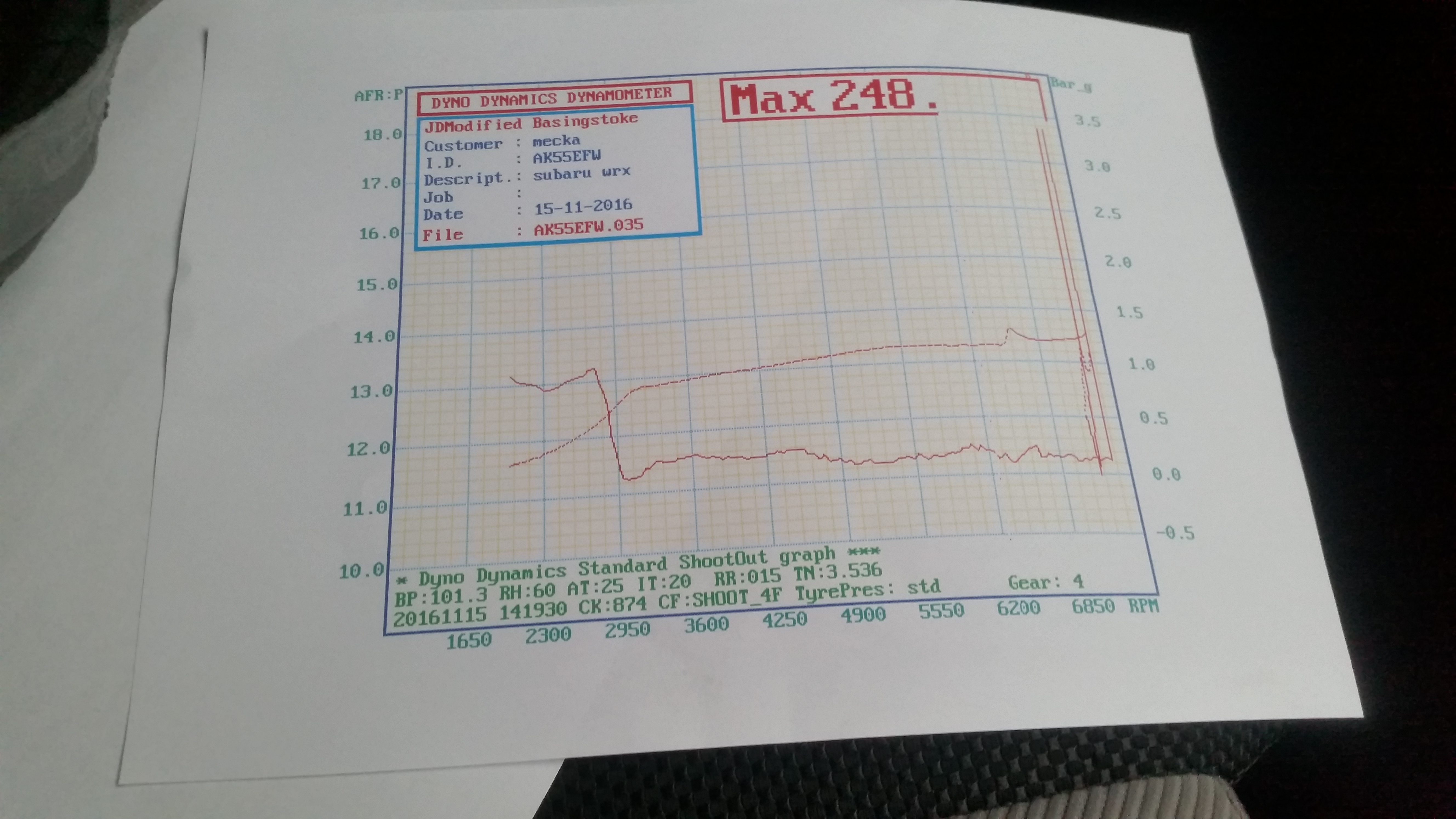

One figure is at the fly 294, one at the wheels 248. However looks like whoever ran it doesn't have a clue what they are doing so could be way out.
First off it should be in shoot_44 mode on the dyno, not 4f, also its been run in gear 4 where as a wrx 5 speed should be 3rd. (unless they put the info in wrong).
My advice, take it somewhere that knows how to operate a dyno properly and get it rerun.

Do you know who mapped it? Shouldn't look like a roller coaster and while fueling is ok the boost is doing strange things as well, typically it will peak then drop off up the rev range as it runs out of pull, not rise up the rev range.
Although ignore the fueling and spool (was when my engine was fooked), see how the turbo peaks then slowly drops off, thats what i would expect to see
What does the bp 101 at bottom of the graph relate too anyone know because I alway thought it was octain of fuel lol don't know why . Because on mine it says 98.3 and tidgys 98.4 but this one 101 quite a bit of difference :/
barometric pressure. affects the conversion factor of the dyno. Dyno measures power at the wheels then calculates back to give a fly wheel figure.
