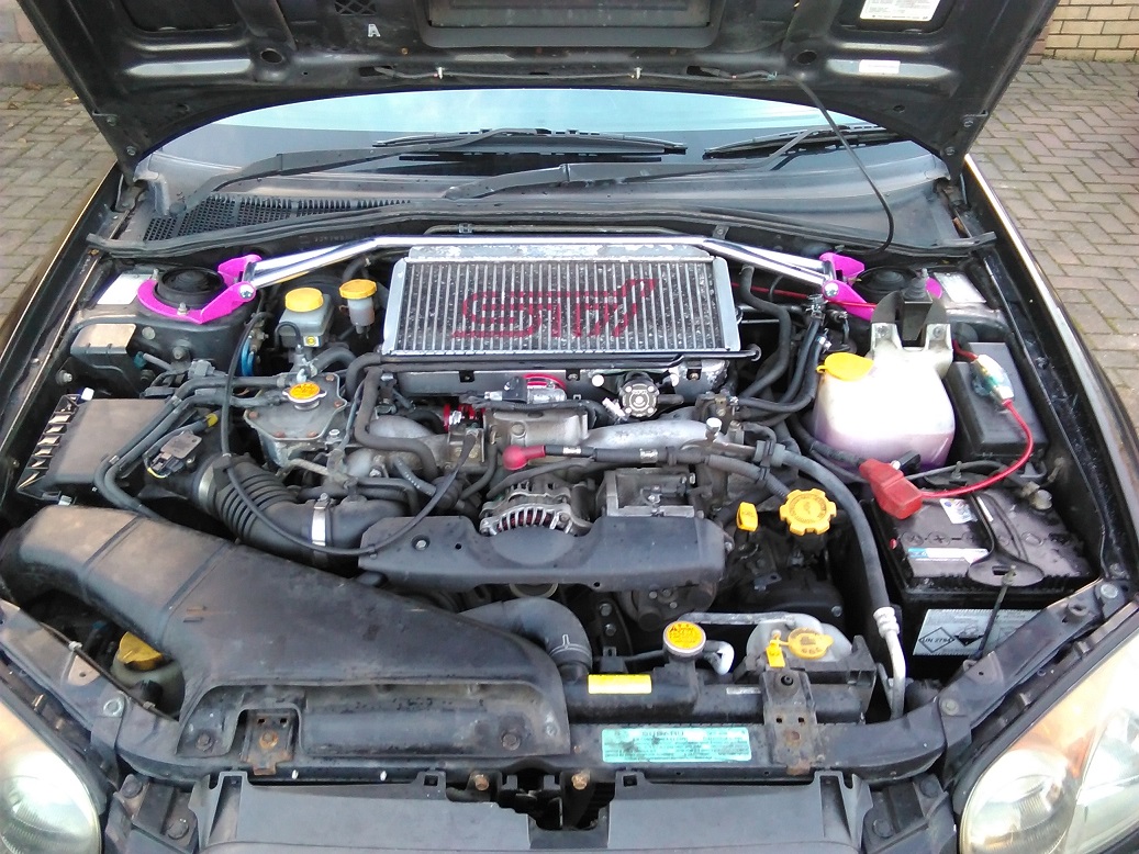

I have the gfb responce on my hatch fitted to my frontmount,if i have it fully vent to atmosphere then can feel the lag if you floor it,if i have it full recerc then i get the flutter noise from the turbo but car power is their straight away.on a top mount you wouldnt feel the diffrence as much as with frontmount lettin pressure out all that piping,i also had a gfb on a blob with top mount and car hated it just wouldnt run right so i went back to a oem sti recer valve with that and it made car 100% better.on the hatch i have it just open so its not very loud when venting and dont get back pressure and keeps enough pressure to stop lag.gfb is not a cheap blowoff valve but it is a good one just have to set it up to how car likes it and how you like the sound.

that is correct, in full reserc then their is no lag as don't have the valve releasing all the pressure each time I change gear,their is about 2 1/2 metre of 3"inch pipe with a front mount so you want to keep pressure up,you really want to keep pressure up with a top mount also,thats why oem are reserc and not vent to atmosphere.vent to atmosphere are just to give you the silly woosh noise,their is no performance gains from having it,dont see rally teams venting to atmosphere,a dump valve is basically a safety valve nothing more just to keep pressure right but people I think firstly in japan started fitting vent atmosphere for shows and then everyone wanted the noise,your car is the wrx-s don't they have the big sti intercooler fitted to them,if so I wouldn't bother with a front mount unless your going 400bhp plus,your intercooler is good for 350bhp I read,my wrx topmount interccoler are tiny crap things,mine was already fitted to car when I got it but I can tell you if you do decide to go front mount,either get custom made so can have piping as short as possible and also don't buy the perrin or other other priced intercoolers as the cheaper eBay 1's do the job just as good and cost quarter the price.

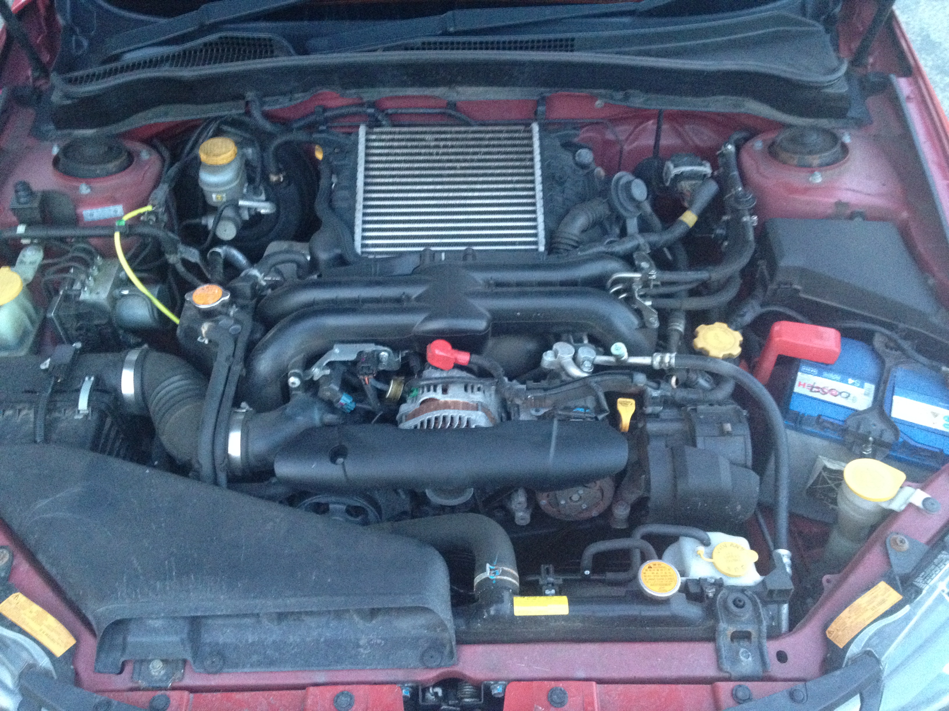

Unfortunately not, WRXS still has a crappy small top mount. I won't be going front mount route. Not anytime soon anyway. Not looking at that kind of power...yet 😜 If anything I quite like the look of the process west verticooler. Not sure if it's a bit of a gimmick or not though. Plus it's !Removed! expensive.

were all still learning things mate and am no expert on them either just stuff I have read like this https://en.wikipedia.org/wiki/Blowoff_valve  and stuff I have been told or even watched on you tube.good choice that as if I was going to change back to a top mount I was going to go with a verticooler but puts me off having to import from America,so my plan was I was going to fab my own design one up and even maybe sell them,grimmspeed do a good top mount for the wrx and wrx-s as well,i follow a guy on youtube with the verticooler on a 400bhp wrx hatch so their good coolers,but we will see what I do when weather gets better and I can get back out side and get fabbin again :wink:oh and I forgot to say on my last post yes I still have the maf fitted on my car.so you have a turbo that bolts straight to the intercooler then like mine,do you no what turbo it is?

IMG_1772.JPGKeep us posted on your fabrication activities then. Yeah my turbo is just bolted straight onto the inter cooler as far as I'm aware. I'm actually not to sure what turbo it is.  Been trying to find that out. Over in the states the 08 WRX runs a TD04 but got changed in 09 to a IHI VF52. Not 100% sure if that's the same in the UK. Pretty sure the WRX-S runs the same turbo as the standard WRX though. Not actually had a look at mine. Probably in spring when weather gets better. Might do the uppipe and downpipe. Not sure yet though. Anyone know if the hatchbacks have a carted uppipe? I hate that thought.

yeah that what I had read and my wrx has been upgraded to a vf52 so was wondering if it had come from a uk wrx-s or had been inported from states or something.those intercoolers are pretty crap,remember first time I removed my top mount I nearly pulled end off when I was wrestling it off throttle body hose,have to be fairly gentle with them.
