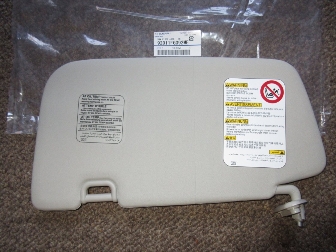

It comes as a complete assembly (as per photo), the part number is for Trim Code: G30,  Colour Code: C6P

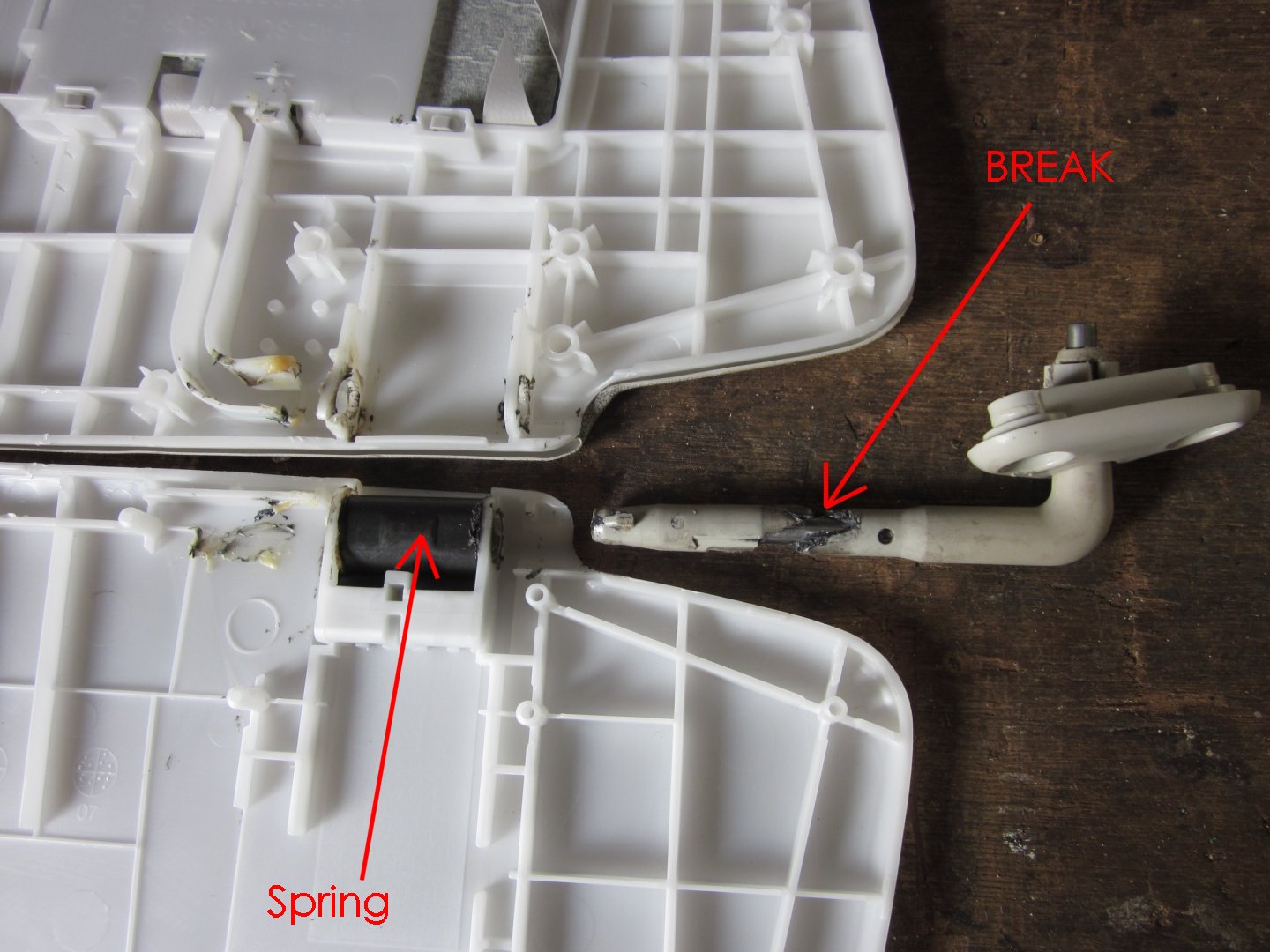

Once the plastic cam round the steel shaft has broken, it's history.  In my case it came apart leaving half of it inside - the only way in is to cut the plastic covering which would leave it looking like a taxi. :cool:
If you don't need the mirrors, the only difference between left and right is the spigot that attaches to the body - that broke too when I tried to get it apart.
