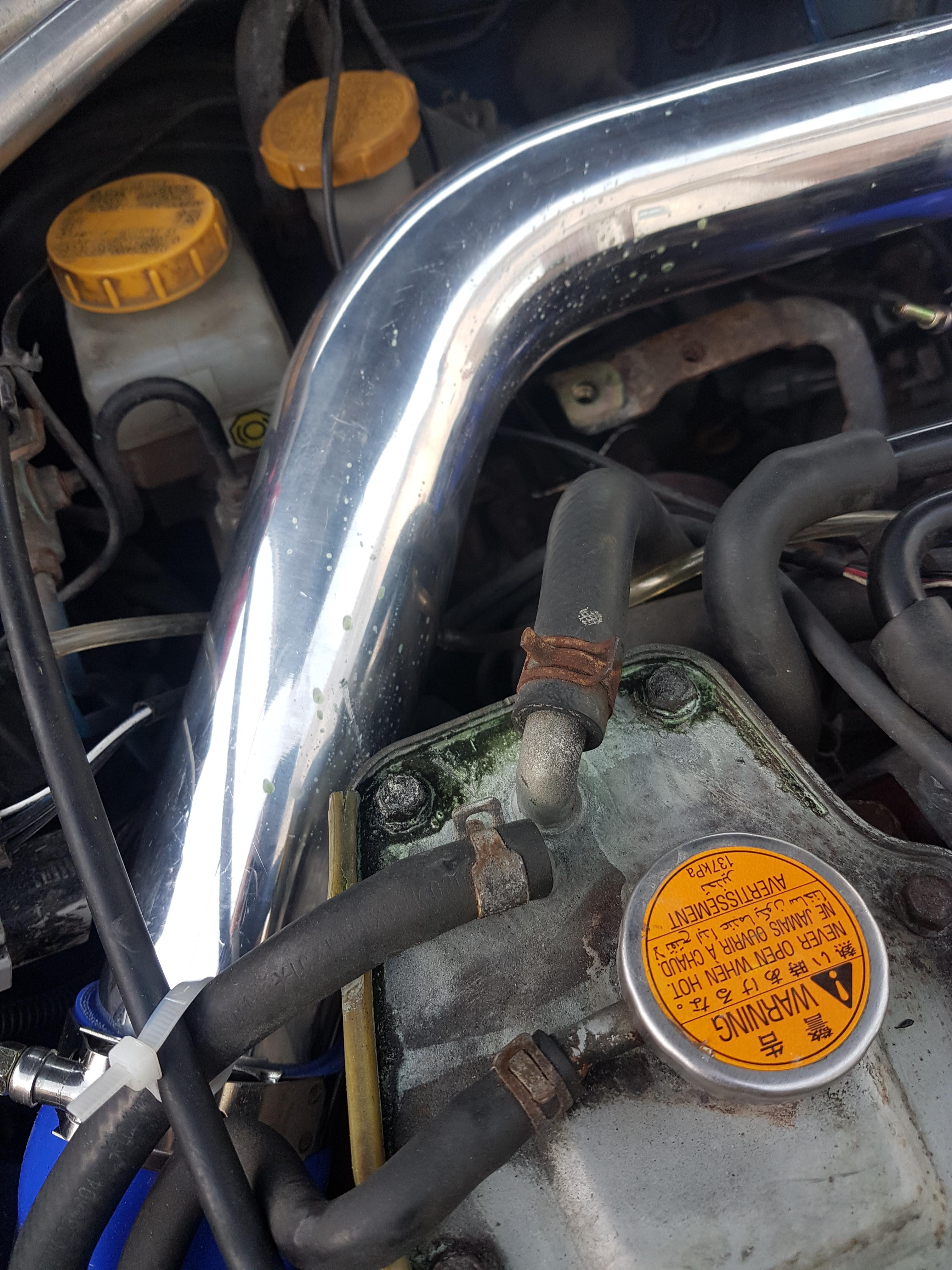

Also this header tank seems to have grown green stuff could this be related and it looks like its spat it up the new intercooler pipe
