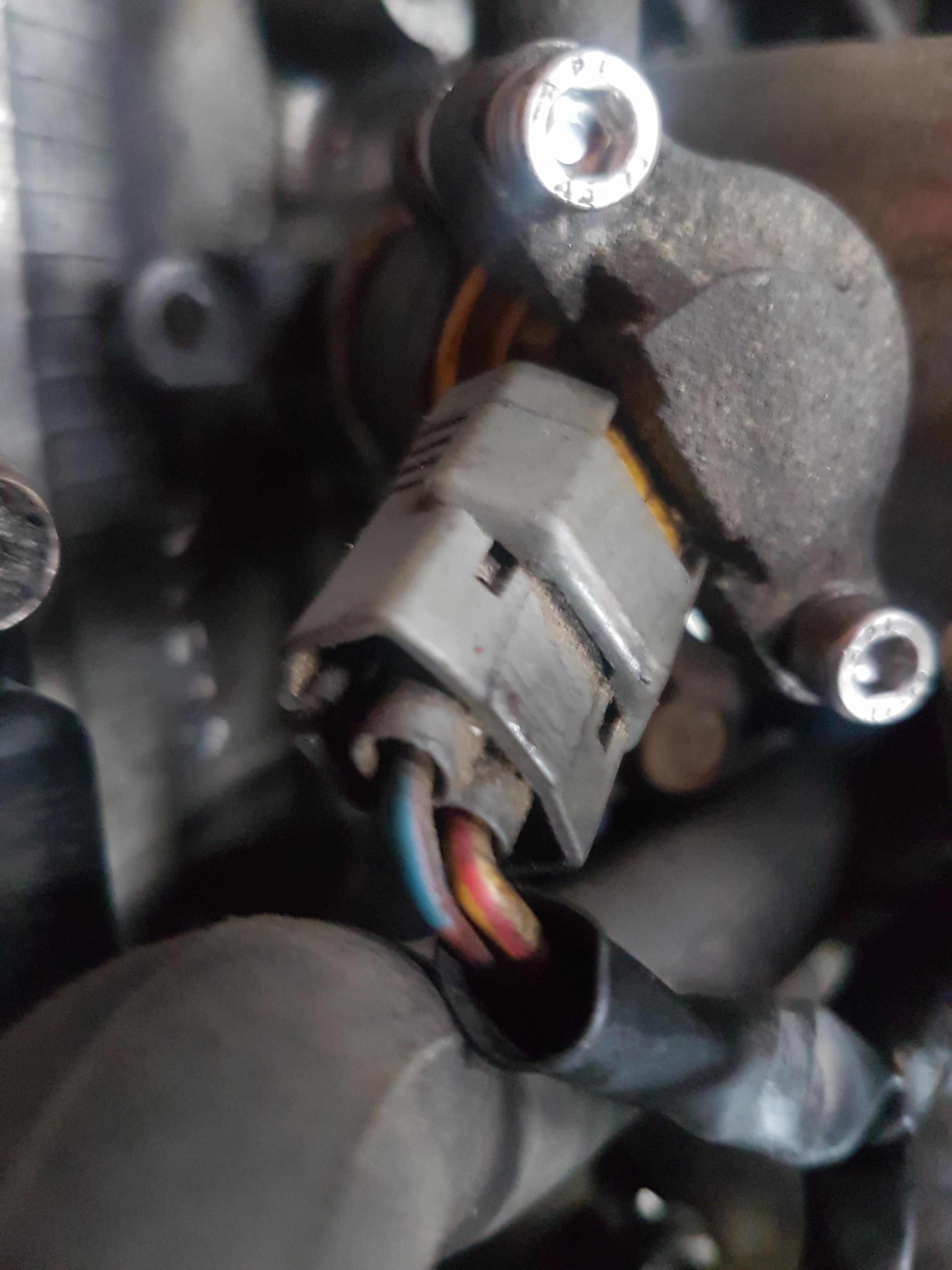

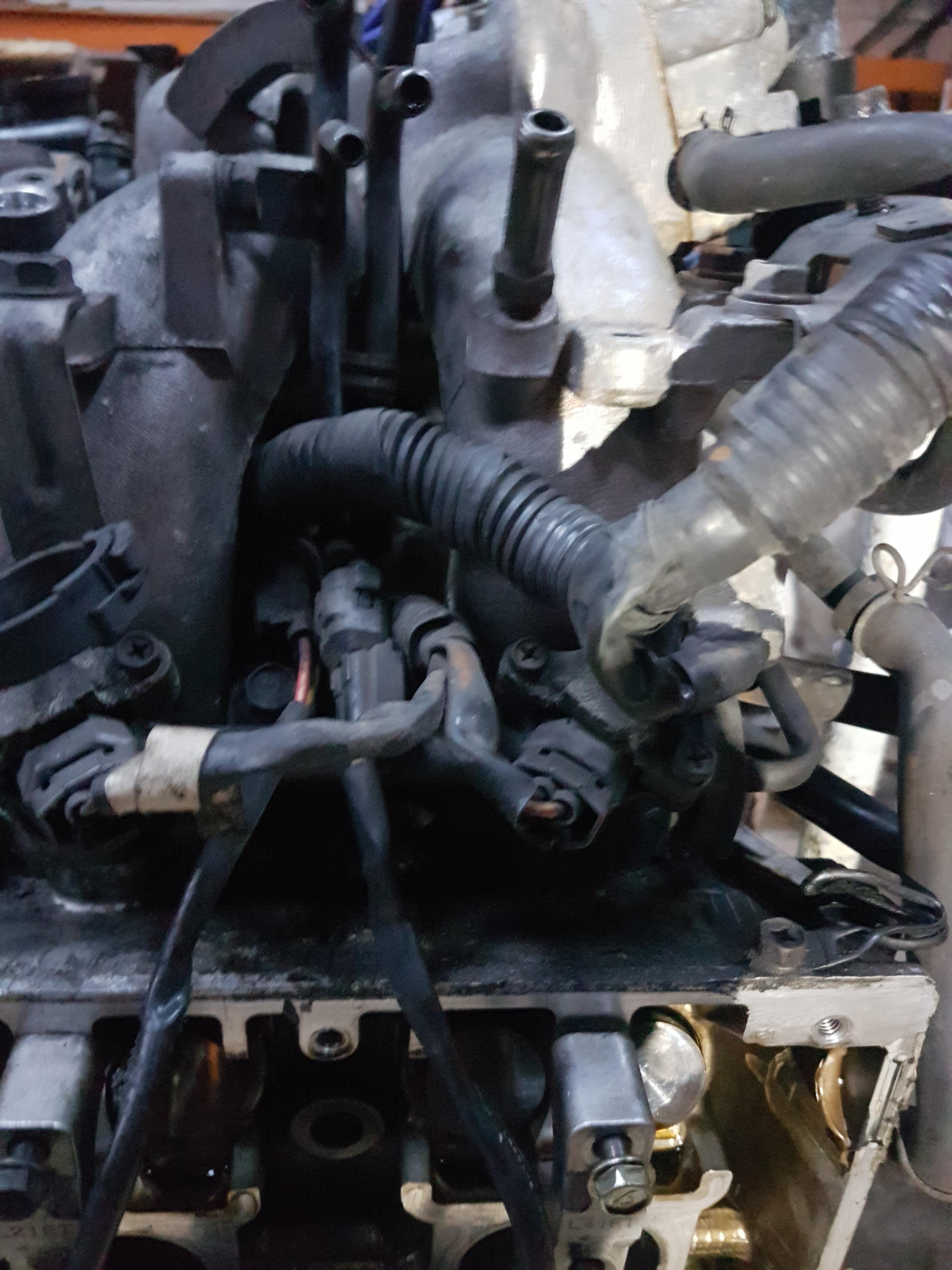

I currently have the engine out of my 1992 v1 wrx import and have just had the heads done and i'm putting it all back together as we speak, i take it with the injectors you are meaning the wire colours as on my engine all the injector plugs are grey however on the looms going to each injector the ones that go to the front injectors have a little white tag round them as you can see in the pic

yes mate mine are the same both grey but the wires on each plug have a different colour I have one plug out of all 4 with a label on saying f on it so I’m guessing that’s front so I put that in passenger side front which leaves the blue and yellow wire plug to the rear so I have put the blue and yellow plug opersit side in the rear to match and the brown and yellow in the front so guessing that will be right
Not sure to be honest because mine has the white tags on both sides so haven't payed attention to the wire colours but I'll take some pics of the wire colours and which injector they relate to tomorrow when back at work as thats where the engine is at the moment, thats if you can wait that long 😉👍

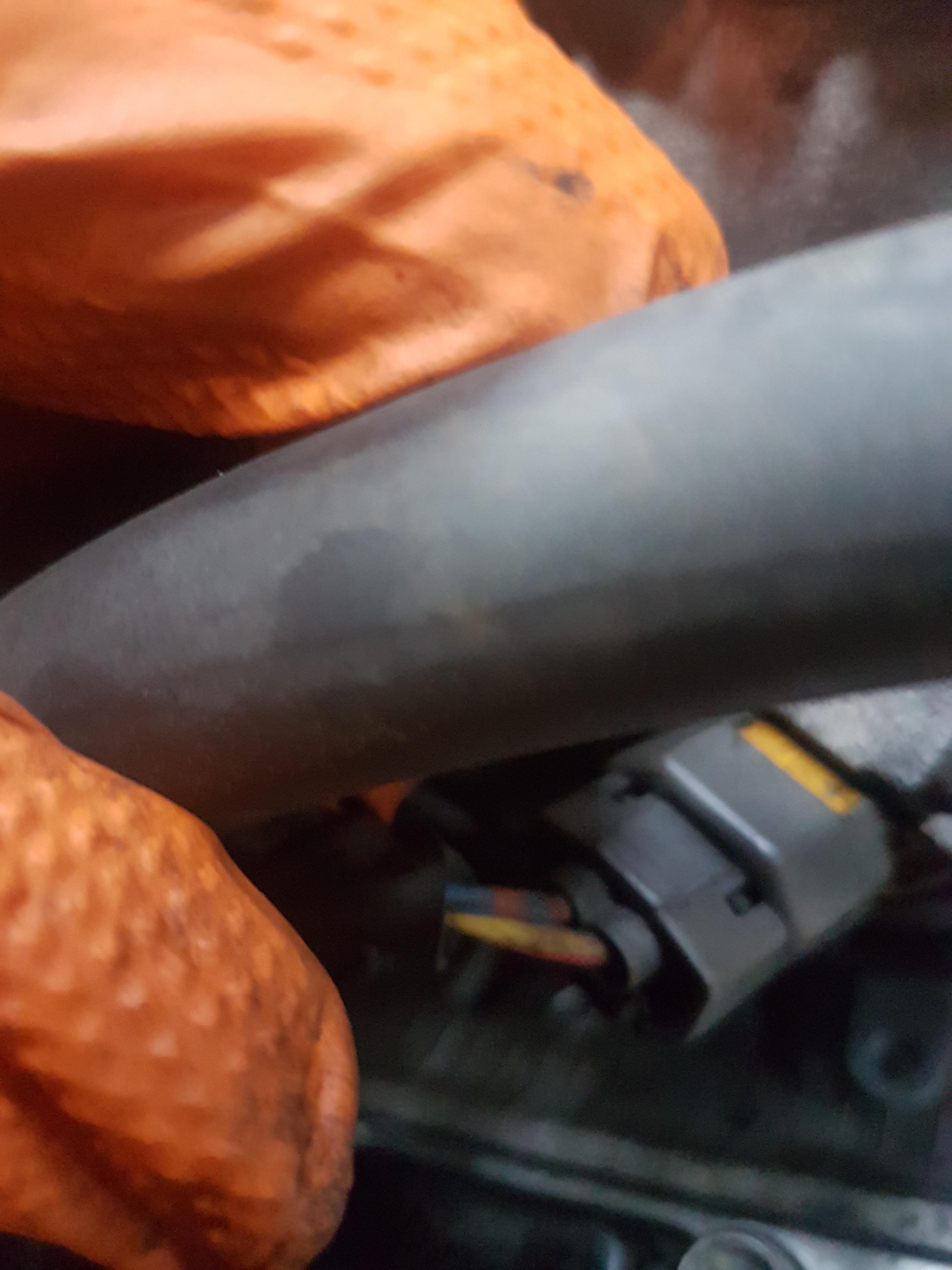

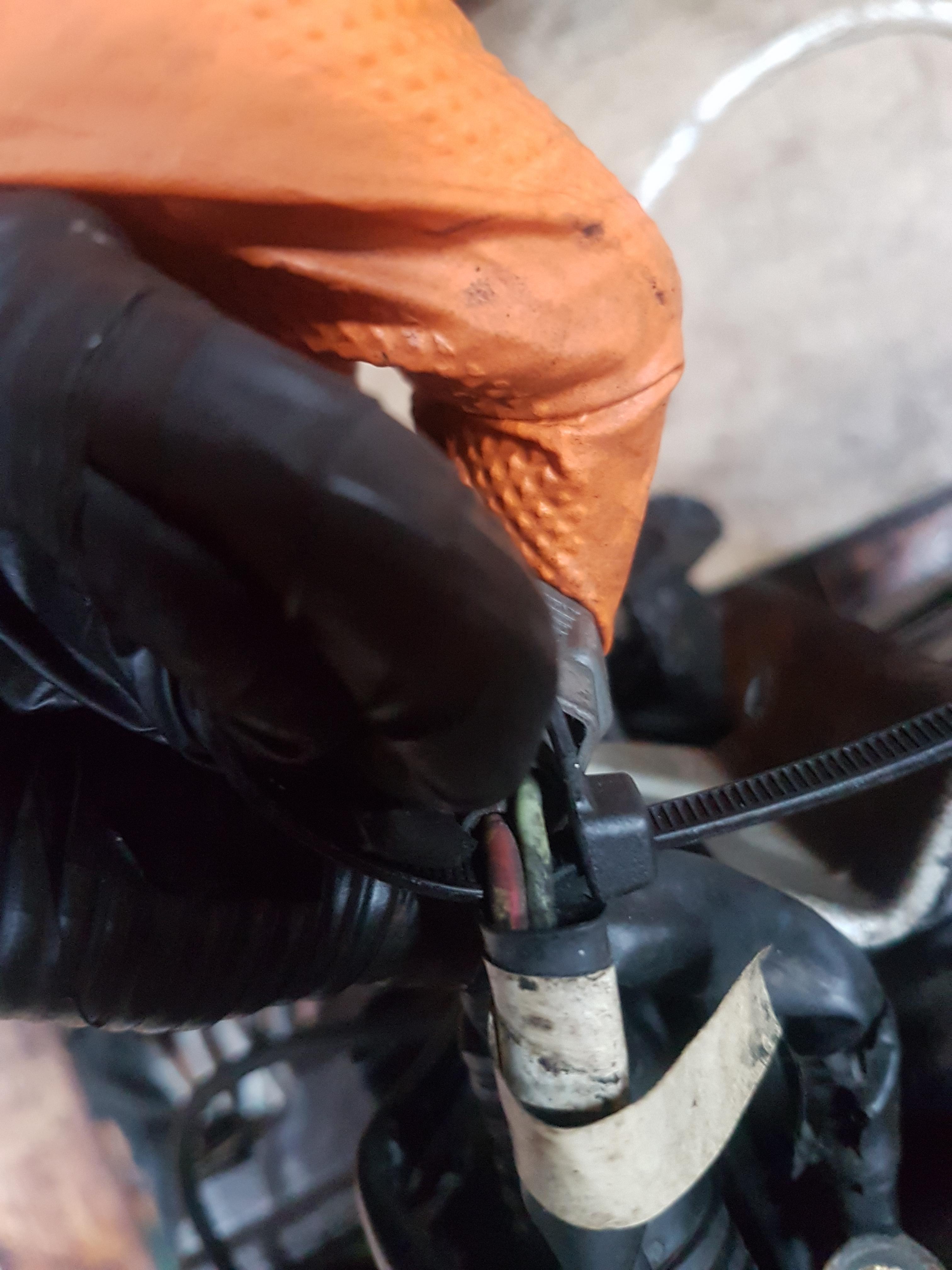

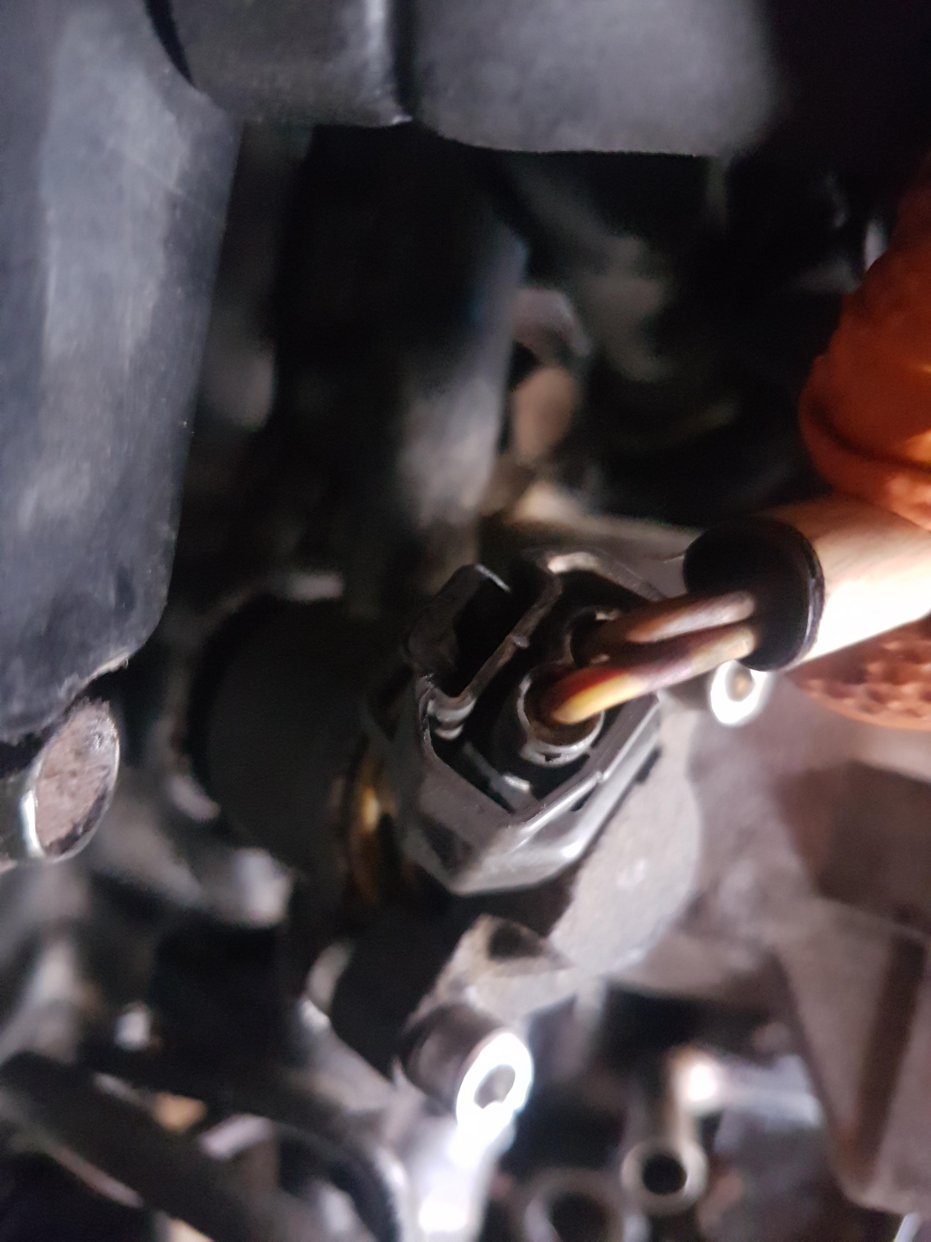

Here we go bud pics of the injector wiring, this is drivers side the one with the white tag is the front one
These are passenger side again white tag to the front injector
Hope this helps 😉👍
