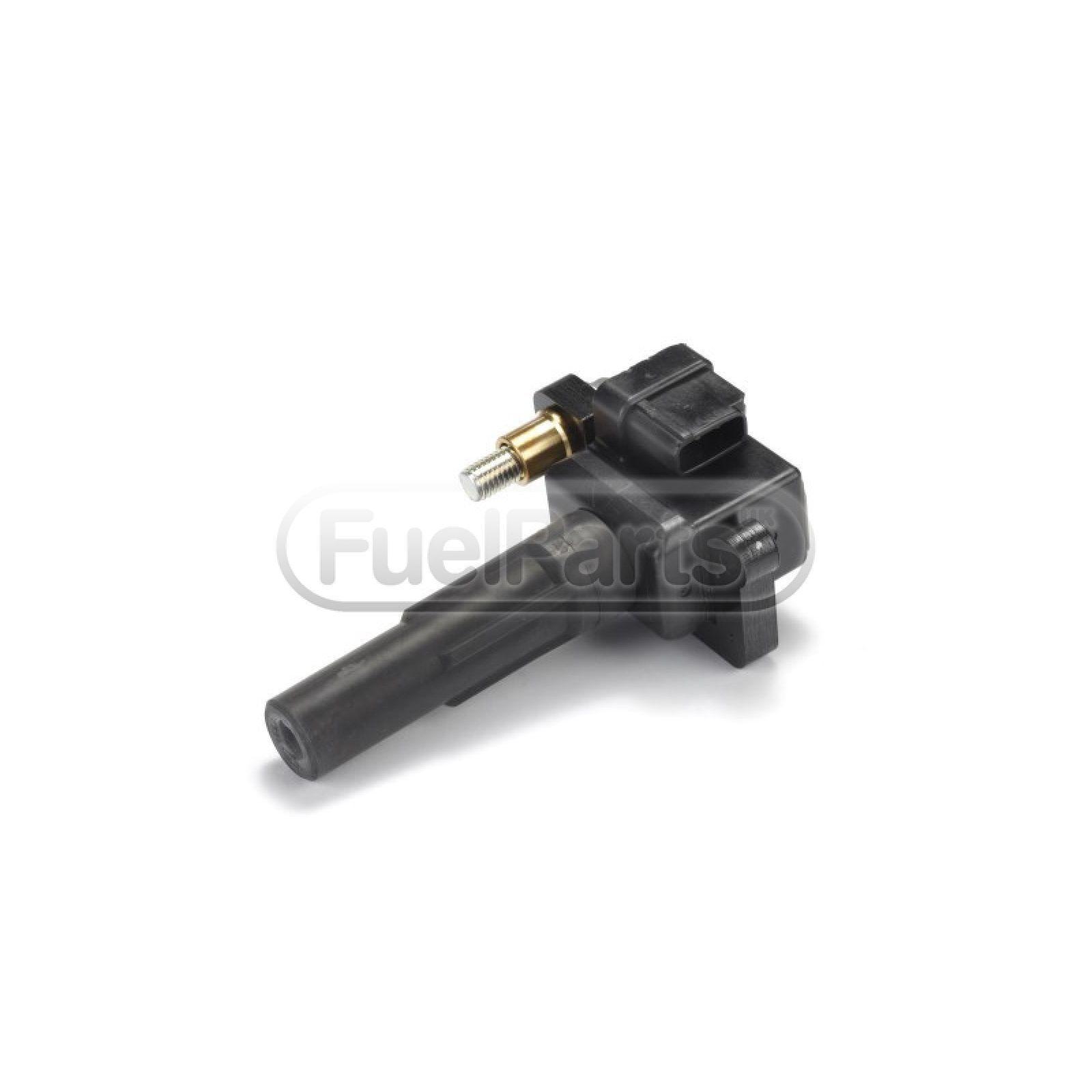

Hi,ive got a bugeye wrx,and occasionally its keeps throwing up eml light and losing slight power,and doesnt sound right, and engine is slightly shaking when on idle,had a fiddle with it,and it seems its a dodgy lead(ht?)  on no 1.(nearest to driver),if i wiggle it it goes back to normal,and its fine,it only does it randomly or is it the coil.So my question is new lead(s) or ?Dont want  to purchase items,that might not cure the problem,any help would be appreciated..Its the pencil type of coils i think,ive included a pic.its doing my head in! Thanks stu

I would think that its probably the coil thats at fault as that kind of coil in the pic is plugged in to the engine loom and the ignitor which provides the spark is built in to the top of the coilpack, its most likely to have cracked and is arcing out against the head and when you are disturbing it its maybe closing the crack until it vibrates and opens up again, you could always check all the wires going to that coil aswell as there's only 3 wires, hope you get to the bottom of ot and its not too expensive 😉👍

I'd suggest to swap the suspect coil pack to a different cylinder to see if the fault shifts along with the coilpack,  to see if it was coilpack  or pigtail plug (bit of wiring that plugs into the coilpack)
As stu said the most common fault is the insulation going brittle from the heat , cracking and allowing the spark to arch to the cam cover .
Saying that ,One of mine has the locking tab missing off the coilpack which was causing a intermittent misfire, due to the coil pack plug working loose if it wasn't pushed all the way on .

Are you sure it's not a coilpack plug issue , as I had a loose fitting plug that used to vibrate loose and cause the same symptoms.

I do still think it may be a coilpack plug issue,because when i wiggle one of them(not the actual plug)the wire joining the loom the engine sounds normal and there was no shaking of the engine,but i had a look at the wires and they look good to me,but im far from an expert..Just off topic mate,sorry to hear about you shunt,glad you got it all sorted and you and you kids are ok..
Finally got to the bottom of it,it was a broken wire in the  loom,so my service guy at work is going to do it and some new conduit...So simple ,typical...Roll on tomorrow evening,so i can finally unleash the power and burble!

Im afraid it wasnt mate,wires are all fine,its the plug(connectors)there not sitting properly on the coil pack,and the stupid clip bit is crap to put it bluntly..Have found uprated new plugs etc in usa,but can i get anything better or same in uk?Other than that any sugguestions???Cheers
One of my coilpacks has the locking tab missing and used to vibrate loose, I just put a bit of insulation tape on the coilpack where the plug goes then put the plug on .
Bit redneck but it made the plug fit tighter and I did 910 miles to Cornwall and back last year without issues (so it worked)
I wouldn't think your issue is with the coilpack , due to it being brand new and Probably more likely to be a issue with the loom plug itself .
I doubt uprated coilpacks would make any difference as the outer casing (where the plug connects) would probably be the same shape in order to fit the oe Subaru loom plug .
I'd try to make the plug fit better by using my redneck option and check the pins in the plug are solid (not wobbly) , the rubber insulation around the plug pins is intact and the pins are free from corrosion (making a constant good connection) .

Cheers clive...Yep its exactly what you said,its the tabs on the plugs...the uprated or better quality are from the usa but out of stock at the minute,so my mechanic is going to come round and
do a redneck job in the next couple of days..Pins are fine no corrosion..I'll let you know what happens..Im not to far from you..Thanks for the offer:thumbsup:
I had the same problem with the uprated coilpack i just fitted to my classic and i used a couple of little cable ties to hold the plug securely onto the coil, i know its a bit of a jungle repair but it seems to be holding 😉👍
