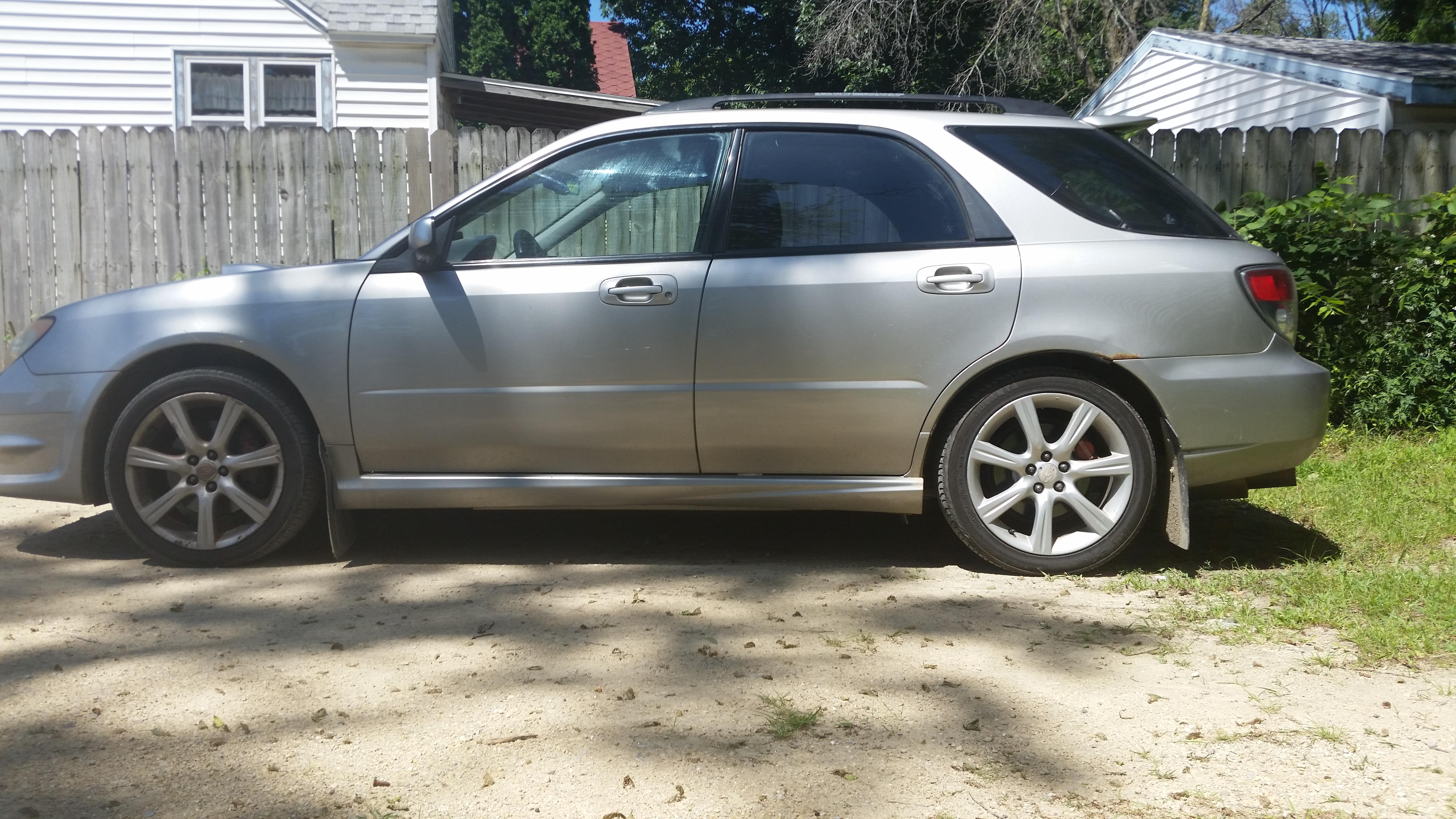

Best car I've ever owned. I've had faster cars, but none of them were also fun to drive in rain & snow. 360k from the original engine. New engine makes 360 hp and 420 lbs torque. It's a sleeper. Buries the speedo in about 14 seconds.
Got about 10k to invest. Needs a better suspension. Suggestions?

Engine is already warmed up a little. K&N cold air kit, ETS turbo, stage 2 Cobb tuning kit, HKS exhaust w/ 4" pipe & racing muffler. That's good enough. Handling is a little rough. Original factory struts are shot. Hit a bump in a turn and the rear end kicks out. The plan is to replace/upgrade every suspension & steering component.
