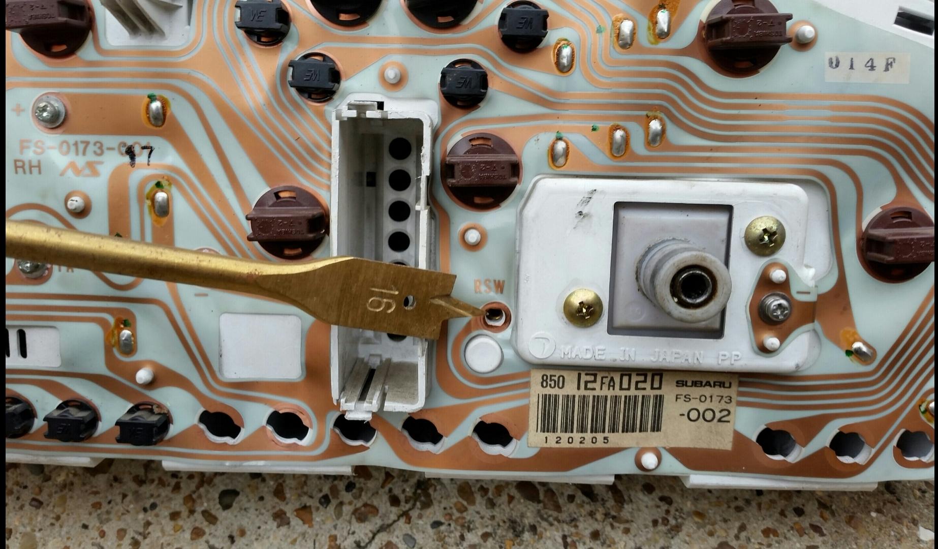

Think being a v2 it would have the mechanical speedo drive ?
If so are your clocks showing the right speed and working smoothly?
I had a no ECU speed reading on my v1sti but it's running apexi f.c ,so didn't matter until I tried to get my avcr gear judge function working.
It took me a while to find out why but it was because someone had removed this screw on the back of the clocks .
Once I refitted the screw the speed reading returned to the apexi ECU.
Yeah mine is mechanical I have taken all of that apart cleaned with electrical contact cleaner hopefully it will work being mechanical will I have a sensor on the gearbox or is just the cable that spins?
If yours has a speedo cable (mechanical speedo drive) I think, the mechanical to electrical speed sensor converter is in the back of the clocks . As there is no other wires attached to the box in that area and v3 onwards have a electrical speedo drive,(just wires from the speedo drive to clocks  , no cable)
I assume someone removed the screw in my clocks ,maybe to "de limit" or fit something else aftermarket,  that needed a speed reading .
Does the speedo read ok ?
If so it's probably more likely to be a fault /issue where the cable plugs into the clocks or the printed circuit near it

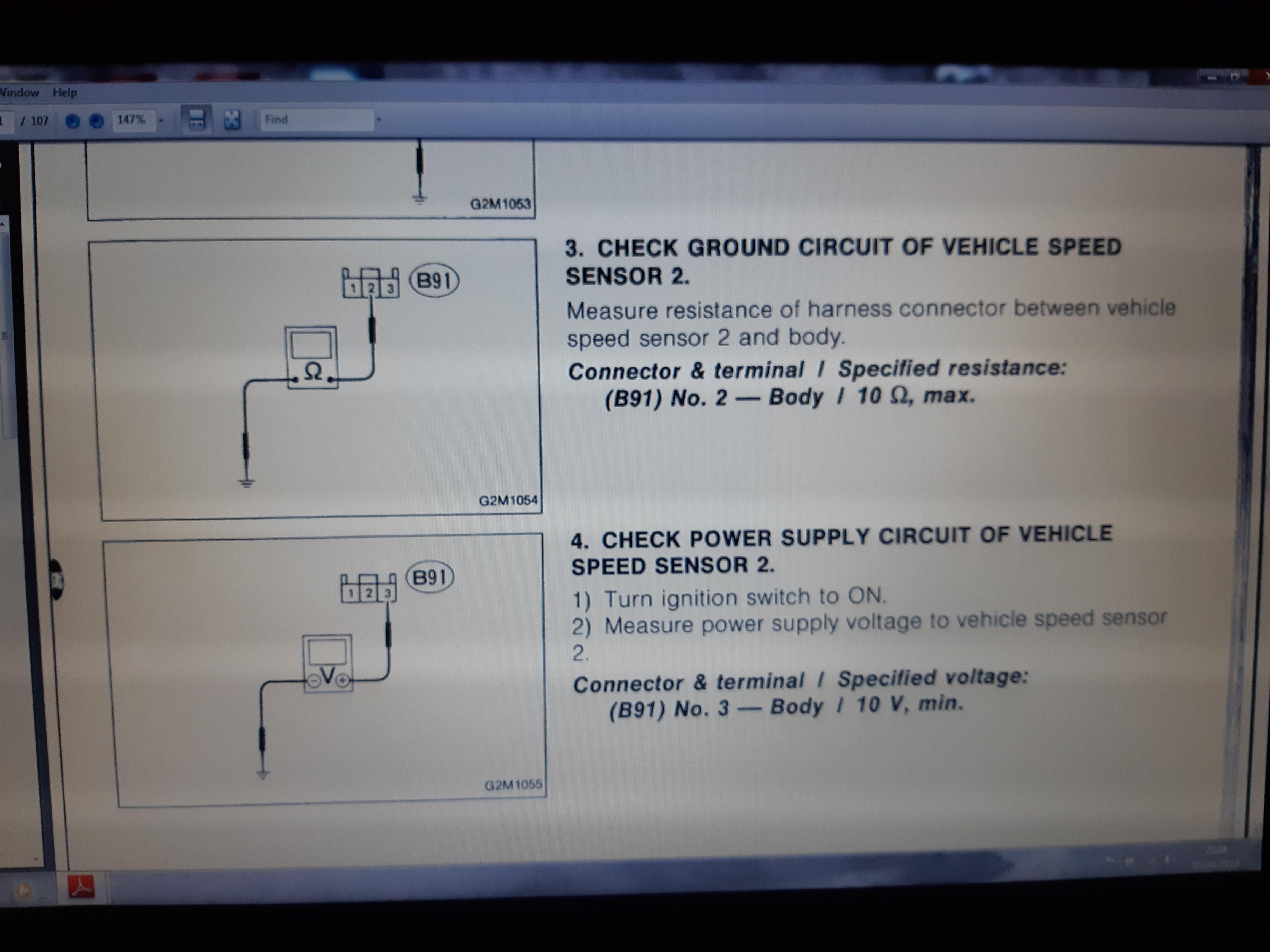

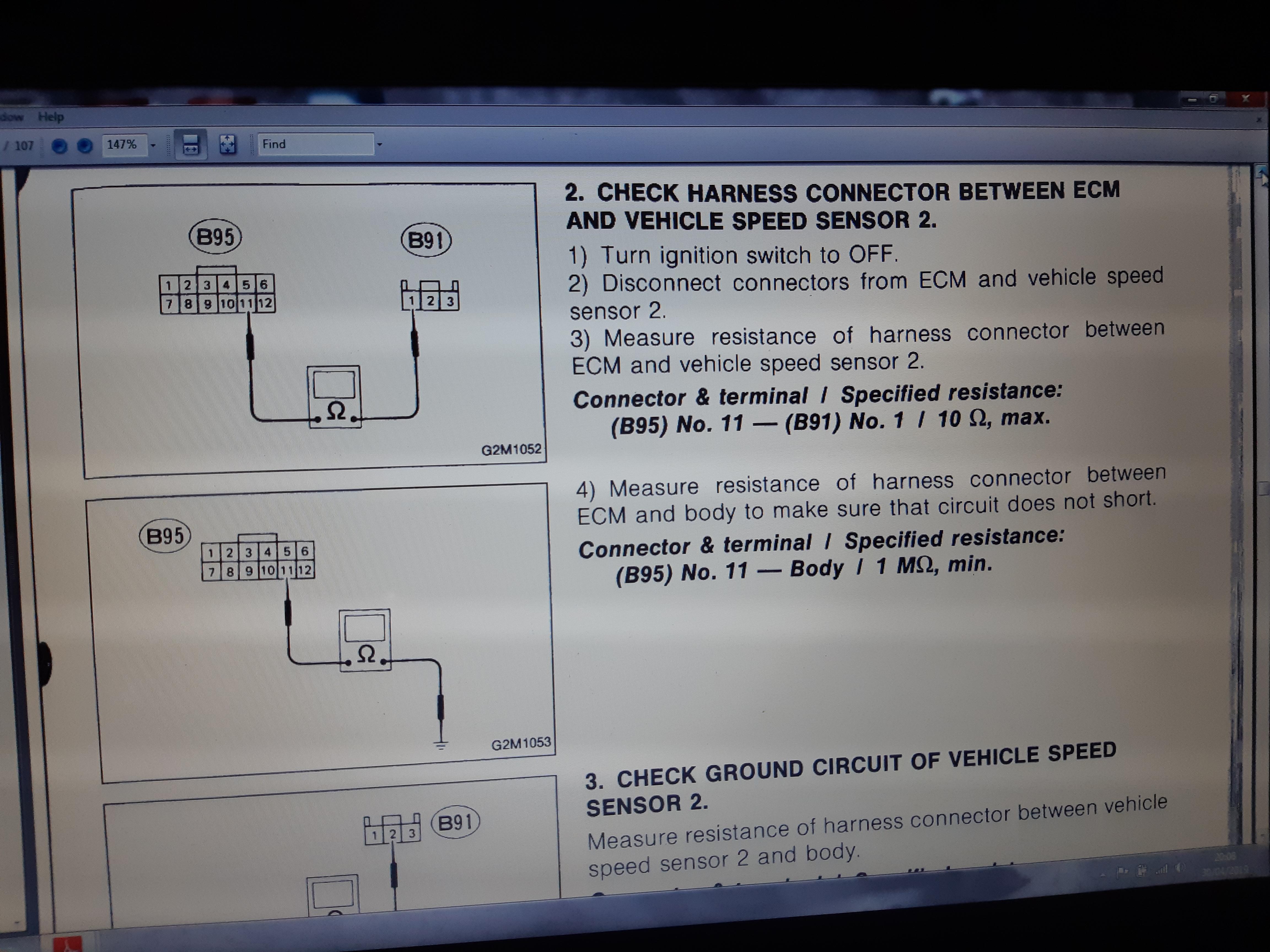

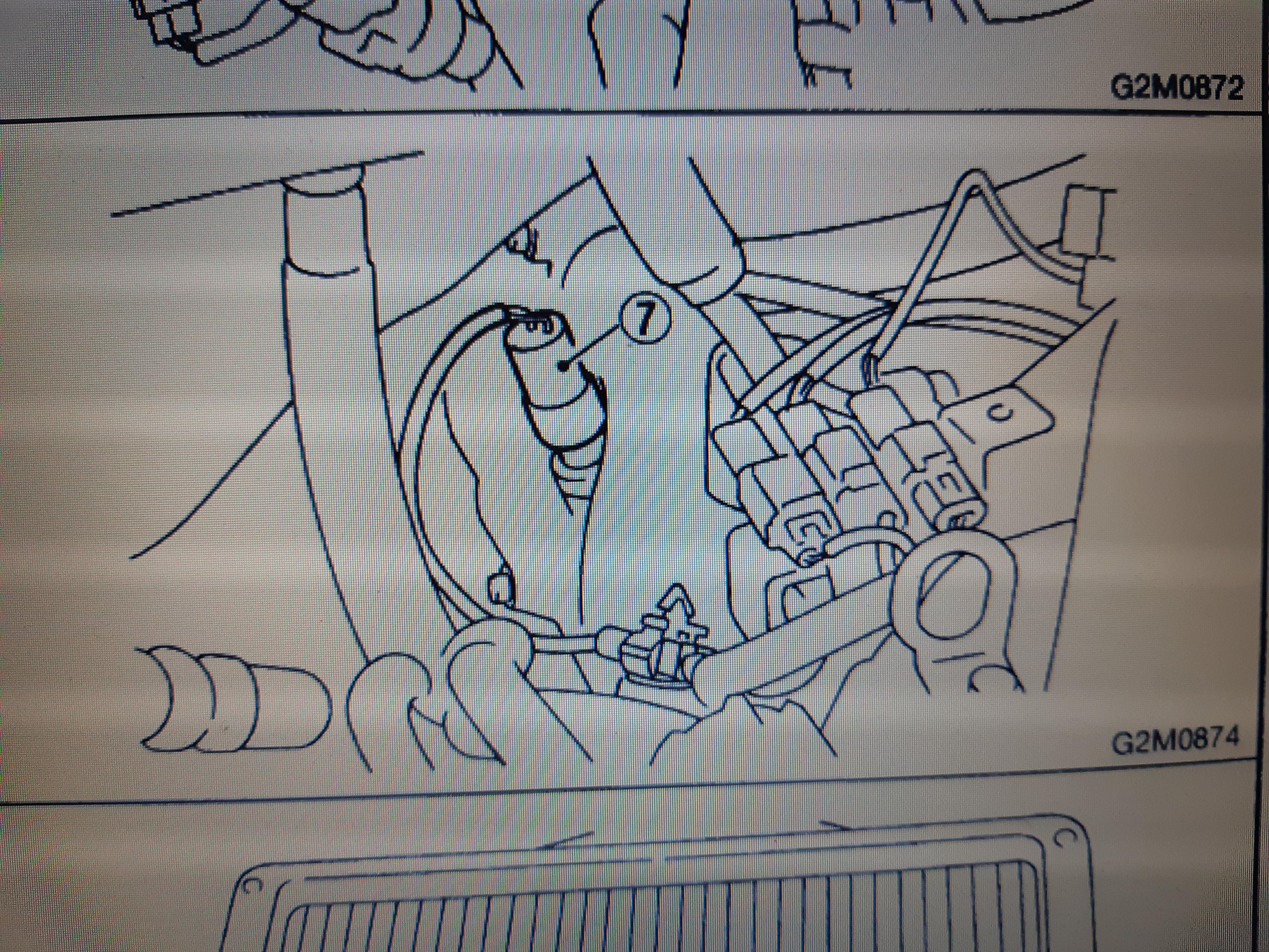

Had a squint at the service manual and it mentions a "speed sensor (2)"   I'm not sure if this means there's 2 types (cable and electrical) or that's there's 2 sensors tbh .
It shows it near the brake servo (could be either side of the bulkhead ) theres a pic with a number 7 pointing at the part below.

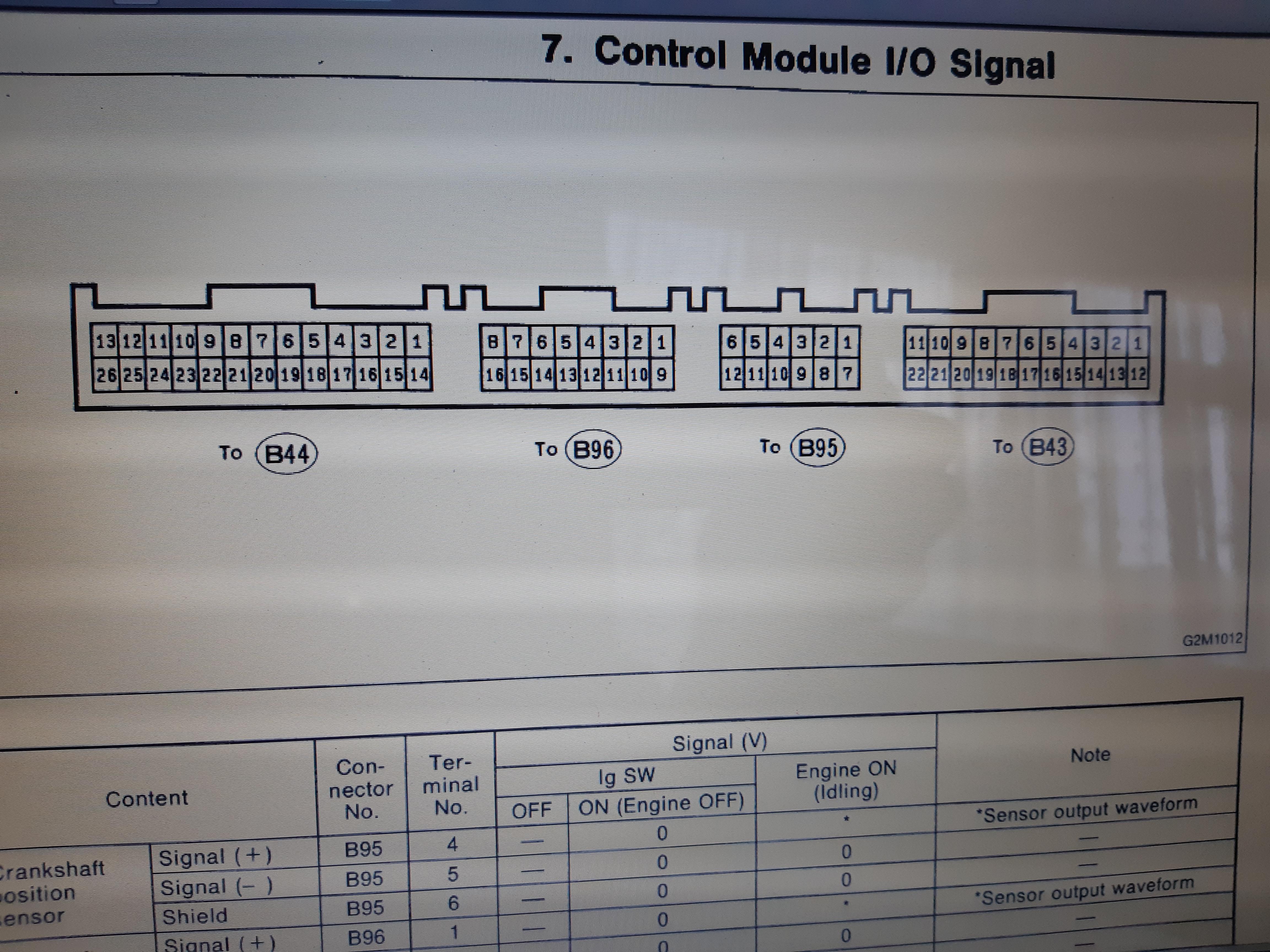

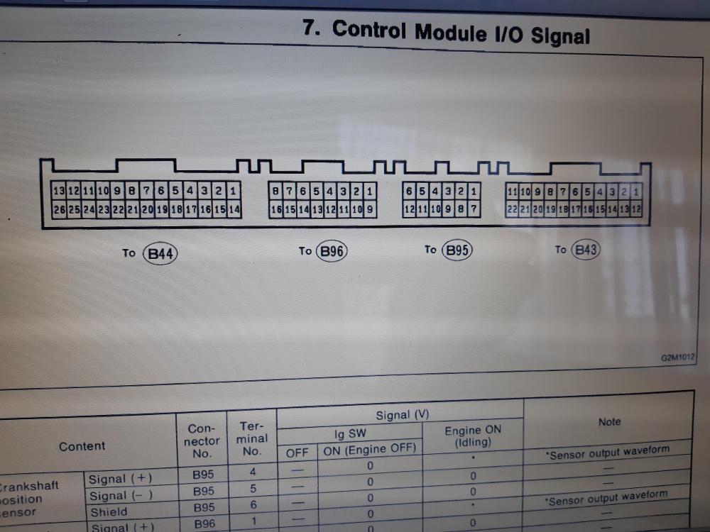

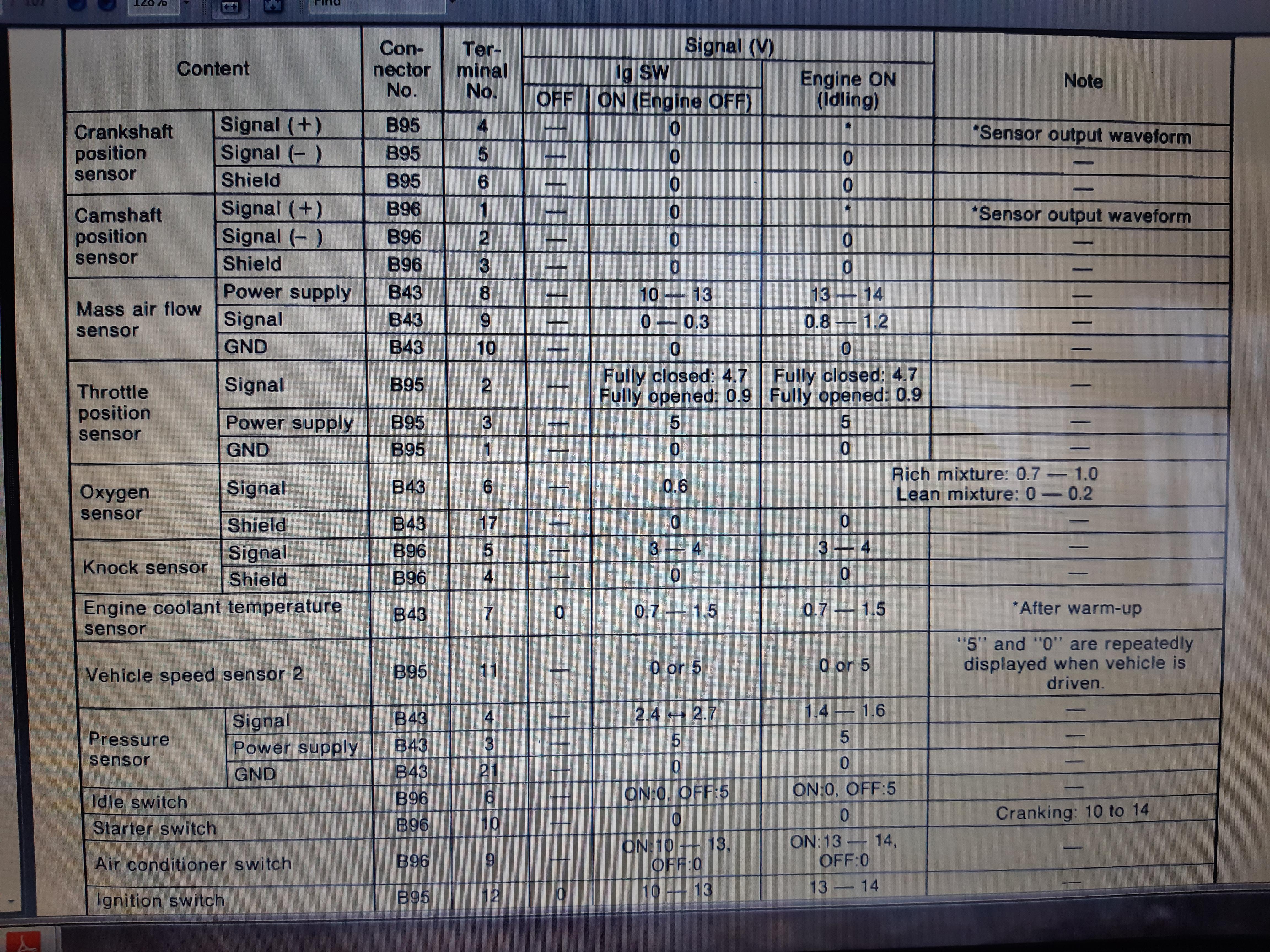

The sensor itself needs a oscilloscope to check while running with all 4 wheel off the ground but theres a ECU pin plug list and pic . This is taked from looking at the wires with the ECU harness plugs plugged into the ECU  😉.
And a pin voltage /resistance check for the ECU/speed sensor harness. Pics will probably post in the wrong order , so hope you can make sense of it lol.
Best of luck with it , chap 👍
