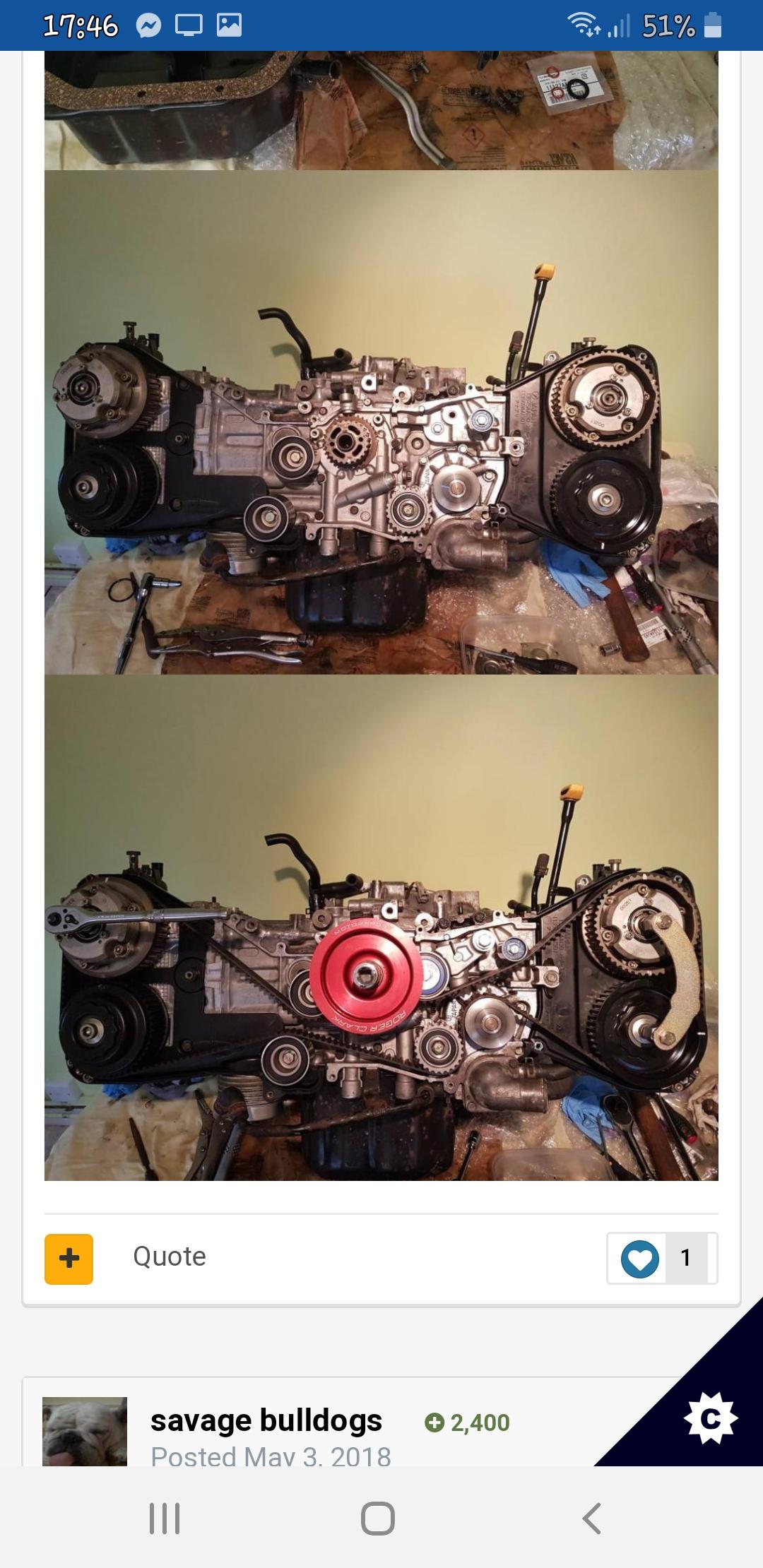

Here's a pic of my ej207 single avcs engine with cam lock in place and water pump fitted , you can see the cam pulleys aren't close enough to be in the way of water pump removal .
I can't say 100% for the 2.5 but cam pulley removal is definitely not needed on the ej20g, ej20k,ej205 and ej207 .

Cheers. I will check the manual for the 2 litre see if that's reckons you require removing the sprockets. If it does I guess it must be an error based on your info.
It does seem as if there would be room to clear the pump.
The manual for the 2 liter also states you have to remove the sprockets. I guess you can get the pump in but is made easier if you remove the sprockets to remove the plastic cover.

No need take cam sprockets off . back plate not in way .
