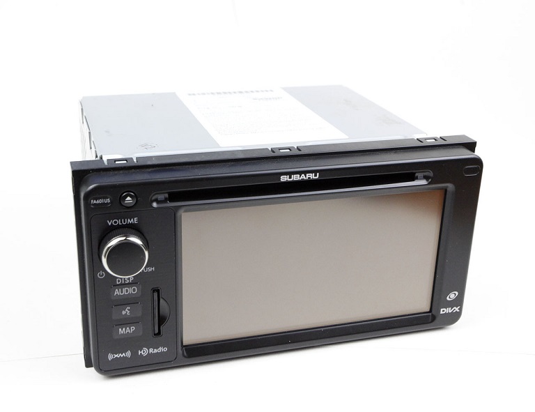

ade Posted July 6, 2019 Posted July 6, 2019 Has anyone had any success in upgrading the head unit in their XV's? If so where did you get a harness to connect the two together from? I bought a Kenwood last week, with a harness kit which when I've opened up the dash, removed the old Stereo unit and tried to connect it up doesn't fit, there are several connectors not there on the new harness. I'd tried getting my Subaru dealer to price me up an upgrade but they still haven't done it, has taken them three weeks to let me know when the recall kit will be in for the other outstanding work Thanks in advance Ade

ade Posted July 20, 2019 Author Posted July 20, 2019 7 hours ago, ernieb said: @Ade, Sounds more like they got you the wrong cable, I feel for you. Maybe try and photograph the cables you have to help the company who supplied the harness identify a correct version? I took a photo in and the guy went through his database of cables available for the XV and none of them look like it, I've attached a pic below showing all of the cables which attach to the back of the Stereo circled in Red.. I'll give them a call on Tuesday and see what they suggest next other than they fit it for me, tbh at the moment I'm even tempted to do that.

ade Posted August 9, 2019 Author Posted August 9, 2019 So finally it is in and 80% working, they described the car as a Bitsa, as it has bits of this and bits of that in the wiring loom. They have done several XV's and other Subaru's and never had the problems they have faced with this one. They ended up taking parts of wiring harnesses from different makes to get all of the steering wheel connections to work. The bit that doesn't work is the reversing camera, apparently the original camera will not work with any aftermarket Stereo, which I find hard to believe so will do some other research. Looking at the receipt the bits I needed on top of the Stereo were as follows: 29-709 Subaru SWC C2 CT-27AA78 Toyota 2009 Aerial Adaptor CT SSU002-2 C2 CT-Multilead Universal Patch lead ICT 70-923 DAB +3db Windscreen Mount I think they also provided a Toyota Facia surround which they don't appear to have charged me for. 1
