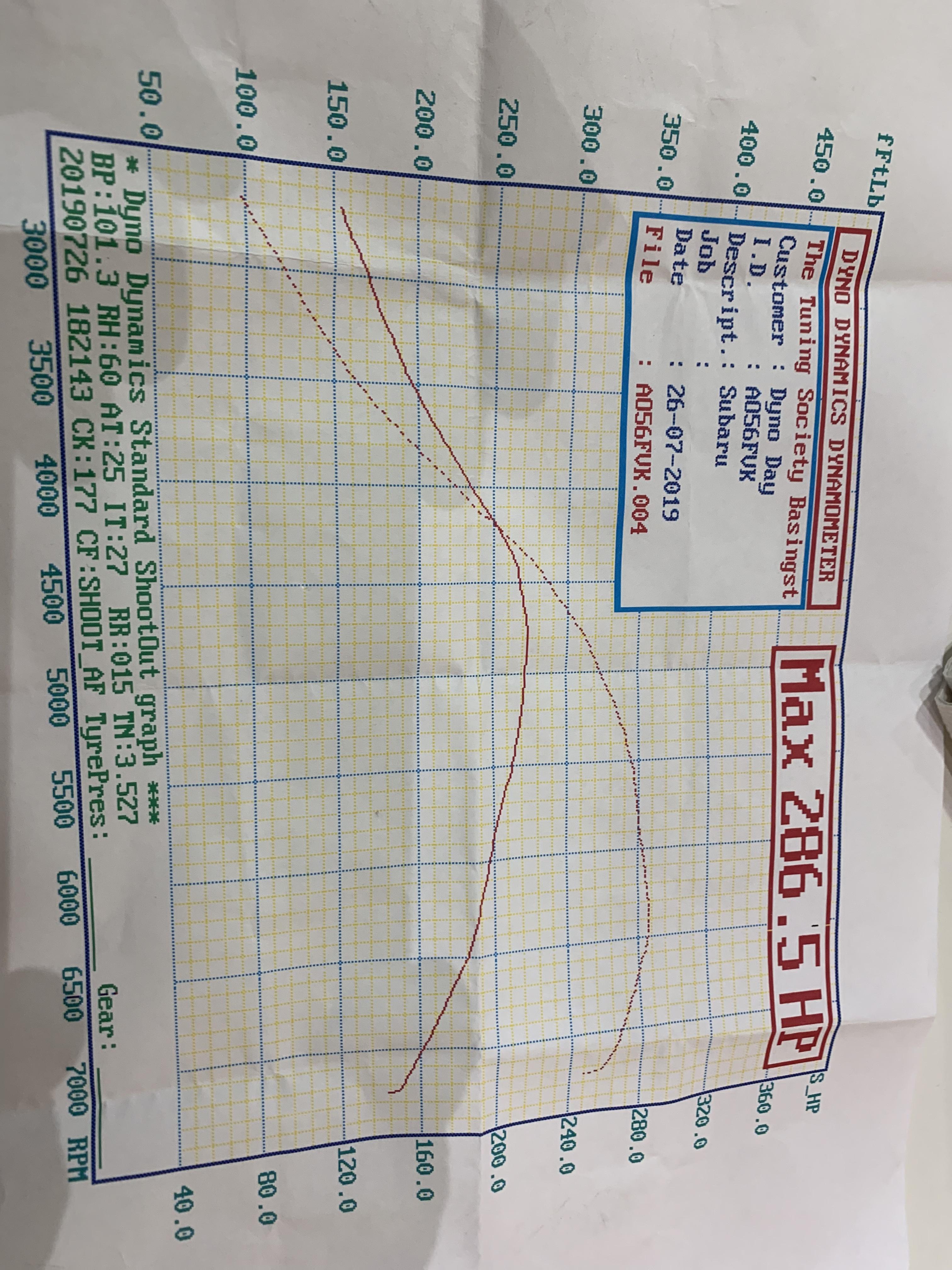

All i can tell you my 2007 wrx made 267bhp with 335ft lb. Car is completely standard except back box and panel filter. How many miles, any mods, 2 or 2.5 liter? There is a post full of maps on this forum so you can compare. What is PPP STI supposed to do? Does not look too bad if totally standard but i am no expert by any means.
It’s a wrx 2.5 sti  prodrive supposed to be running 316bhp from new that is . Done 86k miles . Obv it’s lost a few horses since new . Also noticed on way hone is hesitating from 4000 rpm so can’t be a good sign lol . The bloke was saying it’s a very slow pickup and should not be like that .

Unless im mistaken the dyno is in the wrong mode, Should be in shoot_44, also looks like the gear ratio is set different to my old wrx.
'Shoot_44 Four cylinder 4WD passenger cars eg Subaru WRX'
'3.536'
Im not sure what 'shoot_AF' actually is.
Do you know what gear it was in when they ran it?
