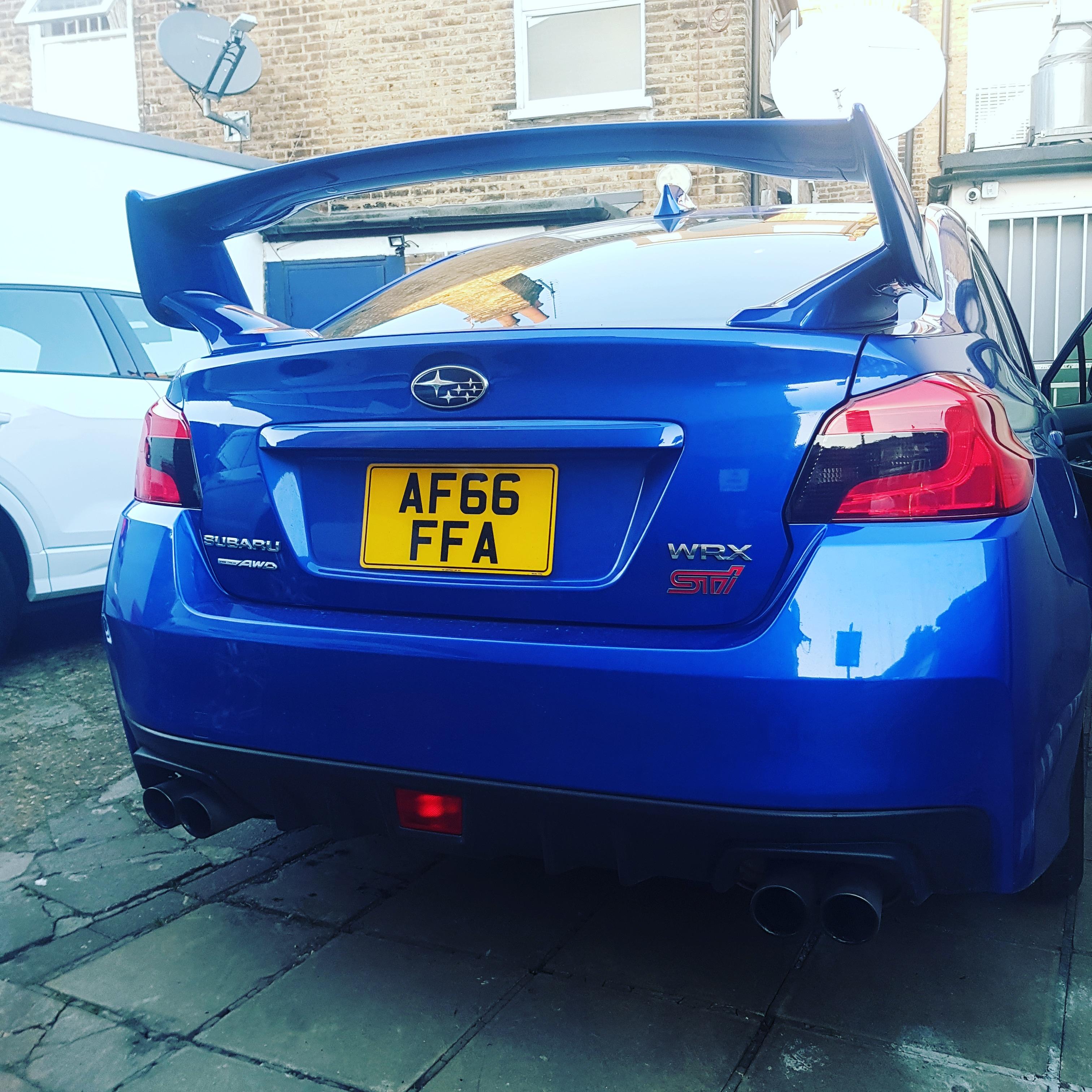

Hi Everyone im Chi im based in the South east area London. I recently purchased the Subaru Wrx Sti 2016 model and i have to say im really excited about the future mods i have for this car.  Im pretty new to Subaru really need some good advice about maintaining and mods to achieve the 400hp mark without needing to rebuild.
