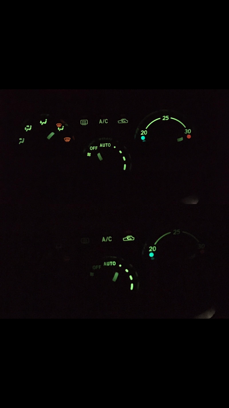

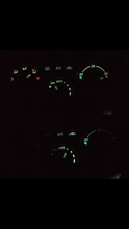

The centre console does light up very when the lights are on but very dim it has now headlamp on like I have had in my other cars is this normal
The boot leak I will follow your points above ,
Cheers
Should come on when lights are switched to sidelight or dipped or mains.
attached it the brightness of mine after replacing the bulbs, I have literally just had to do this as 2 out of the 4 bulbs went at the same time.
Yours will differ from mine as I have pre facelift centre console.
gives you an idea though.
