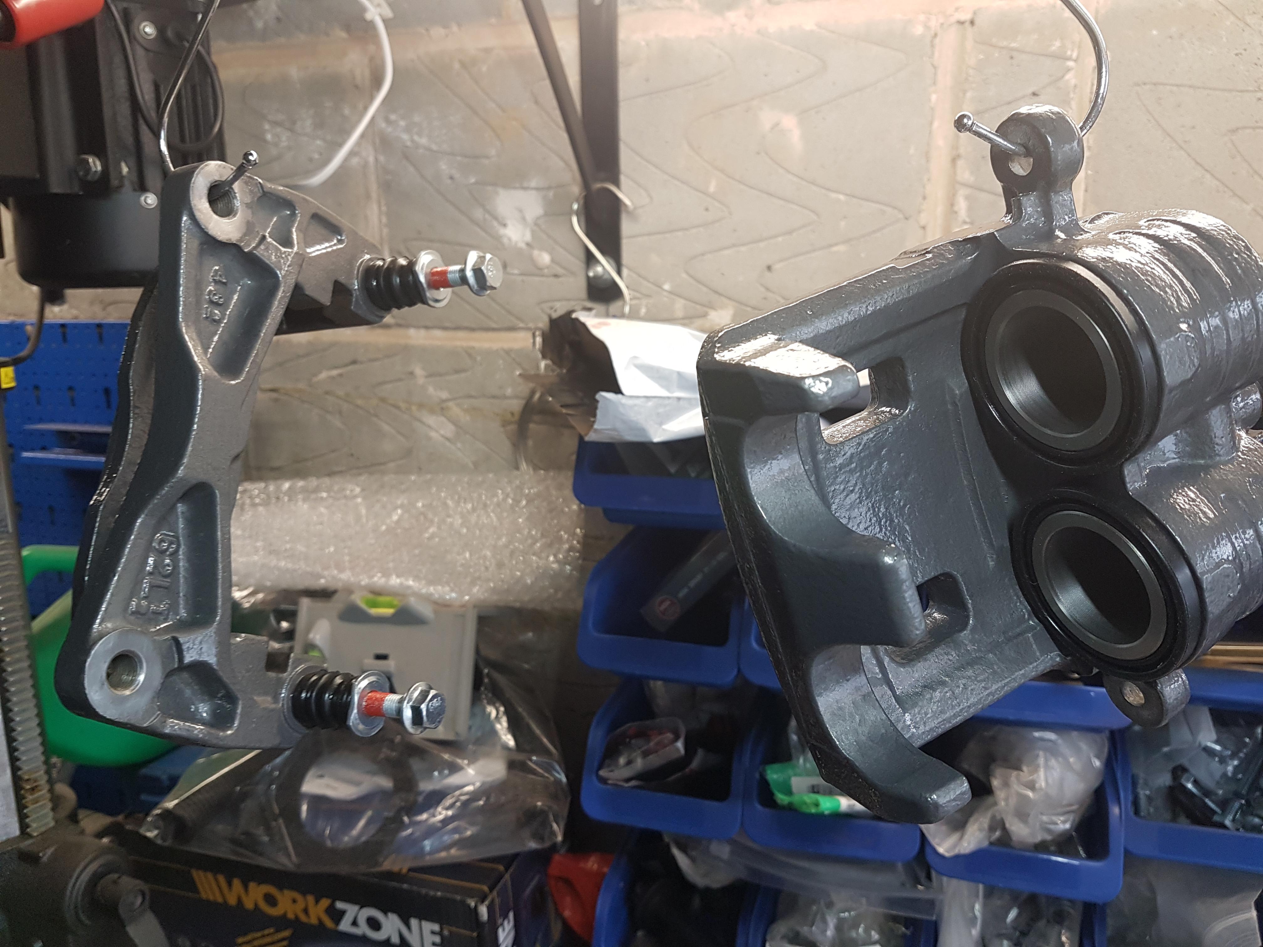

I'm in the process of rebuillding all of the calipers on my car - its a Forester SG9 2.5XT.
I've completed the fronts and just started on the rears,

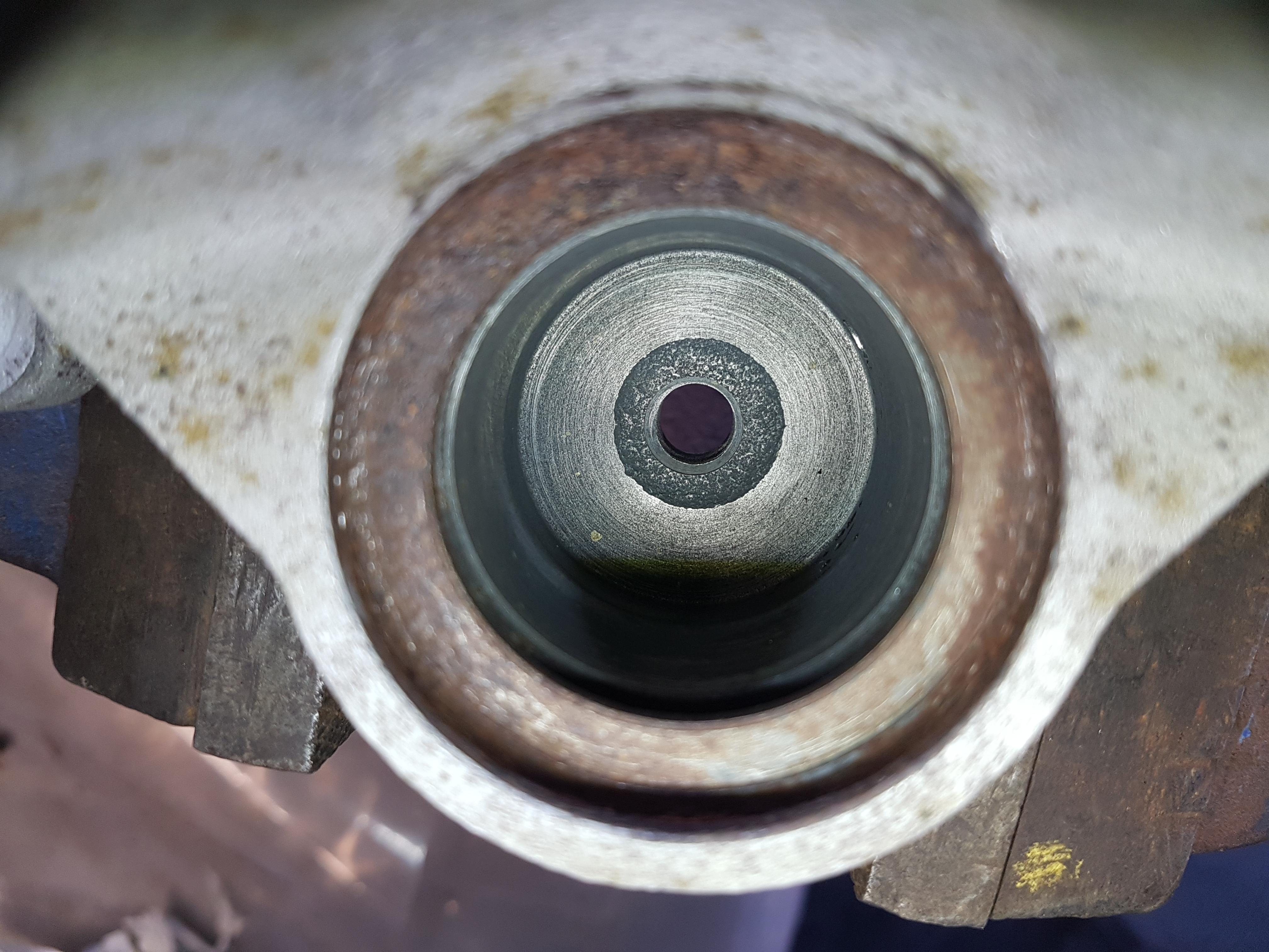

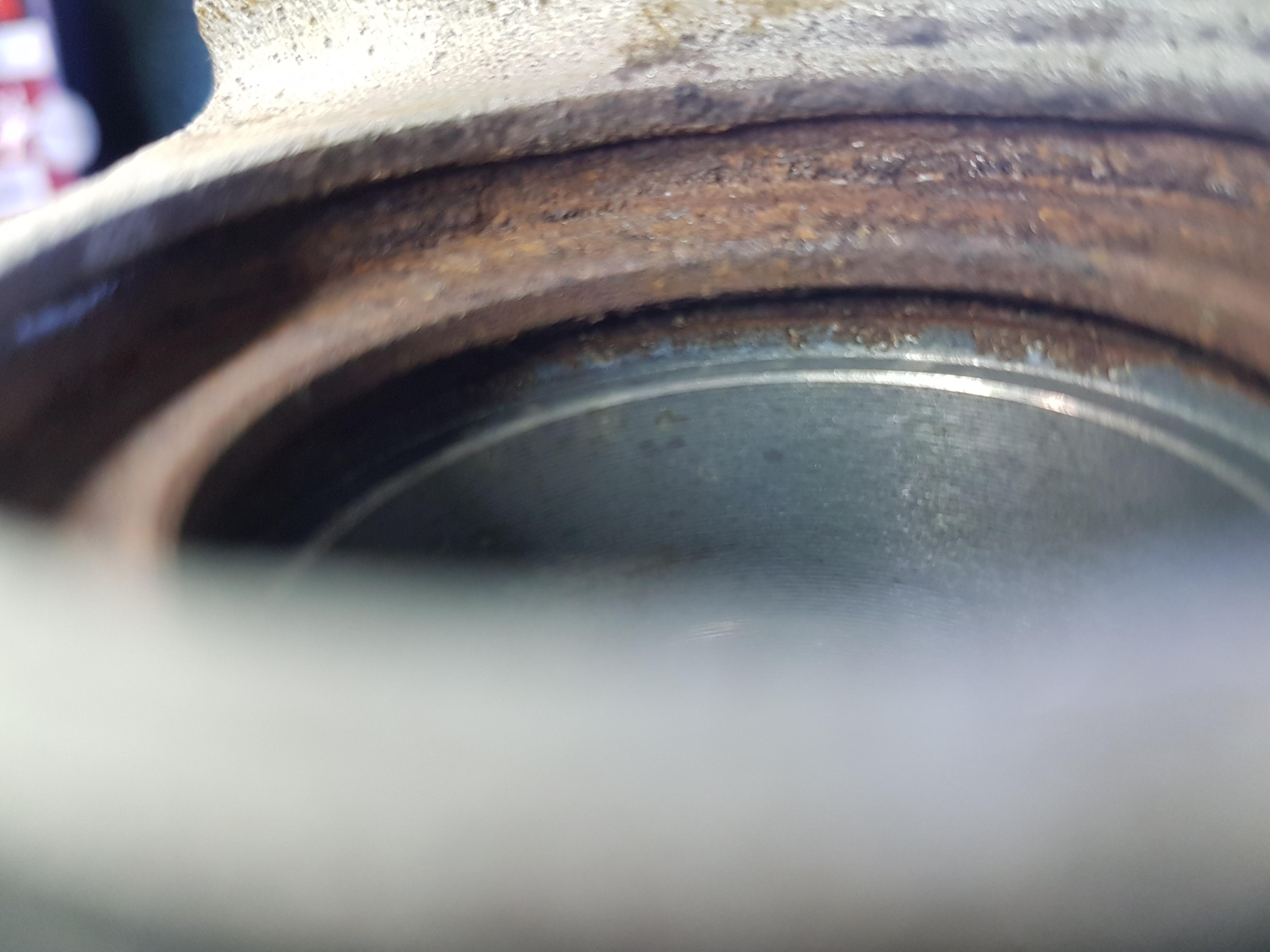

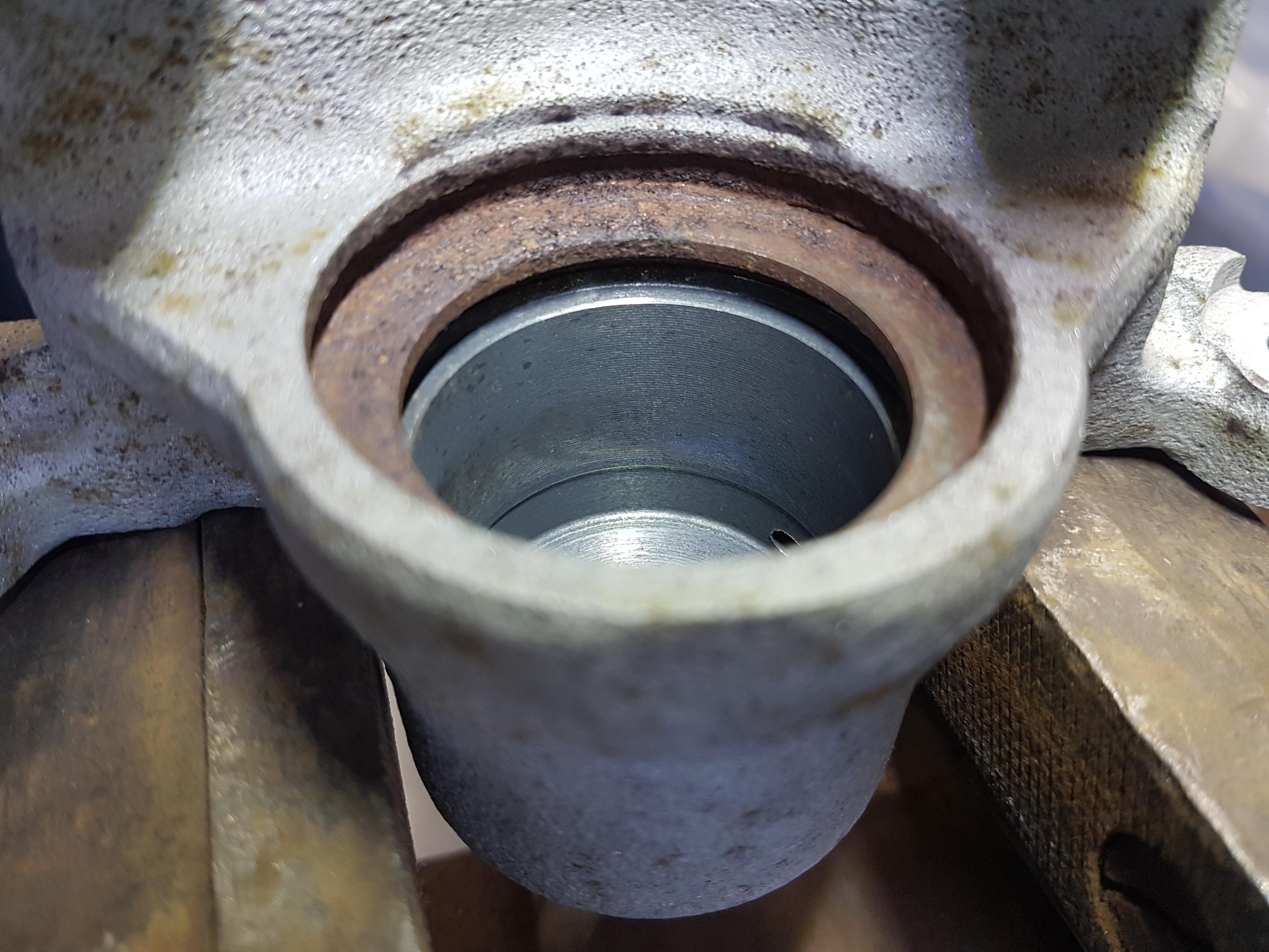

I hpoing someone can confirm whether the rear caliper in the photos is able to be re-used if cleaned up or  better to just locate a donor caliper and rebuild that instead?
Mainly concerned about the rust on the brake caliper piston seal groove that can hopefully be seen in the photos.
Thanks in advance.
The corrosion in the seal groove looks quite bad to me. I've seen industrial brakes (that are similar to automotive brakes) with 100 bar MWP leak with less crud in the seal groove. It may clean up, but I would get a re-con caliper, as there is no guarantee that a donor will be any better.

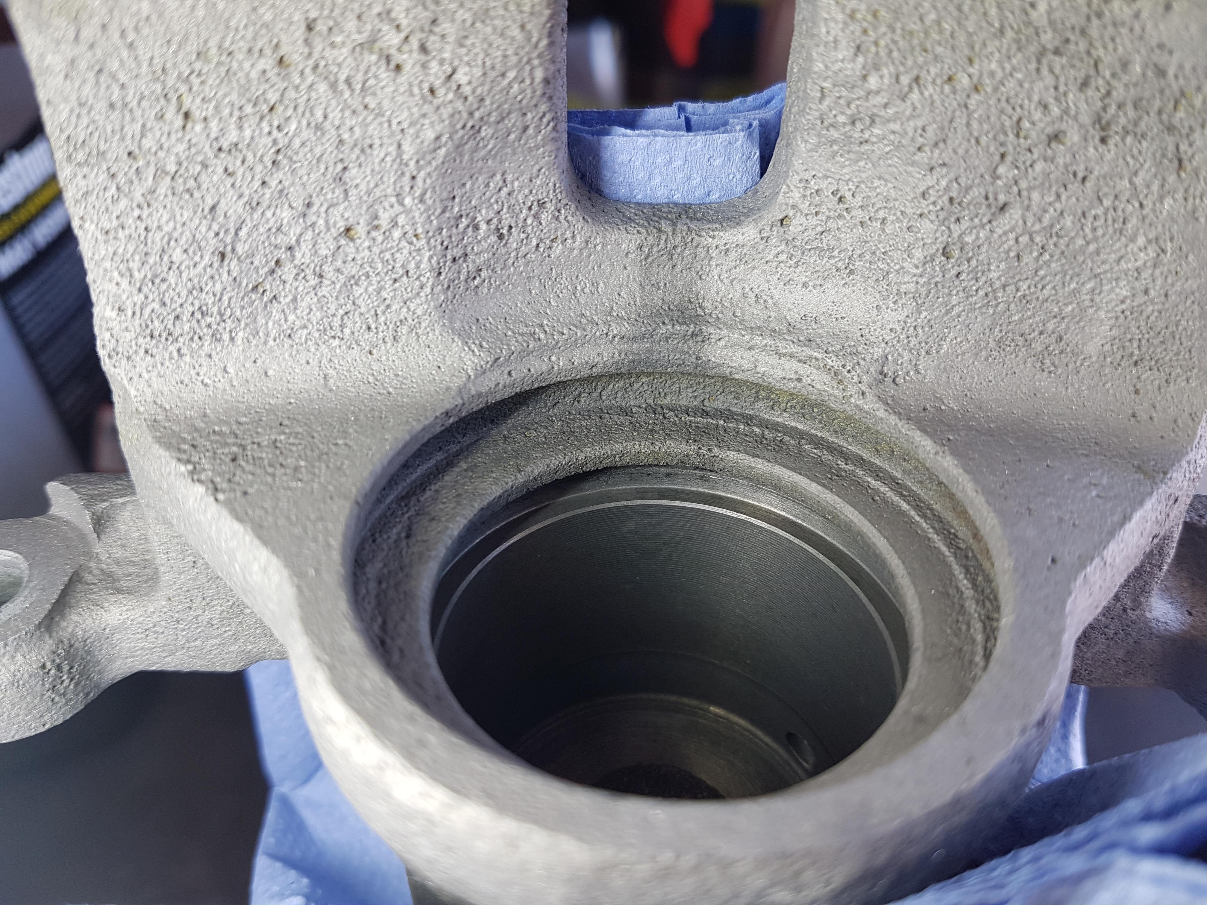

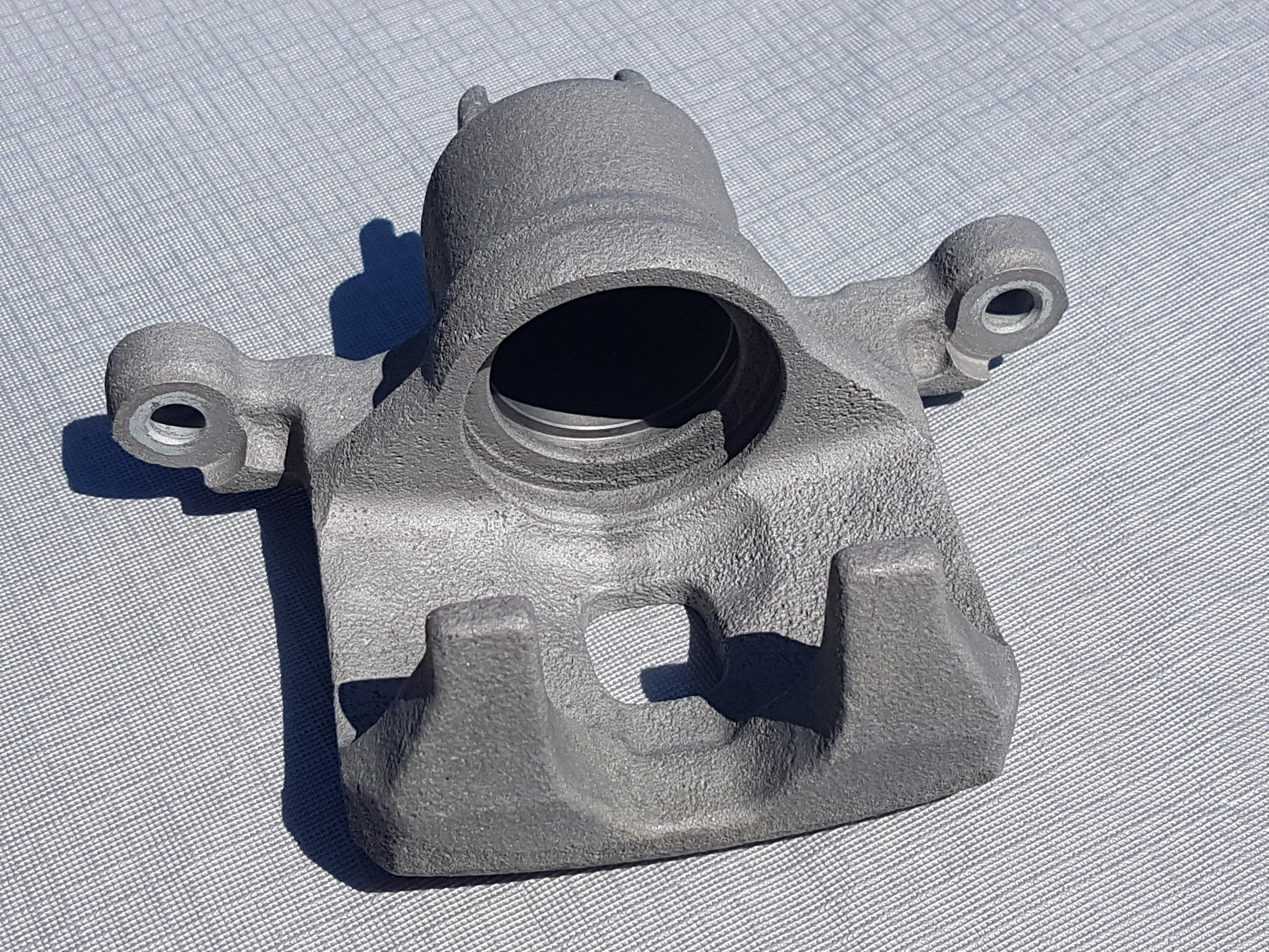

Seems to have cleaned up ok - tried the dust shield and retaining clip which fit ok now the rust has been removed.
Combination of Evapo-Rust remover -soaked for 36 hours (hence the colour), then refitted the old piston and seal and manualy removed the remainder around the dust seal area.

Added what I used to clean it up...
That should be good to go .
Is amazing what can clean up and rebuild if want to, we simply can't do it as labour and rebuild parts/materials come out 2 or 3 times the cost of a decent reman caliper .
About most we do these days is piston boot and slide pins.
In some circumstances we still do piston and seal but it generally due to parts availability and completion times or upgrade pistons/seals on good order calipers
