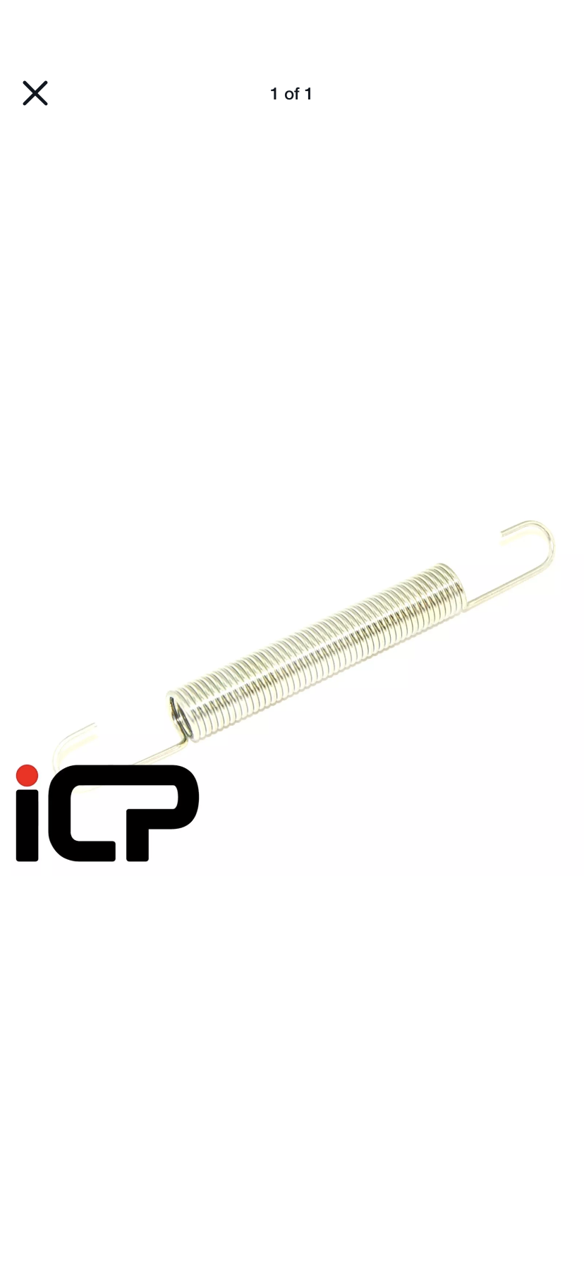

Hi mate I got a 94 Subaru Mine doing the same Had a look the spring is broken on the clutch fork so now getting new spring £6.80 glad it was a Cheap fix
Yeah the spring is on there. Really not sure what it could be. Like I said the gears are changing but it’s hard to change them and the bitting point on the clutch is instant almost within 1-2mm lifting it and it’s bitting. And there is not a burning smell from the clutch. Slave and master cylinder look fine as well.
