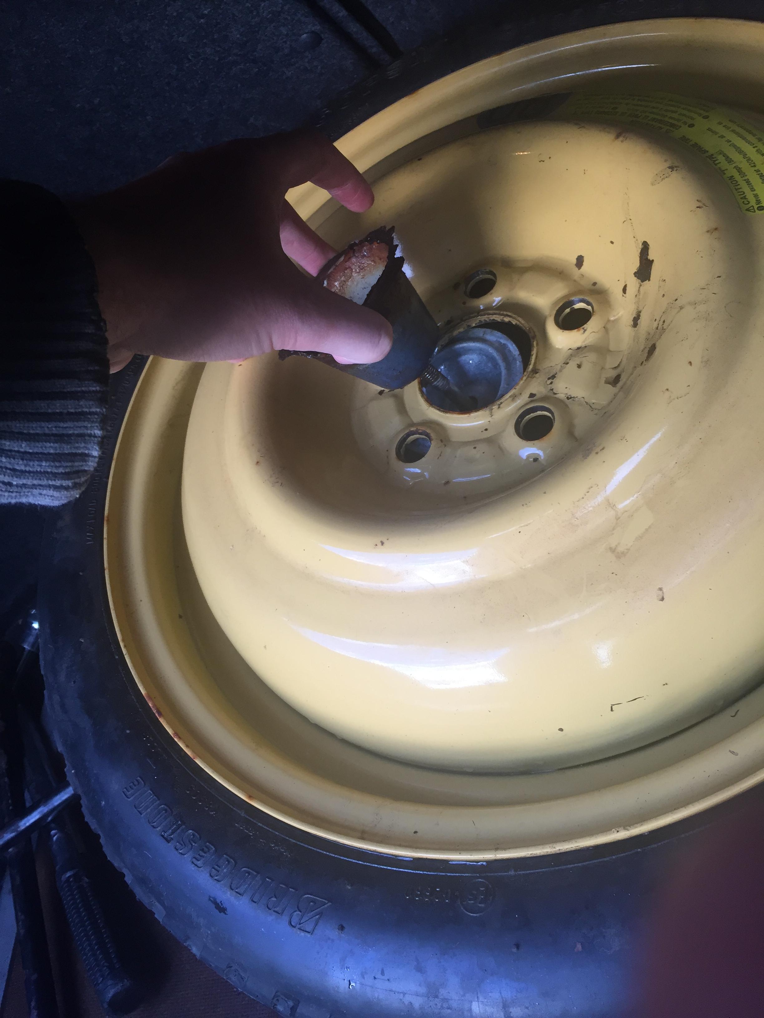

I joined back in June after buying a bugeye wrx but thought I’ll wait till I need help/advice before post something I recently put a topic up under the wheel/suspension section and I’m waiting there for a reply there so thought I’d try my luck here also, so my question here is has anyone got any tips/idea on what 5x100 18 inch space saver would work as my spare is the standard 16 inch and well did this when I tried to get it out see attached and cheers for taking the time to read this so sorry for the long post so here’s my bug before I put the standard light back in

What is wrong with the space saver you have as the wheel itself looks like the ones I have but you are holding a cone over it?
The cone I’m holding is the part of wheel well, that the “holding pin” I guess it’s called goes into that holds it place, the car had a small leak coming though the boot when I bought it but didn’t think much of it at the time (rose tinted glasses and all that) but it’s bit me back I’ll upload a photo when I get chance to properly show what I mean
Yup the mounting point is the cone in the photo I put up earlier I’ve got that off the spare now and the wheel is fine just two sizes too small compared to what’s on there I don’t really want to limp home and end up doing some damage if that makes sense
