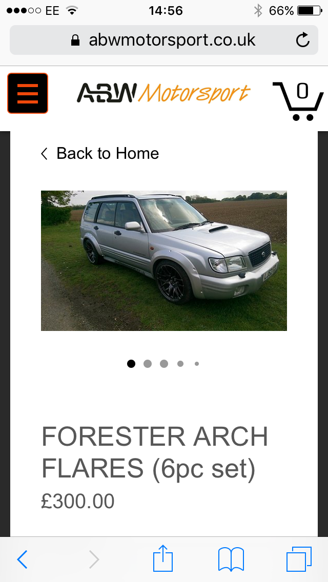

Hiya PeteB. Pic below of where I got mine from.
Ring darren up & ask if he can do a set like how Iv done mine.
he might do a revised version to look like mine using his molds as a base to work from
I did forget to mention that cos I'm running bugeye estate peddlers sports Ryder suspension that the wheels were sitting on top of the rear arches so I have to cut them up about 2inches which was quite difficult to weld back up & look like nothing's been done.
the same on the front arches, but I cut them a bit lower so I could bend a new lip around to restrengthen it, so the wing wasn't floppy.
