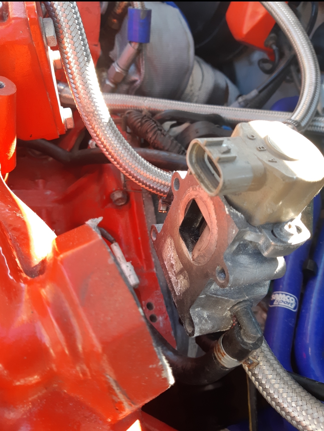

As mine wasn't standard when I got it , if you think it sucking in air and increasing idle ?
You could get a smoke test done to rule out intake air or vacuum leaks .
If not then cleaning the idle control valve is the next cheap thing to try .

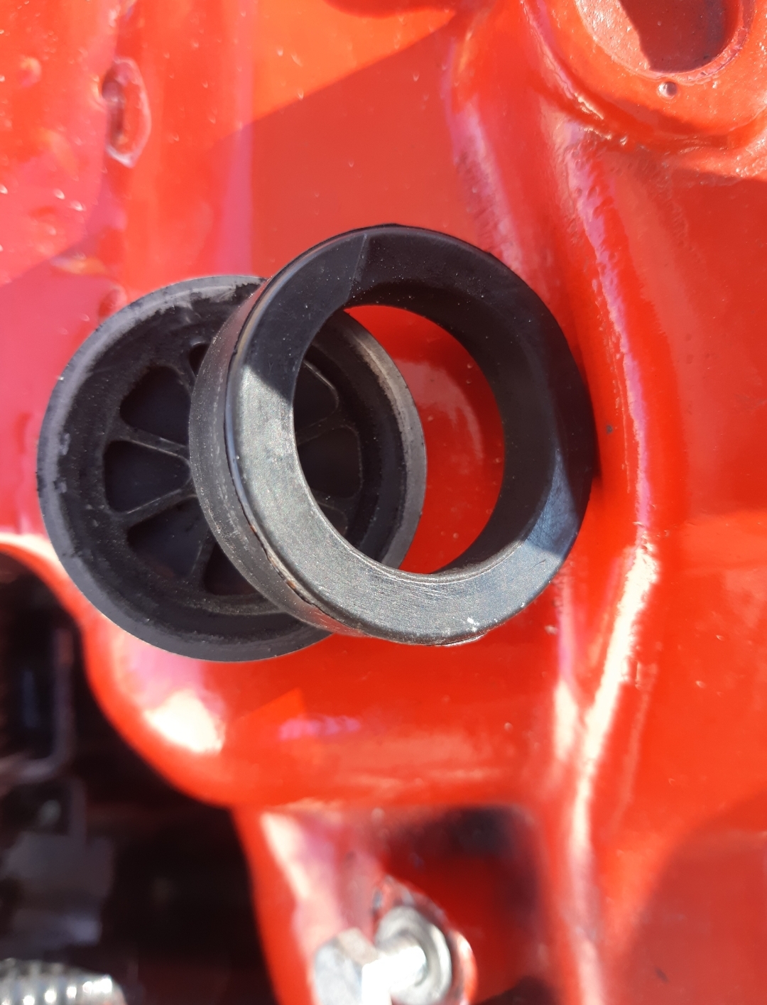

Get a icv gasket, remove the icv from the inlet , take note which way the o ring and diaphragm face that sit between icv and inlet (for refitting).
Screenshot_20210410-160202_Gallery.thumb.jpg.201c0b4b5ba6bce7fcce4e80a9ba2e71.jpgScreenshot_20210410-160219_Gallery.thumb.jpg.c74551b5de64e0d522a5c26647c54afb.jpg
Clean icv and diaphragm with brake, intake or carb cleaner .
Let dry, Refit with new gasket and top up the coolant if necessary.
Could try a ECU reset afterwards too , just dont adjust the 2 screws on top of the icv (as these adjust the voltage to the ECU)
