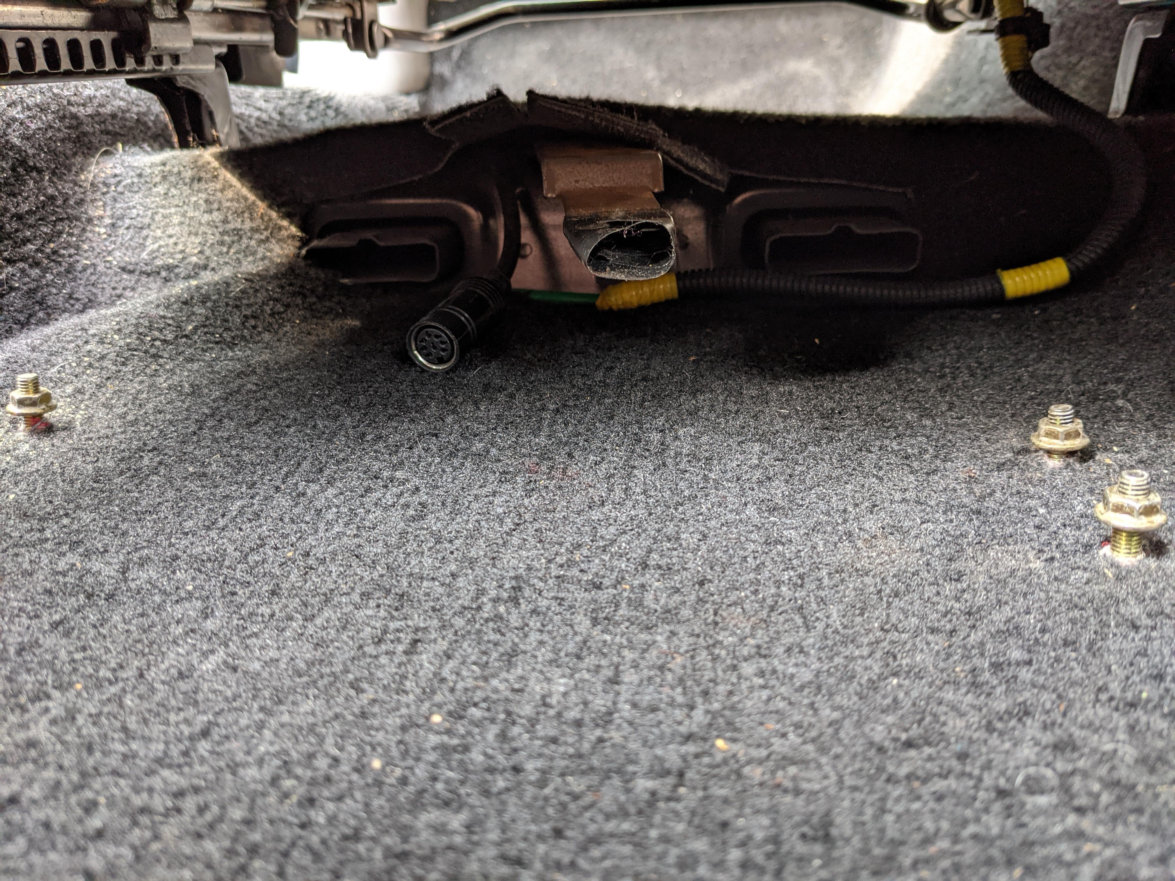

A) What's this all about under the passenger seat?  There are 4 bolts in the floor and what looks like a 6-pin audio cable.  Would there have been a multidisk changer in the other originally?  The thing in the top/middle of the pic is a movable bit of metal with some tape around the end.  I've had a feel around and can only assume that it was once part of a bracket?

I have a JDM Forester 2007 ( cross sports) and under the passager seat I had (still have ) the GPS card reader part of the head unit Panasonic Strada (replaced)

a, assume you likely have non standard head unit install .
