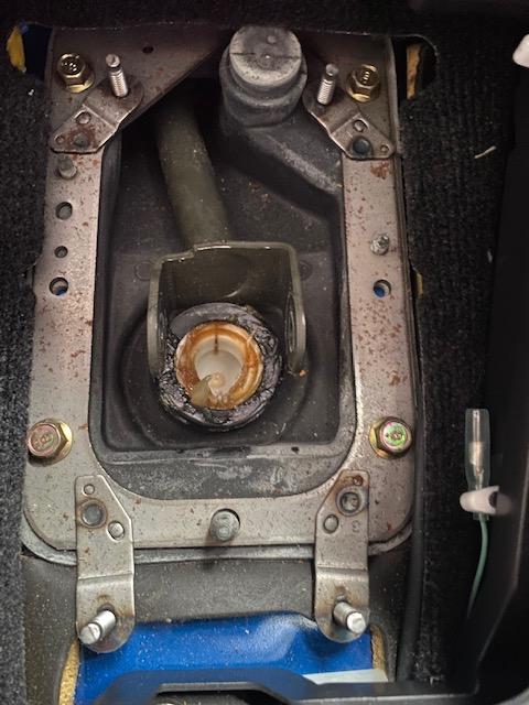

Well I did check and it looks like I have the standard shifter, as per the pics below. However, I have decided against the Perrin adapter and have just ordered a Kartboy shifter instead!! 😁
I liked the simplicity of the Perrin adapter, both from a design and installation point of view but the more I looked at it, the more I thought that it's a work-around, compared to a replacement shifter. Plus the need to bend the metal, base plate and the different shift position were both minus points in my book. The Kartboy shifter seems to get rave reviews from many, and since it's only a little more expensive than the Perrin adapter, I therefore decided to go for one of those instead.

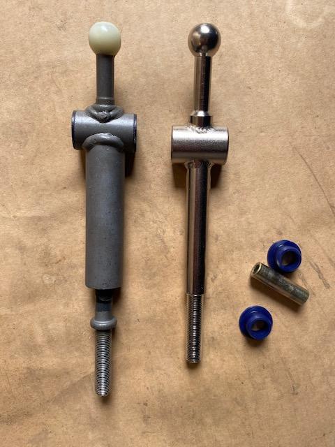

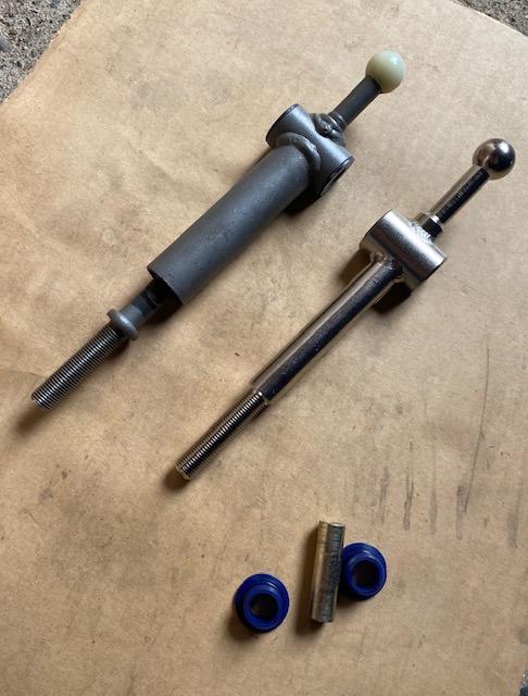

Tried to install the Kartboy shifter yesterday but failed! 😭  Removing the OEM shifter was fine but getting the KB in was indeed a PITA, to put it mildly! I don't have any suitable pliers to remove the c-clip, not that I see it anyway. That left me with the ol' rubber mallet option but after an hour or so of swinging and swearing, I gave up. I tried inserting it at different angles and even resorted to a block of wood and metal hammer at one point, but decided to stop after the wood split into two! I did, however, manage to mallet the stock shifter back in, so could at least drive the car today. I have a couple more ideas to try tomorrow, including using the linkage to lever the shifter in and putting some nuts onto the top of the shifter so I can whack it with a metal hammer without damaging the threads. 🙄 Onwards and upwards!!
I thought you had to release the circlip before removing the white, plastic socket/cup thing with the shifter in situ? In any case I'd prefer to avoid buying some special pliers just for this, so will try the other options before resorting to that. Grrr! 😣

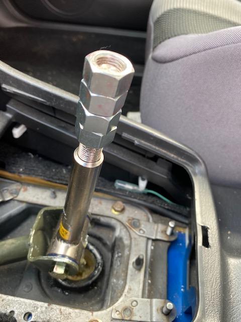

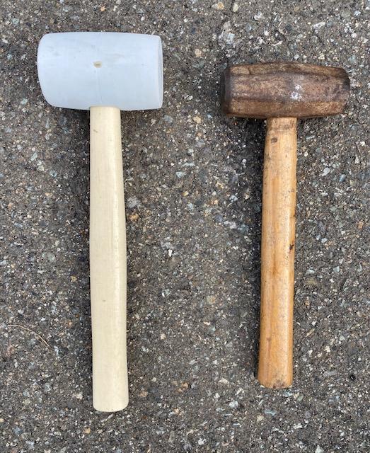

Success! Bought a pack of M12 x 1.25 nuts and swapped out the rubber mallet for something more substantial. The shifter went in on the third or fourth hit! 👍

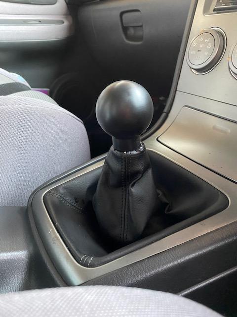

I put the stock knob on there to begin with and tbh, was a bit disappointed as I was expecting more of a shorter throw plus it was a bit "squelchy", probably due to all the grease I had used. However, after a few miles, I put on the WC Lathe Werks knob and that felt much better. Am going away for a long weekend tomorrow, so will have the chance to give the new set-up a good run out 😎

I have now put about 500 miles on the Kartboy shifter/WC Lathe Werks combo and I flippin' love it. The new shifter has bedded in, if that’s the right expression, so is now smoother and less notchy than when first fitted. I love the shorter throws, particularly between 2nd and 3rd gears.

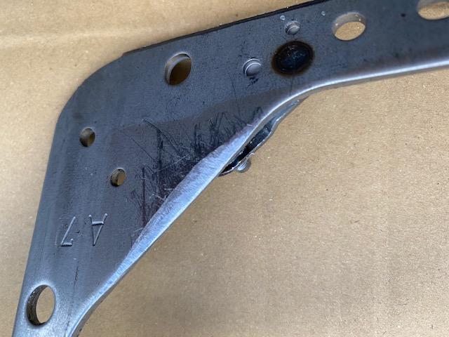

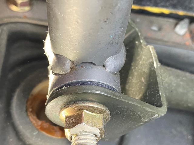

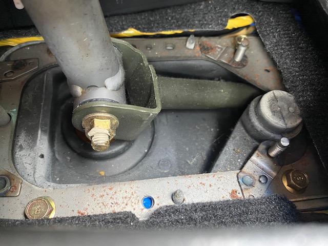

One thing I’ve had to do was modify the base plate to avoid contact when engaging first gear. I didn’t want to cut or bend the plate, so removed it then filed the underside where it was being hit by the shifting rod. As you can see from the pic, it’s not very pretty but it's smooth enough and is obviously out of sight, so I'm okay with that. When I refitted it I was also able to move the plate forward and to the left by a couple of millimetres. As a result of one or both of those mods, the contact has all but gone. I may do a bit more filing on it when I get home and/or slightly widen the 4 retaining bolt holes but for the moment, I’m enjoying the smoother shifts. 😎
