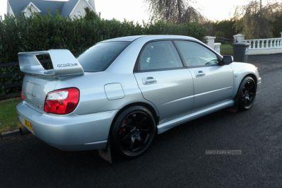

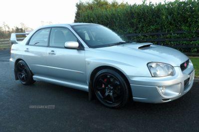

not sure if it worked but put a few pics of her let me know wat you think cheers

Wotcha and welcome - great looking vehicle you have there
