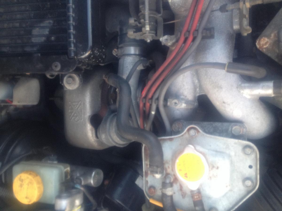

Had a look today after work. A hose that connects just to the bottom left of intercooler is loose (If looking from above) Pushed it back on and it seemed better, then halfway home it started again, Checked when I got home and µe hose had come lose again and leaked some liquid. What is this hose? Also seems perished at end so will be replacing it I think, Took a photo bat photo bucket isn't Working at the moment and am only on tablet at the moment.
I think the boost solenoid is in front of the offside strut. is the hose your on about underneath the intercooler at the bottom left? if so it could be the 90degree elbow hose that connects the turbo to the intercooler, definitely doesn't wanna be loose.
The picture is sideways, but it is the hose going from just by the yellow cap to the turbo. I have put a new clip on it and revved and it hasn't loosened but I haven't been for a drive. Could that be the cause?
Thanks
That pipe from the header tank to turbo is for turbo coolant and shouldn't cause a misfire , worst case you might have air in the system .
