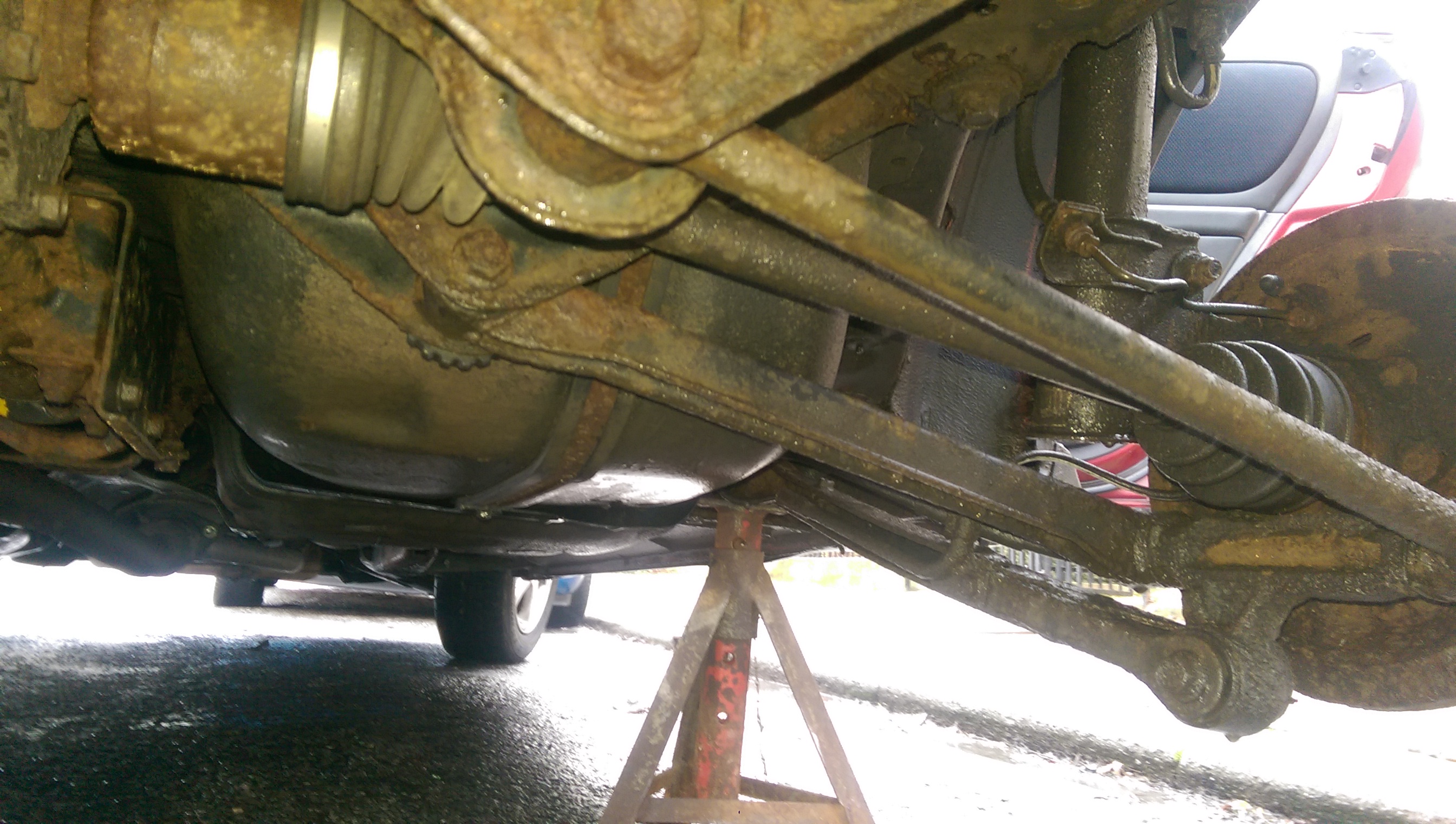

To me the arm looks twisted n where it bolts on to subframe. Could be looking at a Scooby going to scrap yard :(

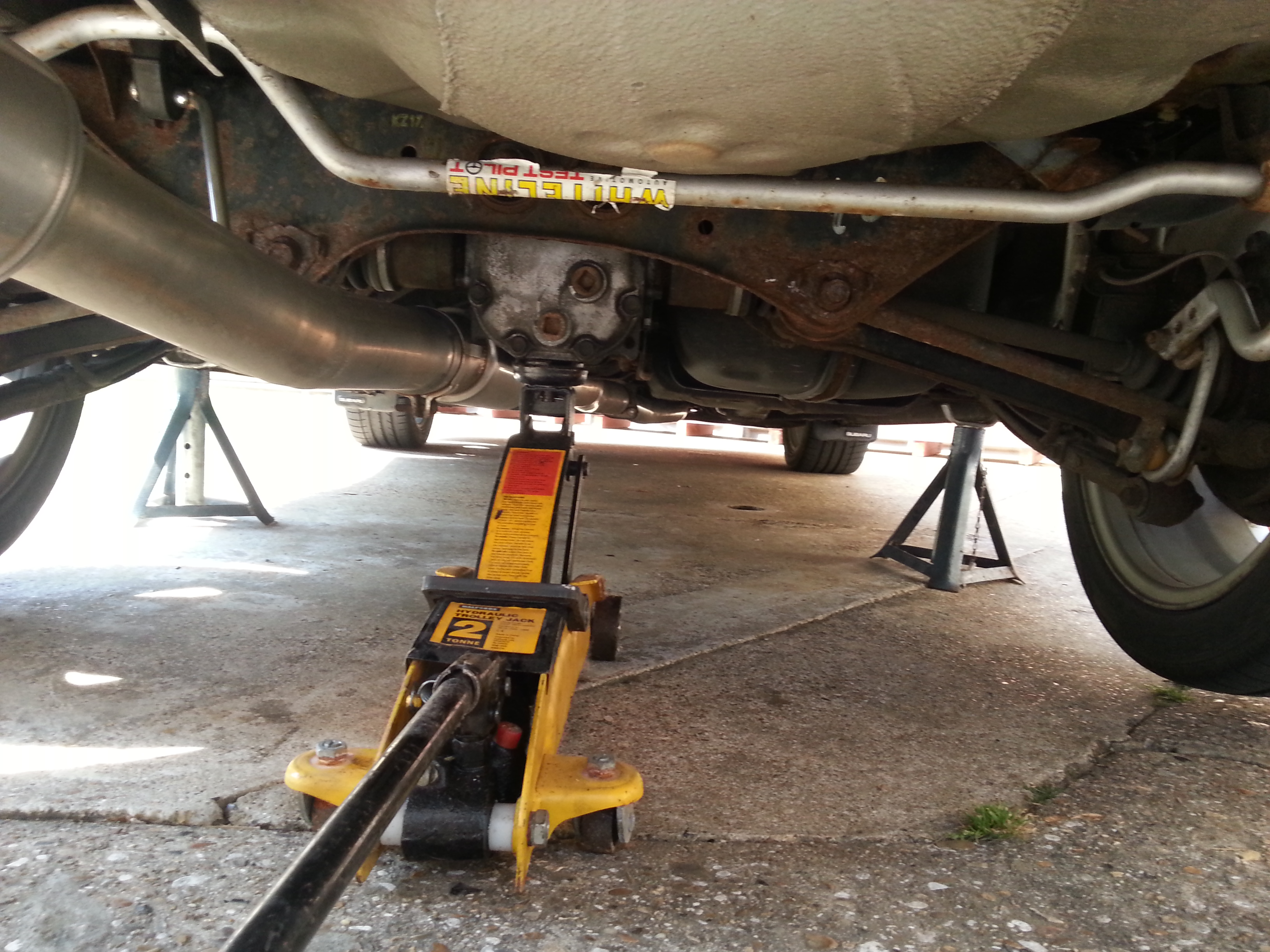

Can't really see a issue in your pic but pics are discecptive , here's one of the same area on my 97uk (I can't see much difference )
Have you tried levering the bushes/mountings to check for play
Or take some crude measurements from bush bolt to bottom balljoint and check against the other side

Just had someone out to look at the car n its the subframe n arms and links that are all bent. Strut looks fine. So need to find someone breaking a classic n just drop the full back end out of it.
Think I could probably just get away with a subframe n new bushers for now. But probably going to be hard finding a good subframe for that year car like.
