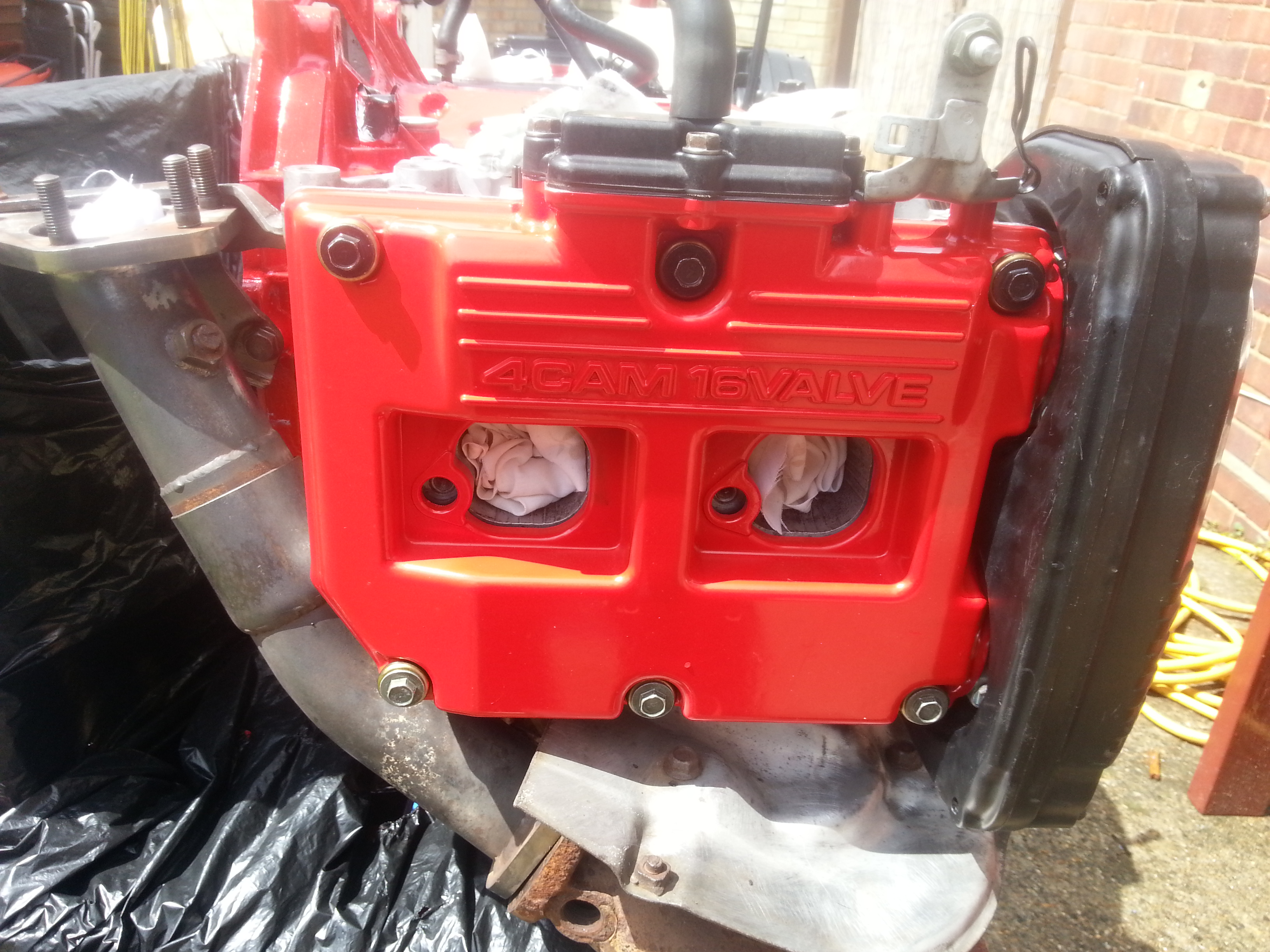

The area your describing the smoke coming from would suggest a oil leak dripping onto the headers, probably from the rocker cover gasket/half moons (at the back end of the cams) as these get brittle due to the heat from the up pipe . if not check the turbo oil drain pipe as this can sometimes split or block

Easy way to check is pop bonnet and look inbetween the airbox and rocker cover, you'll see the up pipe at the bottom, my heatsheild was covered in oil and grime. If it's the other side won't be as noticable
