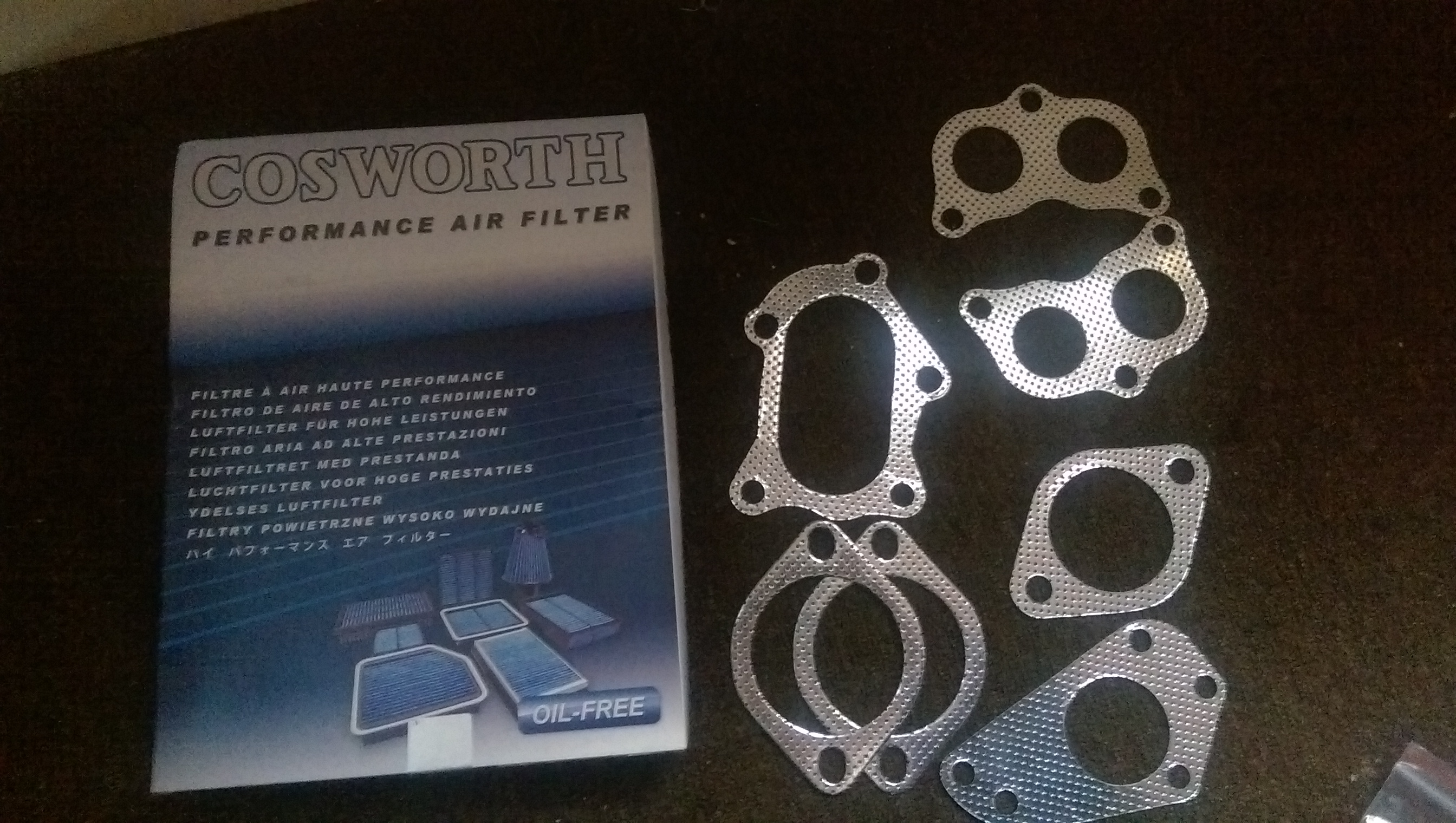

If that was the problem, what would the fix be? I am a little confused as to what exactly would be wrong if you're diagnosis is correct.
This is a picture of a gasket set I just bought. You would need the largest one in the centre of the picture for the turbo to downpipe join. Over time these gaskets deteriorate to a point that they break up and leave a small gap between the two metal joins. The bottom right almost triangle gasket is for the up pipe to turbo.
If the downpipes been removed at some point the gasket might not have been replaced with a genuine subaru one .
Same scenario for the upipe gasket and subaru exhaust system gaskets are "crush" type and ideally shouldn't be reused .
when they have they tend to blow when cold and blow a bit less once everything is hot and expanded

Found the gaskets, any idea on how long it should take me.. is it a straight forward switch over?
I'd visually check for soot marks on the joins once you've narrowed it down by ear.
As I wouldn't want you to buy gaskets that you might not need.
If it is a gasket issue and Pending in on the condition of the existing turbo outlet and up pipe studs and nuts, you might want to buy a few new ones just in case you fubar some on removal and have to wait until you can source some .
Turbo outlet (once the tmic is off) 15 mins to change if all goes well.
Up pipe about 1hr and £20 for the swear tin
