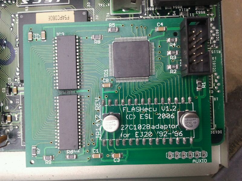

The standard ecu for pre 98 imprezas can't be mapped without having a esl daughter board fitted so I'd start by popping the cover off to see if it has one .As with those mods and the boost controller not working right I doubt the ecu knows what's going on .
Here's a pic of a esl boarded ecu
Do you know what "version" it is via the model code ?
As this will help with identifying what type of fuel set up/inlet phase you have [emoji6]

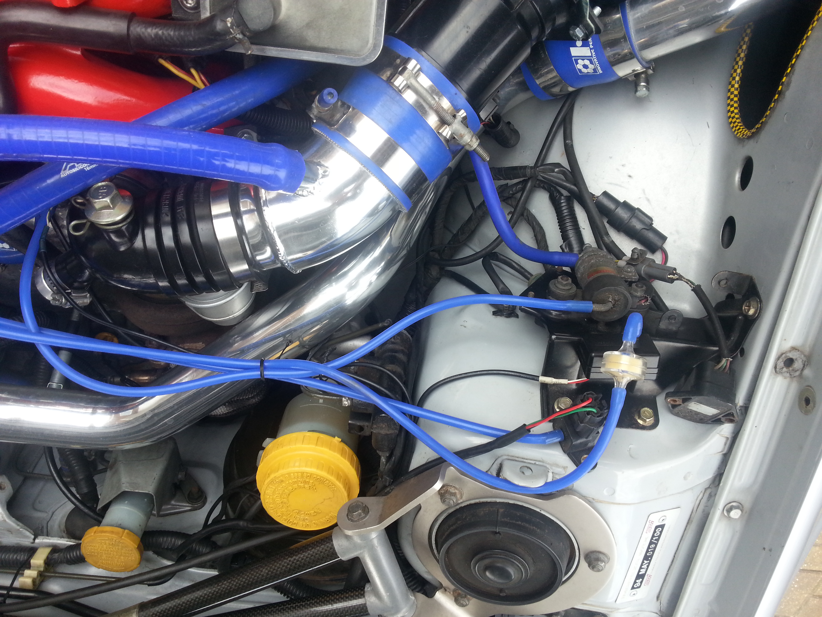

Ok so I've had a very quick look before I go out and I've found my boost problem it's all plumbed into the apexi boost controller, so with this not working because the apexi ecu has gone it's just running off waste gate pressure 0.6 bar? Seems plausible
Somewhere on here there's a list of boost solenoid vac line positions for all models that I've posted which would be handy if your intending on putting the boost control back to standard .
I think yours will have a 3 port boost solenoid
bottom port to intake pipe ,somwhere between turbo intake and air filter (mine vta in the pic)
Middle port to actuator
Top port to turbo outlet

On the drivers suspension turret there's a boost solenoid with 3 vac lines coming off it where does each one go to ?
Also on the same turret bracket there's the map sensor with a black plug and one vac line attached where does the vac line go to ?
