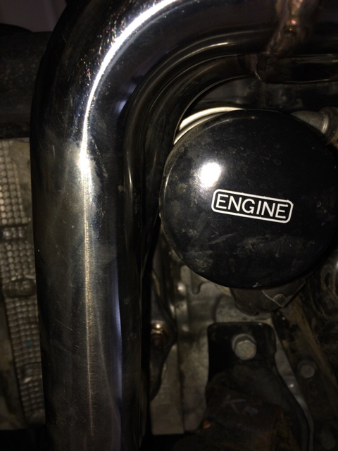

They fitted! Not without problems though... First of all, the port holes on the manifold were out (my guess is as it's a cheap manifold they didn't bother checking), so after a little bit of persuasion with a crowbar it went on! Also, the manifold rubs up against the oil filter post-3486-143911728957_thumb.jpg again probably due to the lack of !Removed! given at the manufacturer. You do have to cut a small chunk out of the engine and gearbox under trays as the pipes are routed slightly differently but apart from that, if you spent a bit more on a decent brand, it'd be an effortless install! Here's a vid of the result: http://youtu.be/6yX0jJMJHVM

Hi mate, got a feeling I replied to one of your posts on facebook about this- in my case I went for the . Had to spend about £300 getting it modified. Also if you do need to get them modified, make sure you use a reputable place as mine was blowing after the first place I took it to!
The flanges were the same shape, no issue there. The issue was the actual pipework. It ran way too close to the oil filter and was too far forward in general (it was pulling the rest of the exhaust system forwards). To cure this, the pipes were cut, with additional sections of pipe welded in between the cuts. My thoughts after it all was to try and find a breaking
