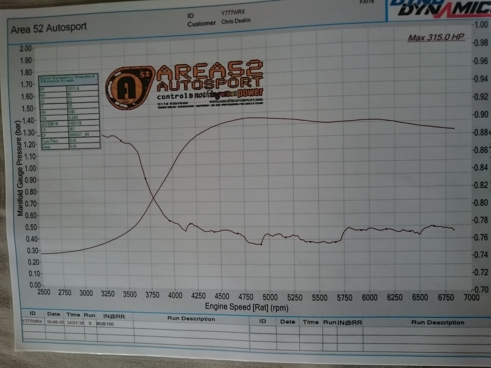

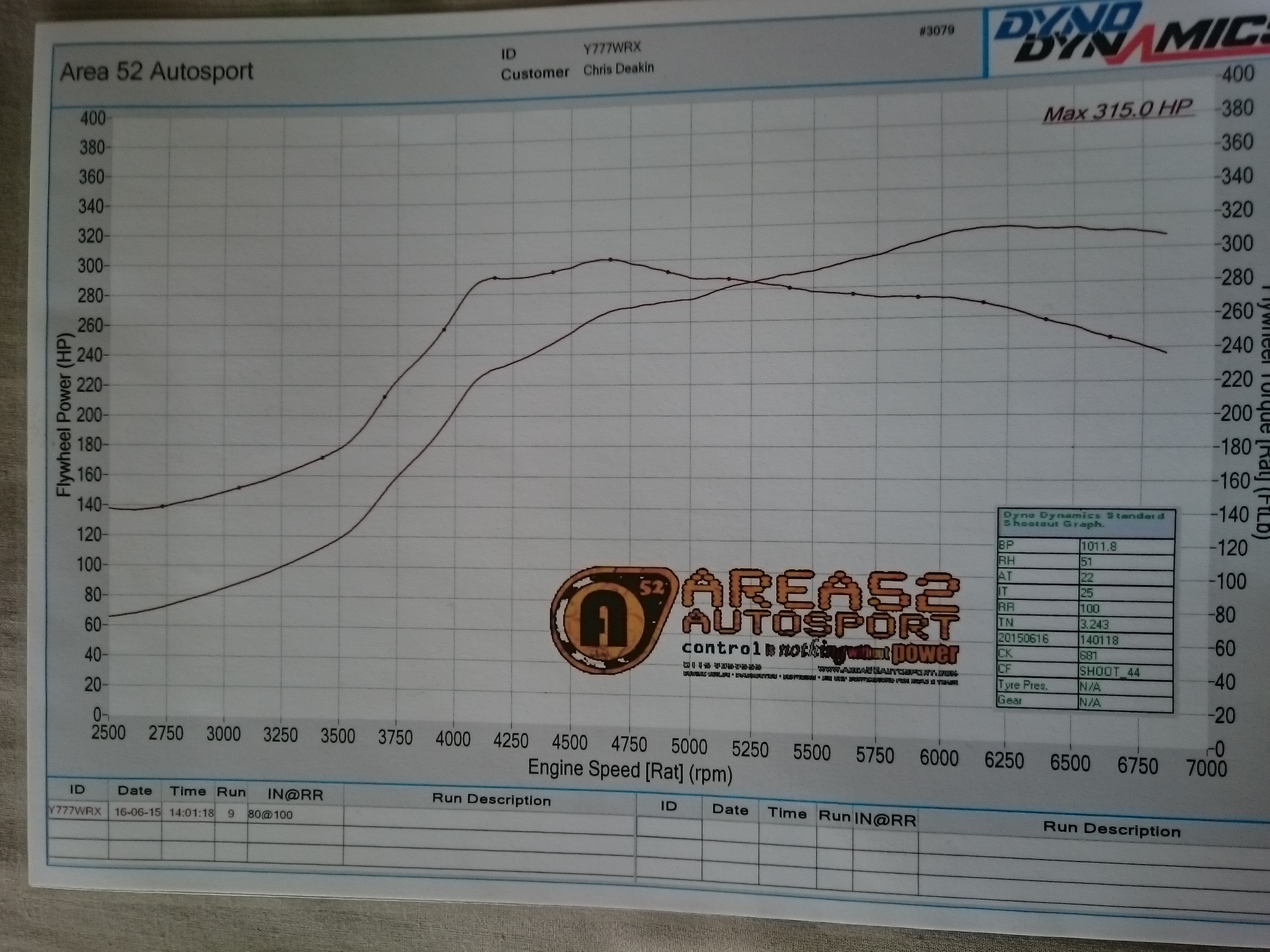

Getting 315 hp which I'm a bit disappointed with but the worst part is Its taking 4250 revs to spool up so in my head it feels slower unless I rev the knackers off it then you have less pulling time in each gear.

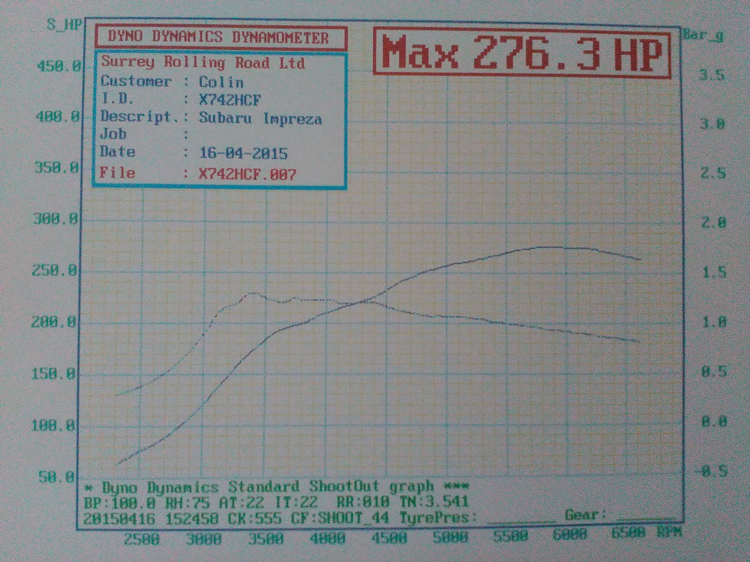

I recently added the vf35 from td04 which spooled at 3k with the cat in the up pipe, was running 266bhp before pinks vf35 and up pipe cat taken out.

I see 1.2 and cuts around 1.3 we fed in more boost but it wasn't doing much to the figures so he wound it back. That graph's not too great and various people said that there rollers read low on hp and torque depending on who you speak to ! so I'll get it on a power run, a nackerd wheel bearing and sticky brakes may not of helped haha
Yeah mate I probably will this year, just hope my brakes come back ok. Wish I'd just gone bigger wheels now a couple of months back wouldn't be having this problem !
The pictures I sent are with vf35, the mapper said my turbo seems to spool slow but didn't explain. He asked what up pipe I had then when I told him said it should be fine
