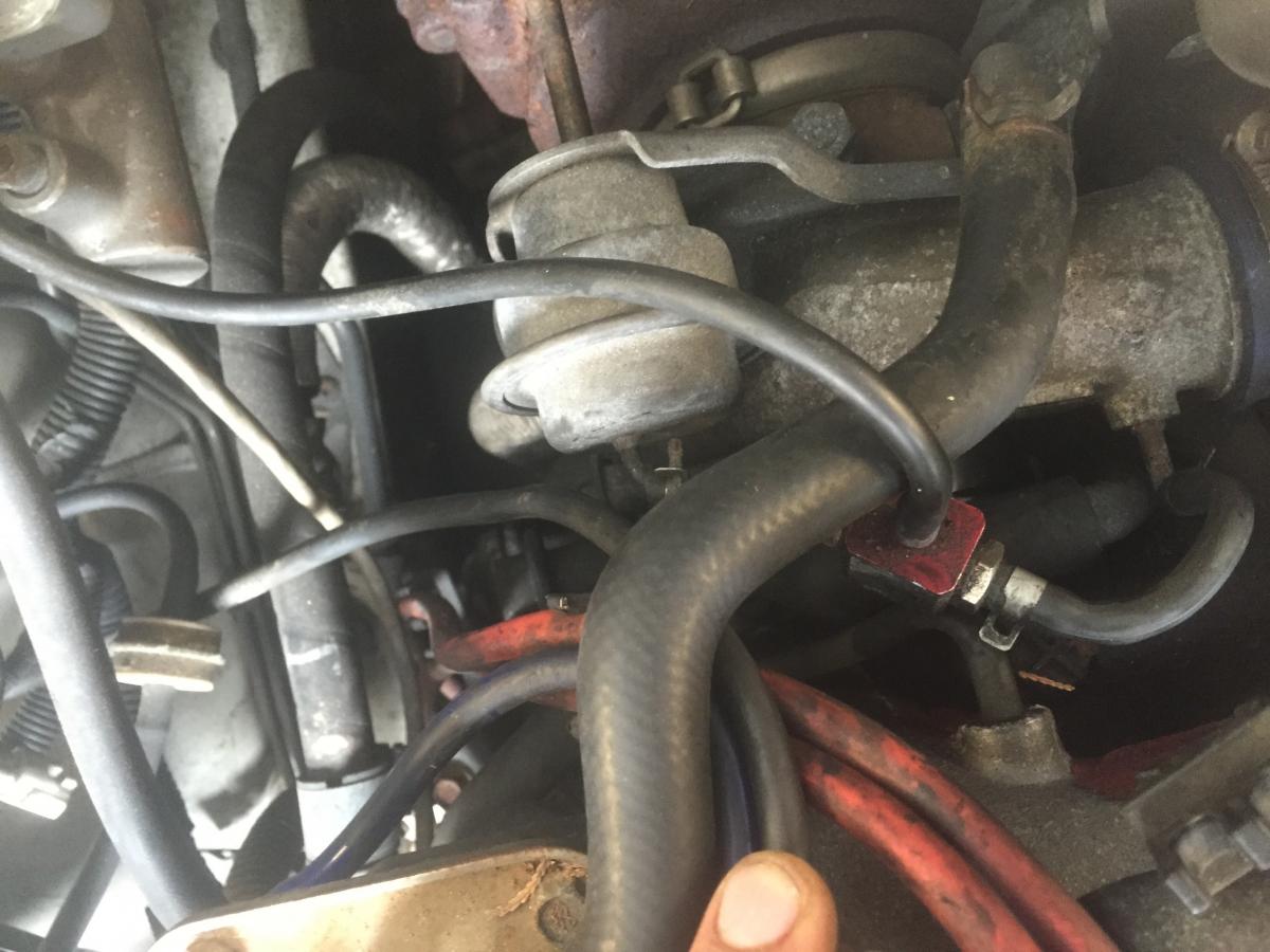

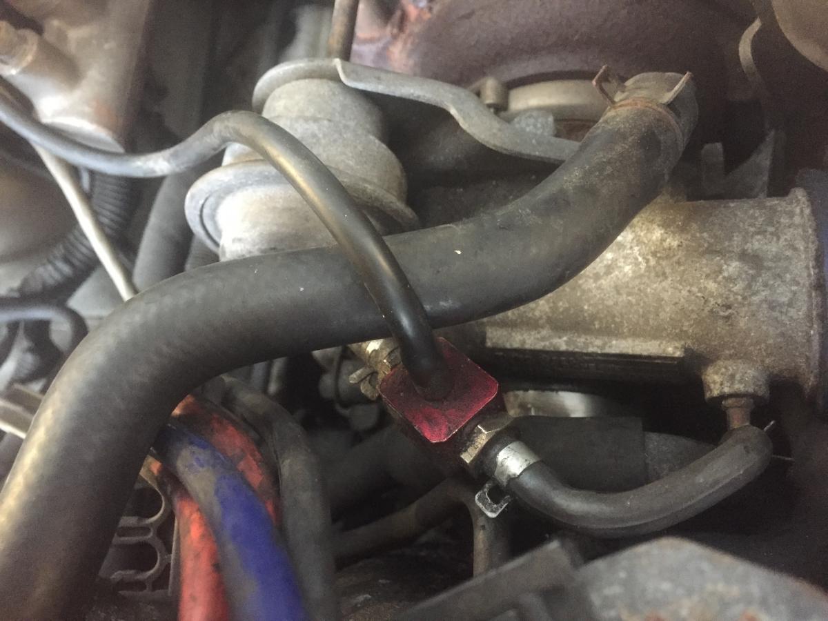

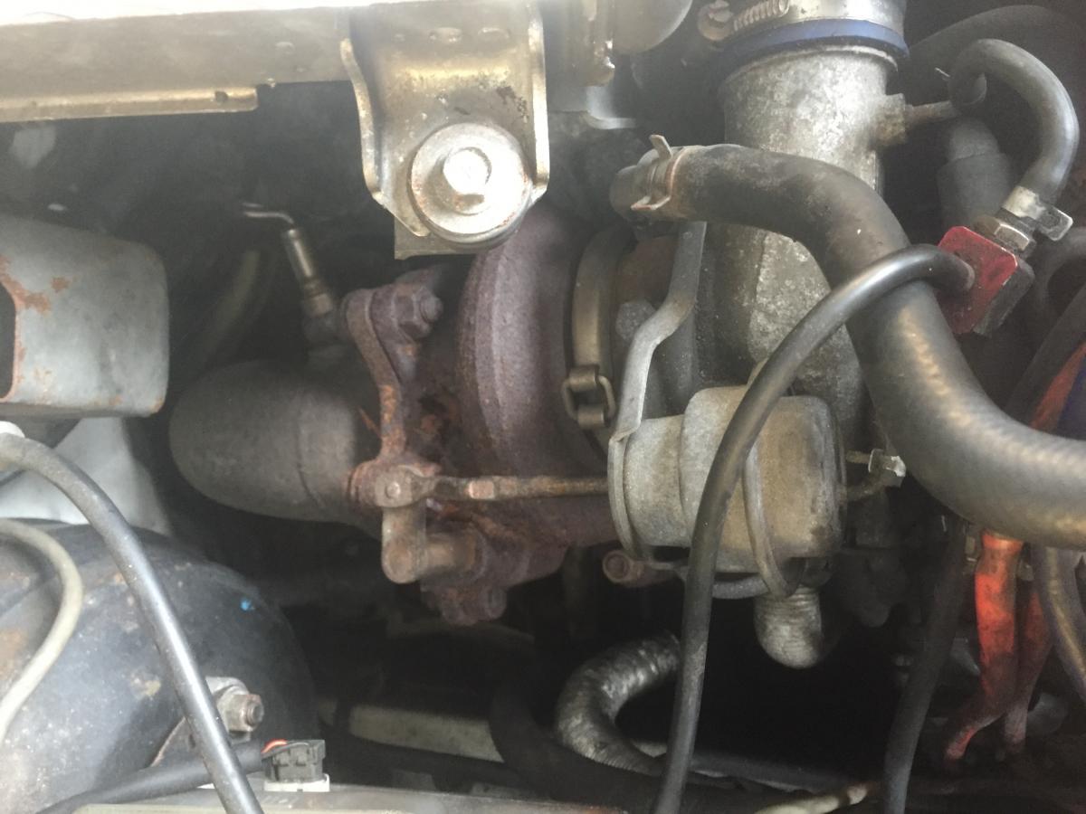

Could you chuck a couple of pics up of under the bonnet including vac lines from turbo/actuator to boost solinoid (drivers side suspension turret on a black bracket)
So v3 but either 97/98 year. This one is white and pretty sure it hasn't got the badges. I will get some pictures of it+engine bay etc and try get them up tonight. And as far as I know it doesn't boost. It doesn't cut out when driving, but idling is a bit lumpy.. Which i guess the Split intake hose will cause? Thanks for your help by the way

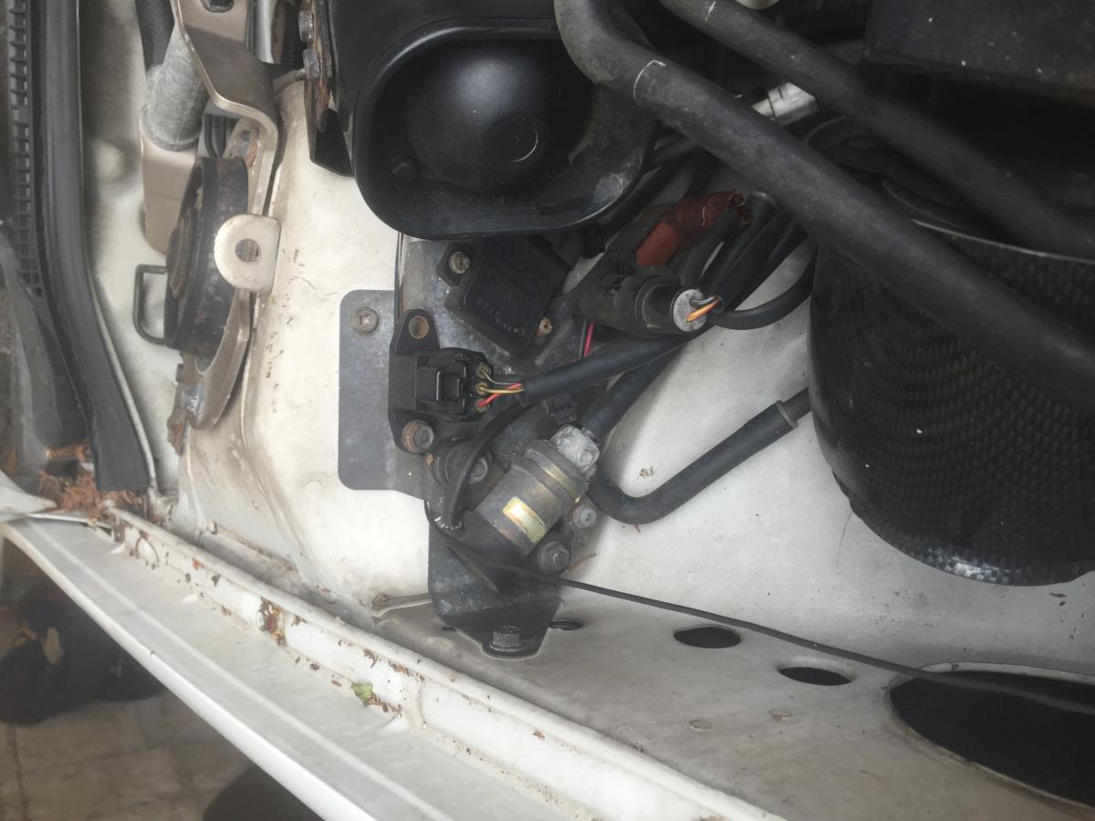

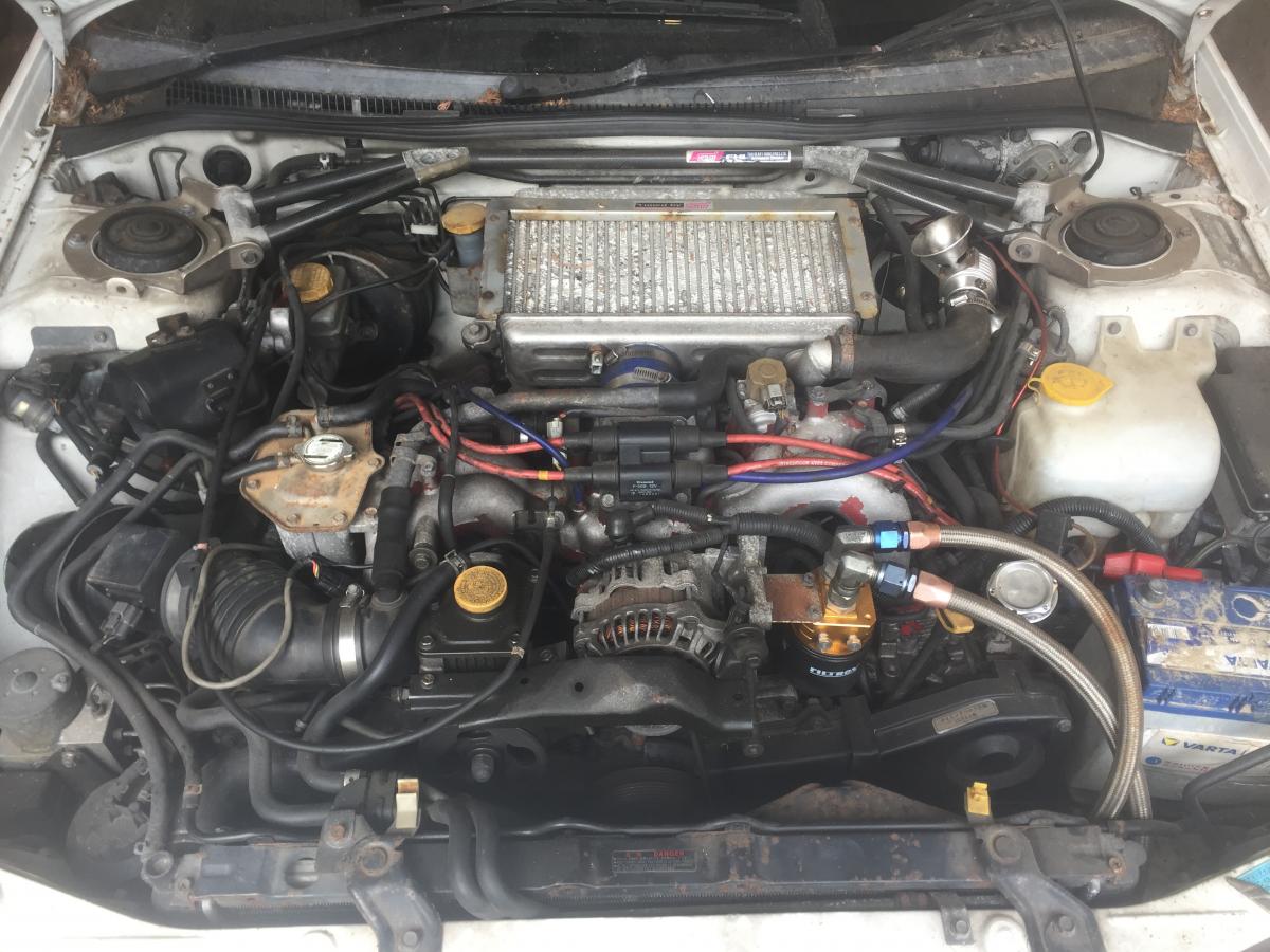

Engine bay
Savage bulldog
