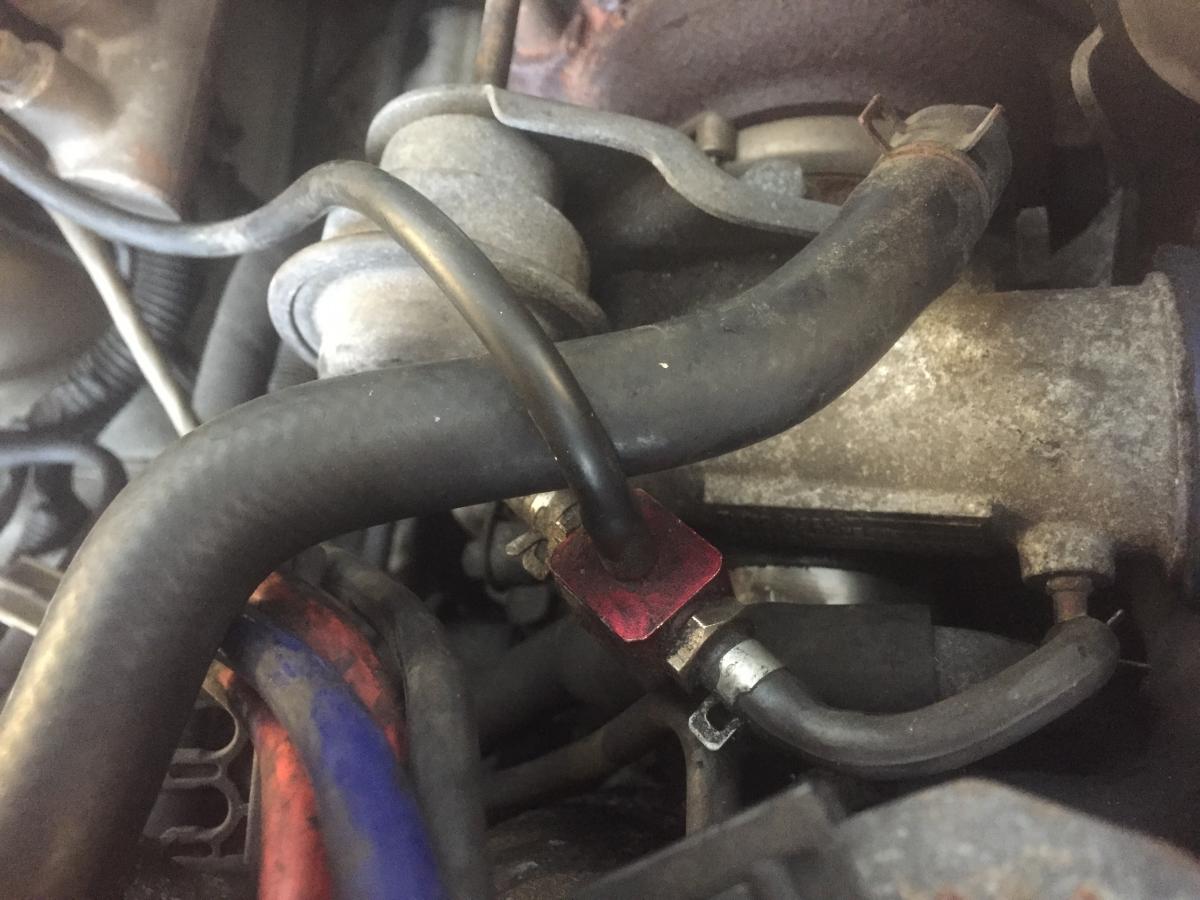

Can you get a better pic of the square thing with the red top on it ?It's not standard maybe a manual boost controller ?
It is a manual boost controller. Came in the car.i was planning on getting rid of that.. By the sounds of it there a sh*t idea.
That's definitely a v3 /v4 set up due to the type of tmic [emoji6]
The vac lines between the turbo and actuator ain't standard but that doesn't mean that they're not right for your remapped ecu .

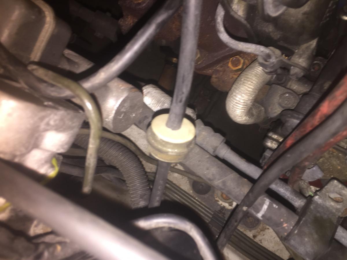

Boost controller is still present in the car. The lines for it are wierd. Got the pick t piece between actuator and turbo. From the t piece in goes into car.. Then there is another hose coming out into a white thing.. Which then goes to the solenoid.. As picture shows

Did you try removing the vac line with the pink t piece in ,blocking the t piece either end and then running a new vac line between turbo and actuator?
Also check all other vac lines to make sure they're not perished or split as a leak in the vac line system could cause ropey/ high idle and lack of boost
white bit is normally in the standard vac line set up anyways bud but if you've got vac lines going into the car try to follow them in case it used to be attached to something (boost gauge) that's no longer there leaving a open airway into the inlet manifold (air/vacuum leak)
