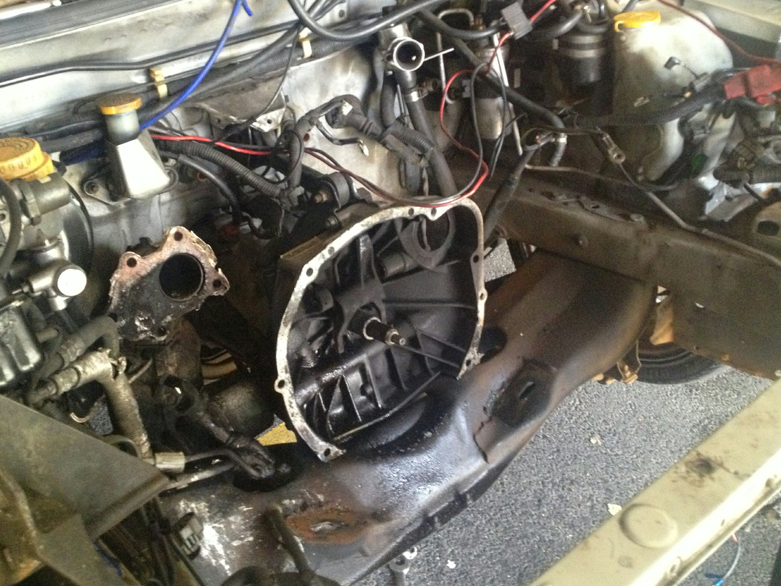

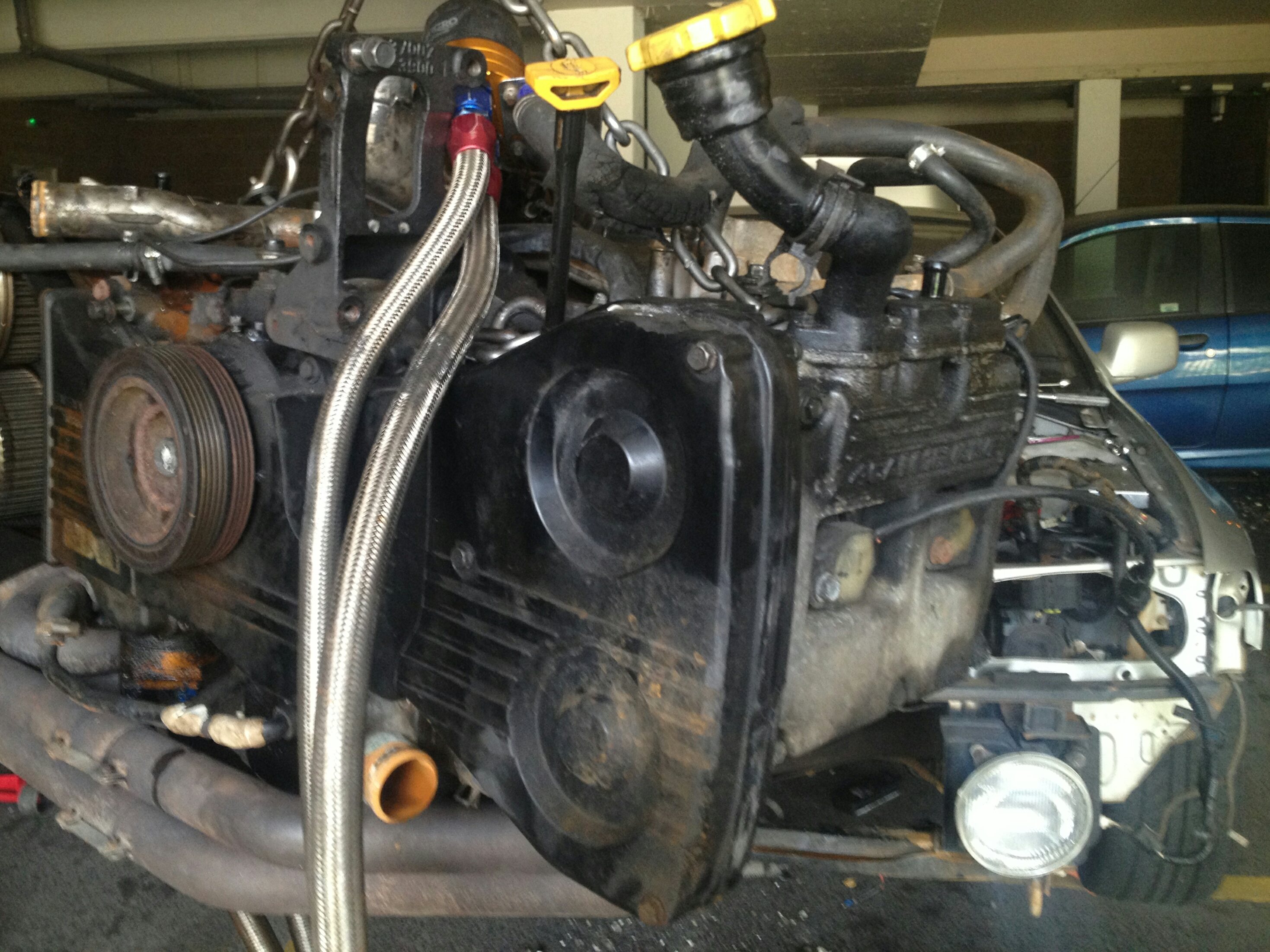

ScoobyGhost,
I really feel sorry for what happened to you and those pics you've shown!!
Was that the mess you were confronted with?
I honestly can't understand how these people sleep at night...but the world seems to have its fair share of criminals
and those that sell duff cars to unsuspecting hard working individuals.
Rik.
ScoobyGhost,
Rik.
That was the engine swap for a replacement engine. Luckily I have a very friendly mechanic friend who did it as a favour. I stripped most the nuts and bolts myself. He had the engine lift and made sure we were all plugged in correctly.
You are not alone in this situation. As you see I've been there and I know your pain right now. The frustration is overwhelming. I'm sorry I can't be of any more specific help.
