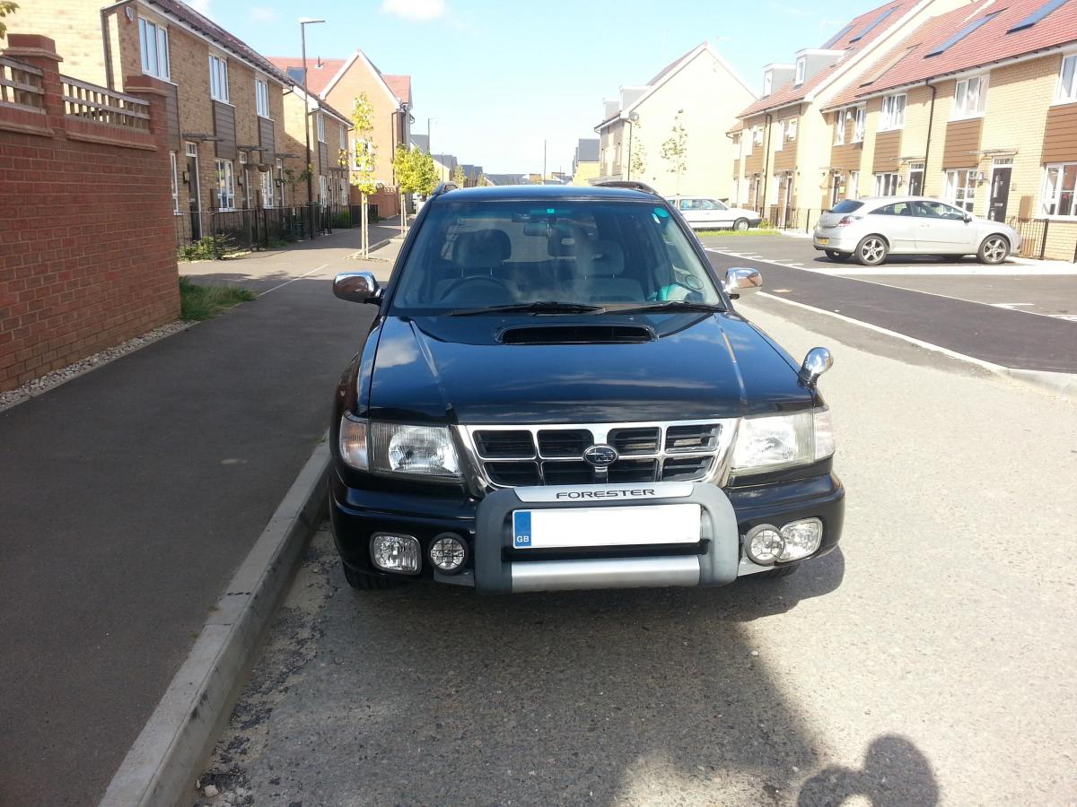

Welcome to the club. Nice forester and love the front bar on it.
