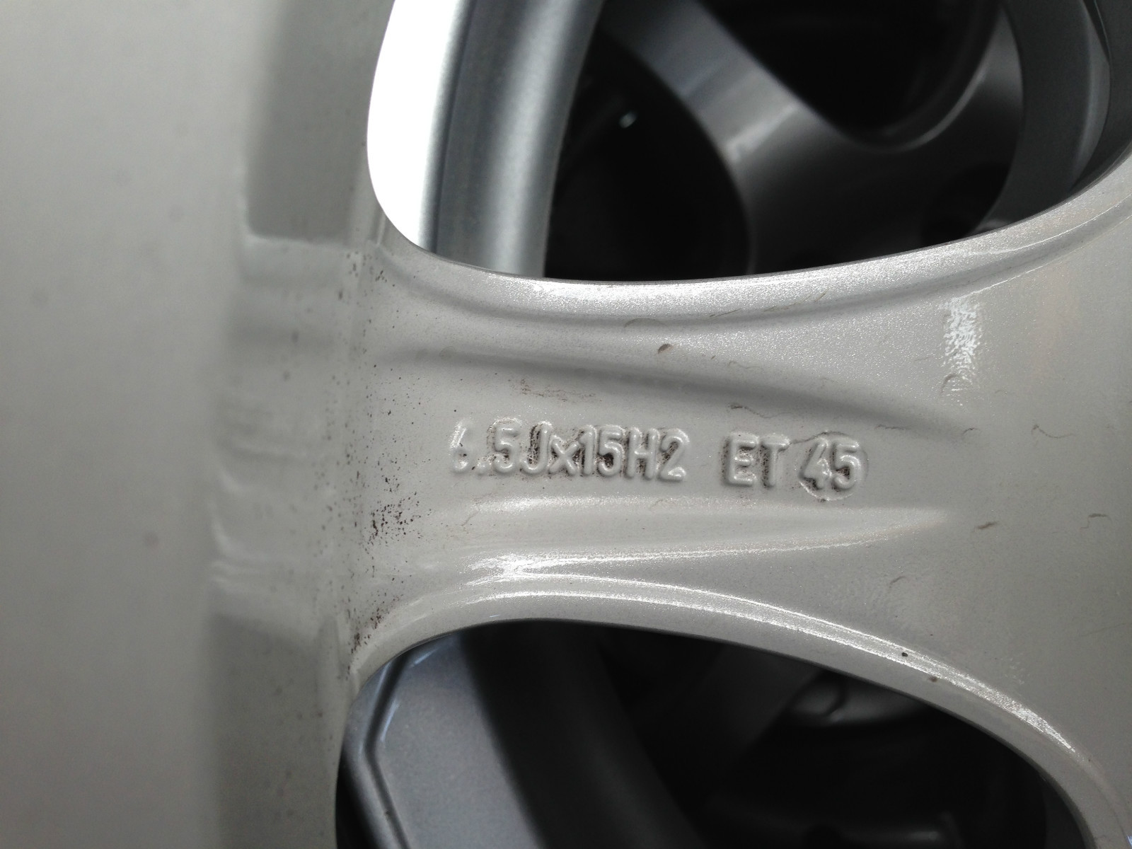

Any idea if these wheels will fit my forester - this is also for Subaru, but Impreza...
Anyone???
Sorry mate for some reason never got the notifications,
The wheels may fit although you'd have to check the clearence on the discs,
