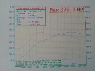

Hey guys im new the forum and have a few questions firstly im in the southeast and need a re-map can anyone recommend some one. And what kind of bhp am i looking at with mods. I have a 99 wrx with decat downpipe and ninja 2backbox, induction kit and fmic not fitted fmic yet as dnt know where to remap was considering ecutek. Any help would be great. [emoji3]

Welcome to the club. I'd highly recommend Duncan Graham @racedynamix. He mapped my car and done a brilliant job and I hear nothing but praise for him from other members. He is mainly based at Surrey rolling road but it is well worth the travel.

As for power, with the mods you have I'd suggest you change to a 3 port boost solenoid (if it's UK) and upgrade the fuel pump. Just for safety. What fuel do you run on? If you use high octane like momentum 99 you will have a higher chance of good figures. Lastly, with a TD04 turbo and your set up you'll make 270-280 if it has a TD05 you could see up to 320.

Standard turbo is unlikley to see 300, more like 260 ish with a td04 on a classic.

It varies from car to car, I've seen one that would do more than 245bhp without detting :o
Simply put not all cars achieve those figures so expect around 260 and anything else is a bonus, also varies from dyno to dyno.
