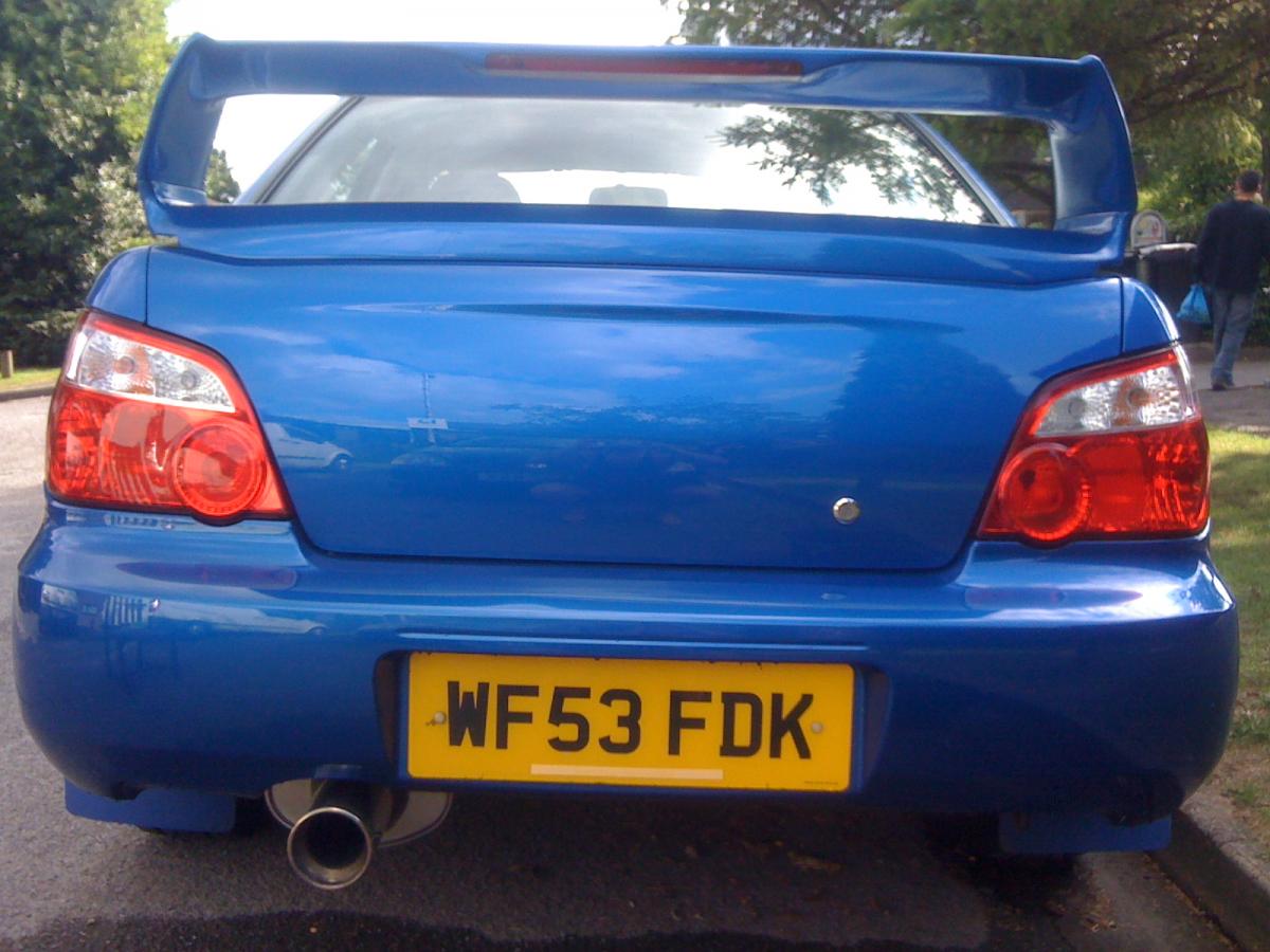

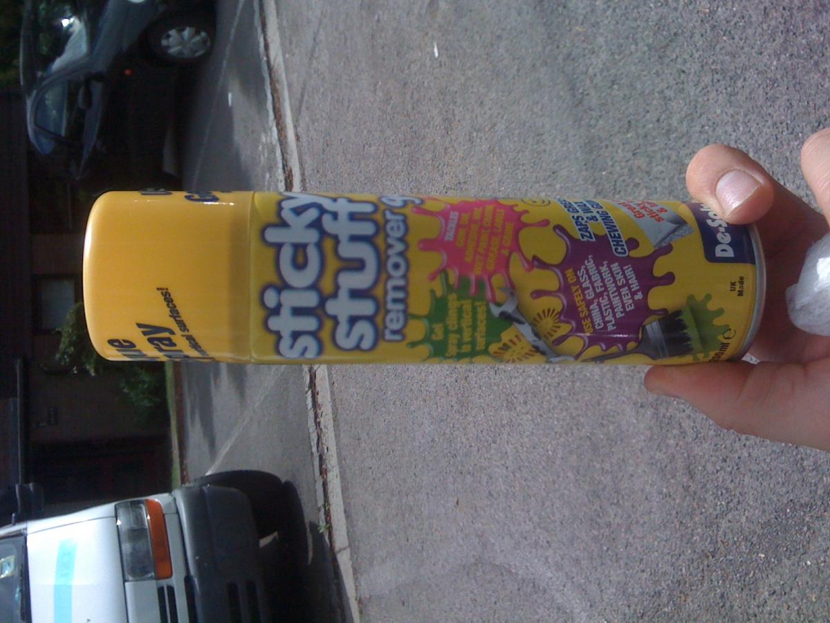

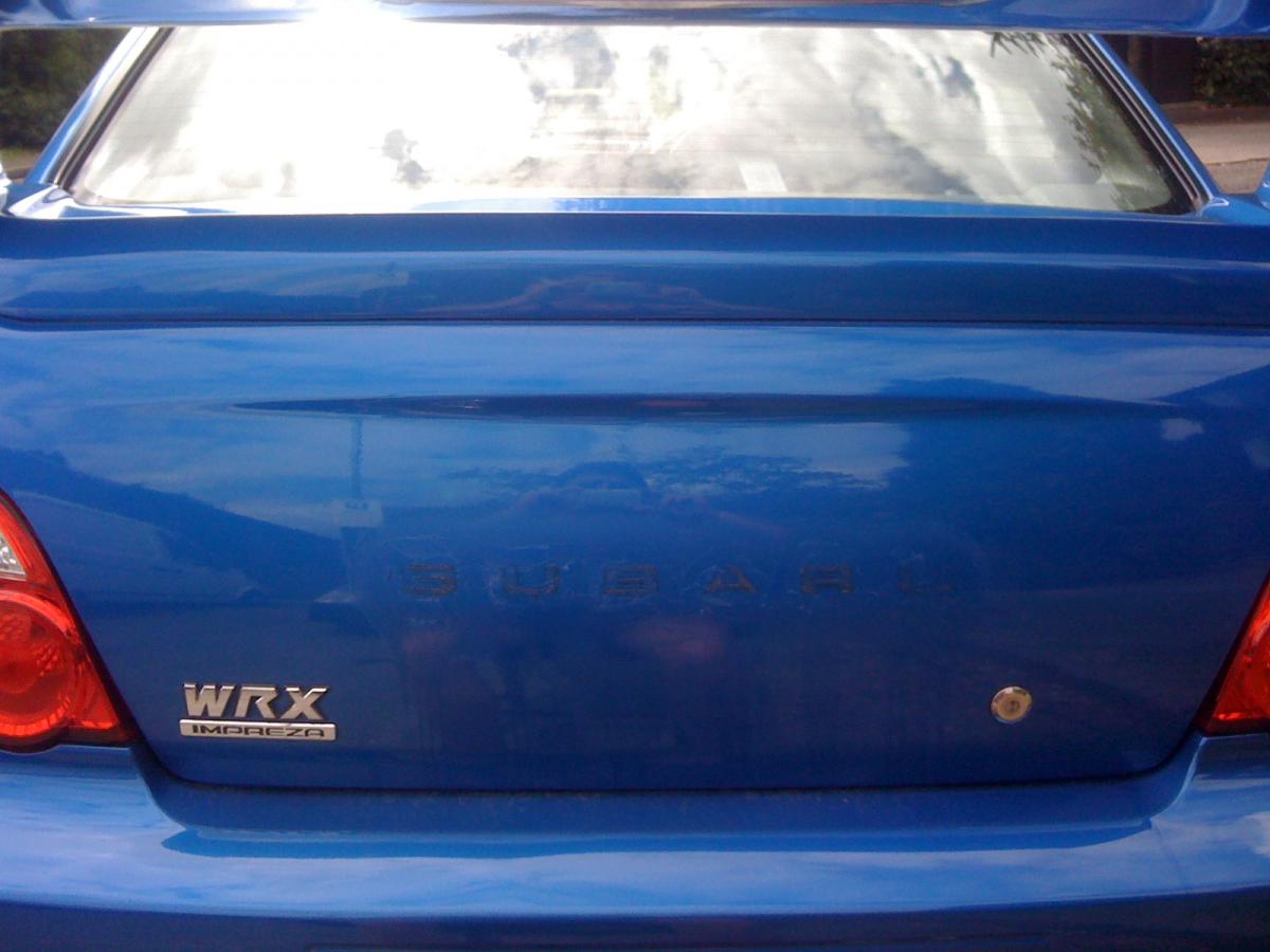

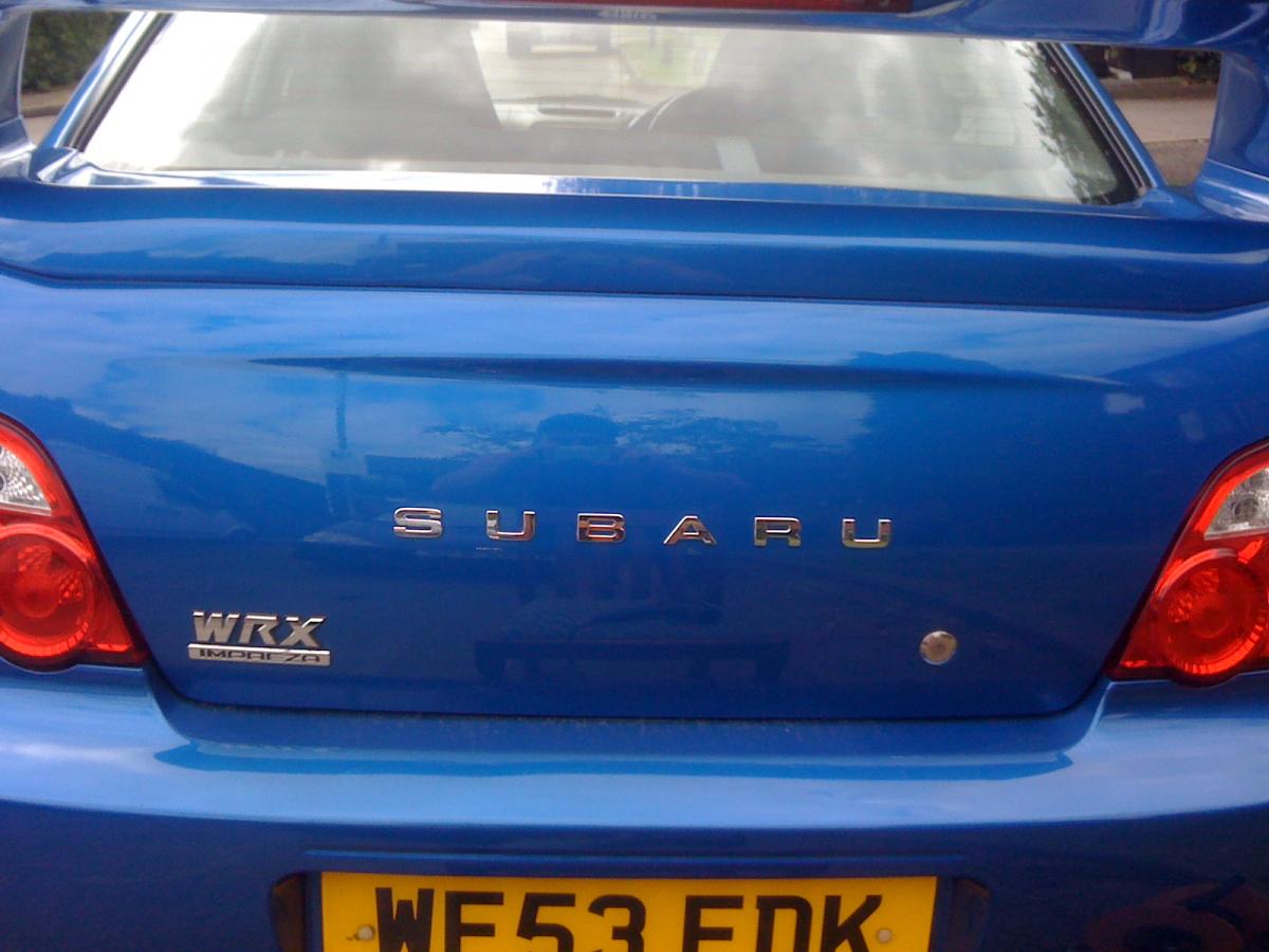

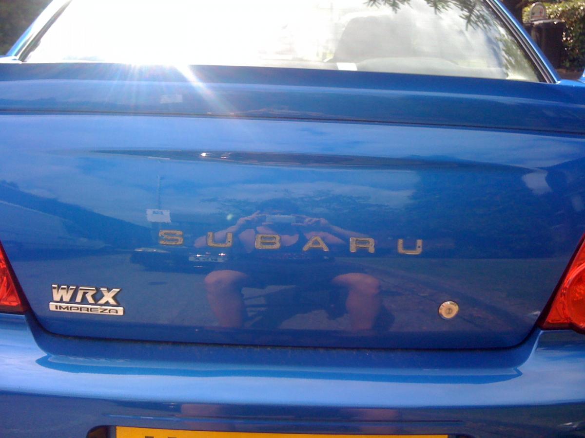

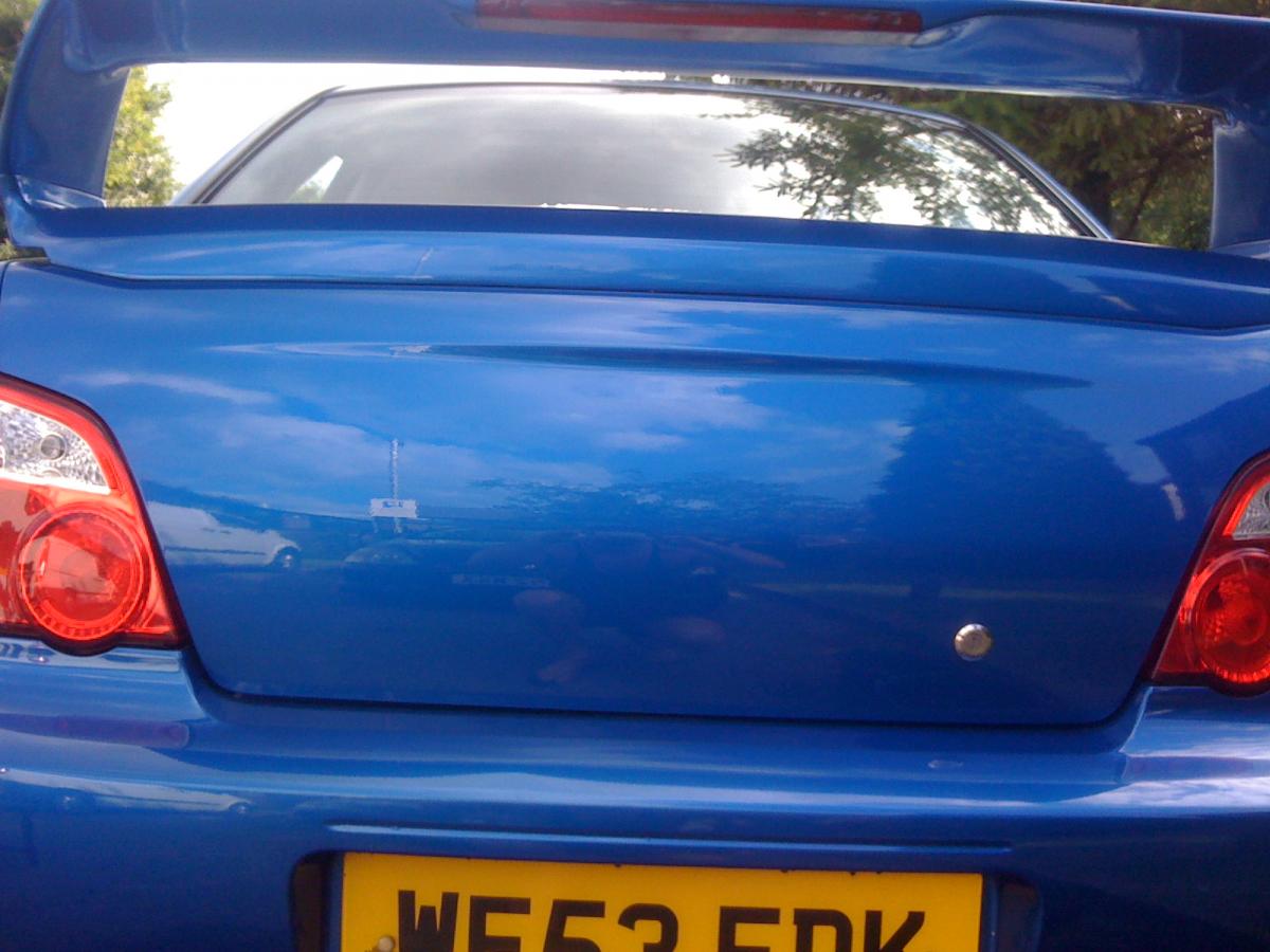

Clinton Posted August 6, 2013 Author Share Posted August 6, 2013 Hi guys, Right i gave this a go today, let me know what you think? I started out with a hairdryer and a plastic ice scraper to get the badges off, this was very easy and only took a couple mins to do. I then sprayed some Sticky Stuff Remover (purchased from halfrauds at 4.99) onto the glue that was left on the bootlid. After a few mins i used the plastic ice scraper to remove the glue. You need to spray and scrape a few times as you wont get it off in 1 go and i wanted to be very careful not to scratch the paint. Once all the glue was removed, there is still the outline of lettering left. I then used Meguirs Scratch X which is similar to T Cut and many other variants that you can get, to try and remove the lettering outline as best i could. I then gave it a wax and hey presto!! To be honest its an ok job, if you look closely you can still see a faint outline of some of the lettering, i probably just need to spend longer and give it more elbow grease!! But i couldnt get it to show in a photo so you do have to look closely. As requested i have taken photos, 1st shows as it comes, then with the badges removed, then a photo with a couple coats of sticky stuff used, then the last 2 are the end result. Thanks Clinton 1 Quote Link to comment Share on other sites More sharing options...
Scooby Pete Posted August 6, 2013 Share Posted August 6, 2013 Looks great. Loads of elbow work for such a small job, bet your right arm looks like popeye's now :D Quote Link to comment Share on other sites More sharing options...
Gambit Posted August 6, 2013 Share Posted August 6, 2013 I agree looks great and you went with the stick stuff remover ;) (Before you ask rubbish on man juice stains mt leather pants are still knackerd) I have some still :D I do like that look really tempted with mine I've liked the debadged look going back to my st170. Top job mate can't tell from the pictures any outline :) Quote Link to comment Share on other sites More sharing options...
Jay762 Posted August 7, 2013 Share Posted August 7, 2013 looks good to me - cant see any outline Quote Link to comment Share on other sites More sharing options...
