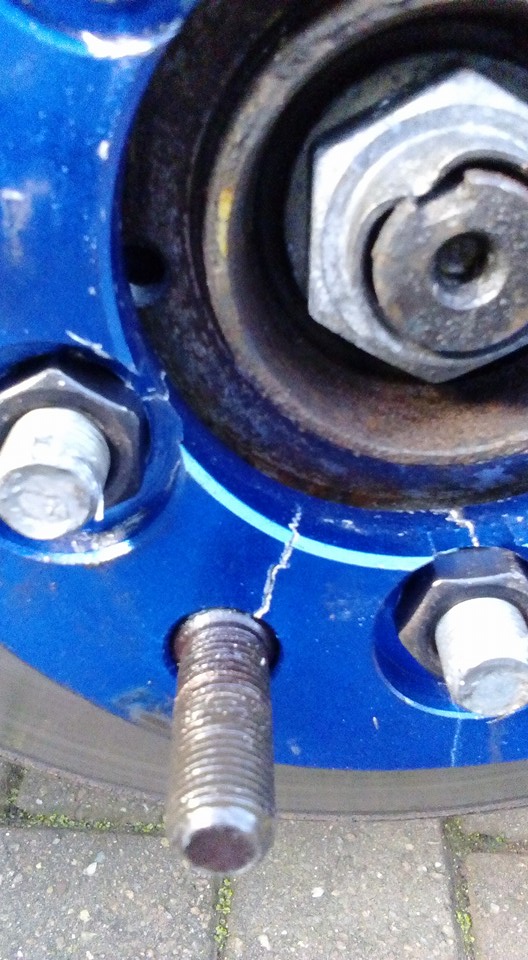

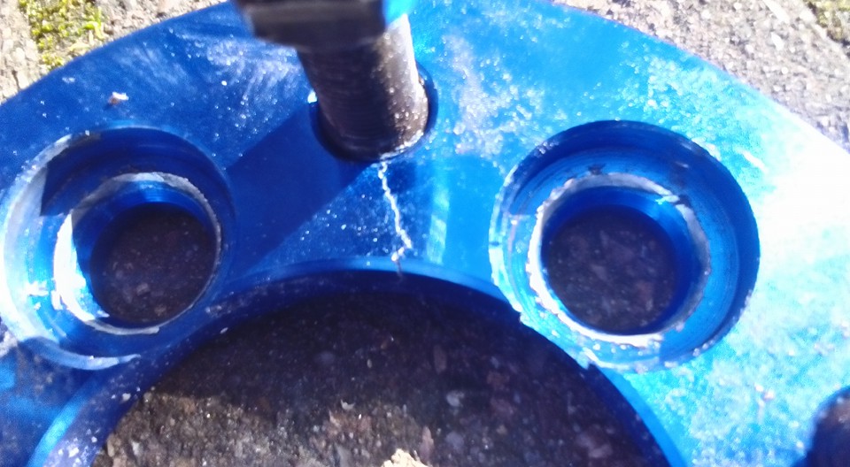

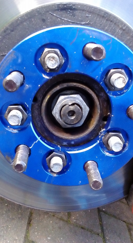

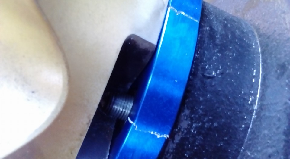

Prime example of using cheap non-centric spacers so just be careful if you do use spacers to check them regually or pay the price and get some good quality ones from a well established brand

WRT the picture posted by Hudson they do not fit on like that - they were all a snug fit to the centre with one needing a little grease just to aid fitting I certainly am not expecting that from these and if it does happen I will be after my money back as my expectation was paying for quality as the machining and fit should ensure support and forces evenly distributed.

Yeah jay they are the proper hub centric ones that sit on the hub rather than putting the weight on the bolts, those blue ones I posted look like some nasty eBay rubbish not even fitted with the right nuts
