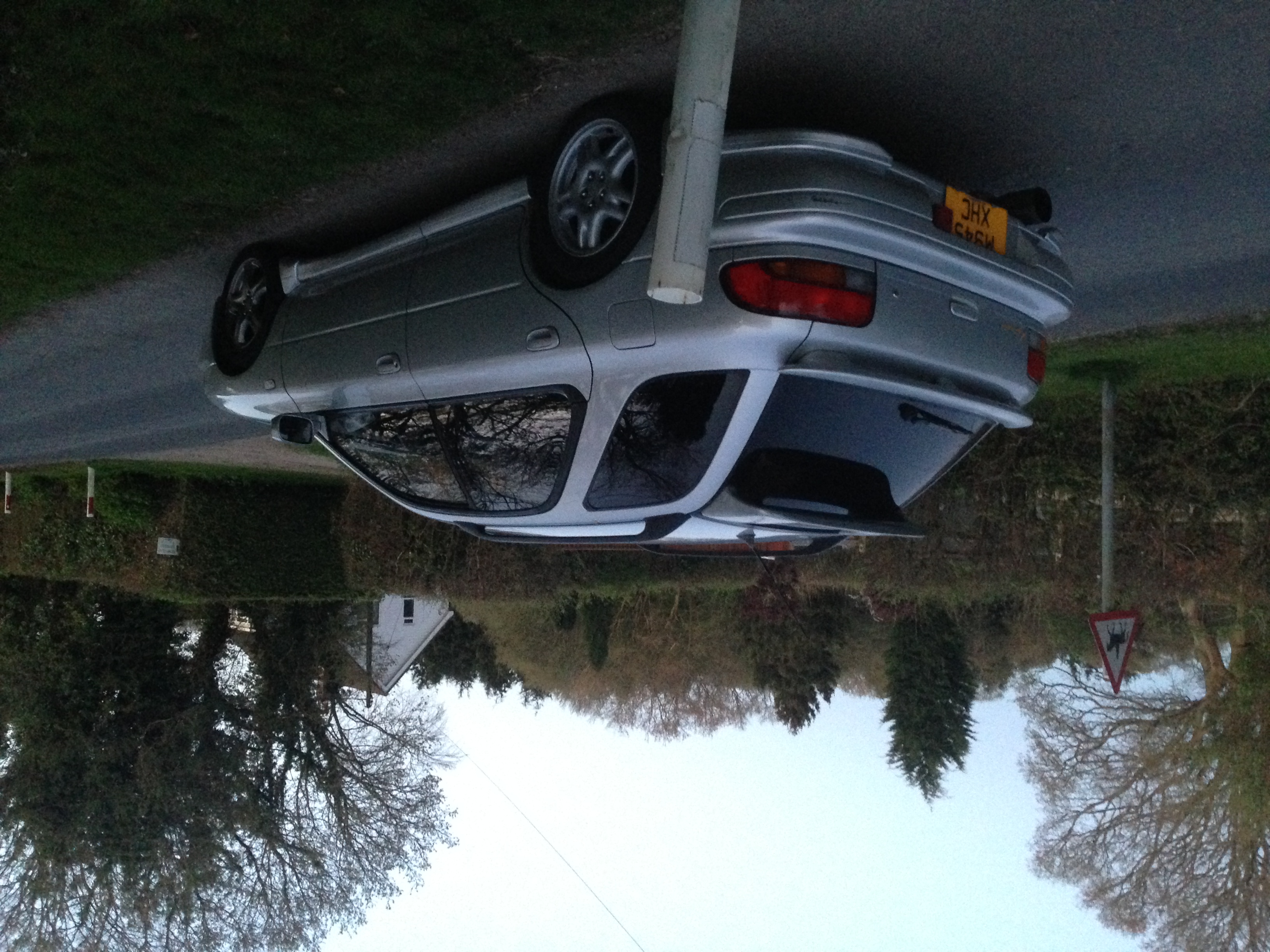

Some hell'va sticky tyres you've got on that wagon [emoji39]
