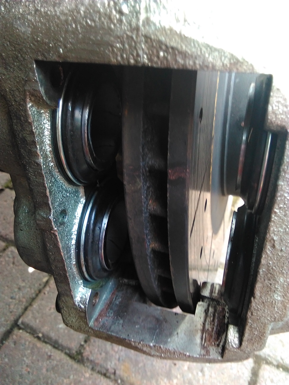

Fixed! It was the brake pads... when I held them I was able to wiggle them slightly, so took them out checked everything and reseated them, seemed pretty solid, went for a drive and no clunk! I did however notice that one of the pistons is missing a metal ring, see pic below... it's the bottom right piston. Anyone know what it is and should I be worried?

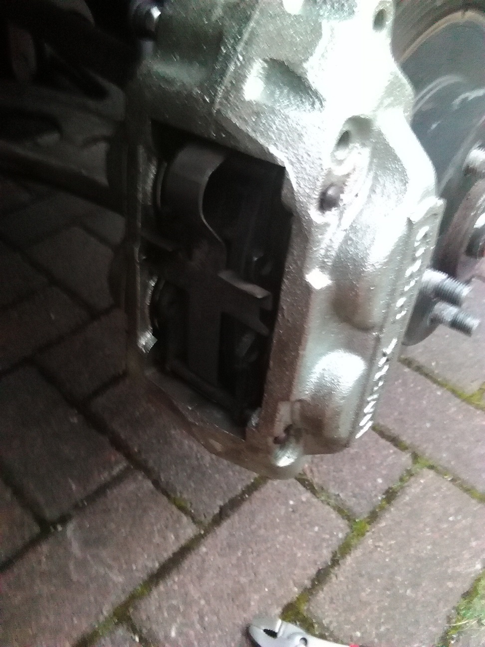

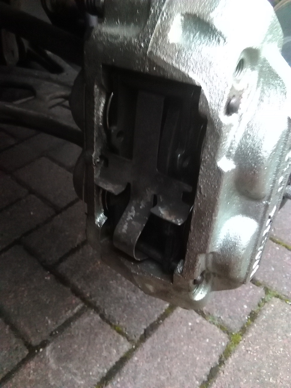

After even more research it is looking likely that the culprit is the caliper pin metal clamp thing... apparently the curvy end of it should be at the top of the caliper, whereas mine are upside down...
I'd never noticed before which way they were so had no reason to believe they were the wrong way around. Quite embarrassing for the garage since they inspected the car for the best part of an hour when i went back with the clunk, only for them to say that it wasn't the brakes and must be the suspension!!
