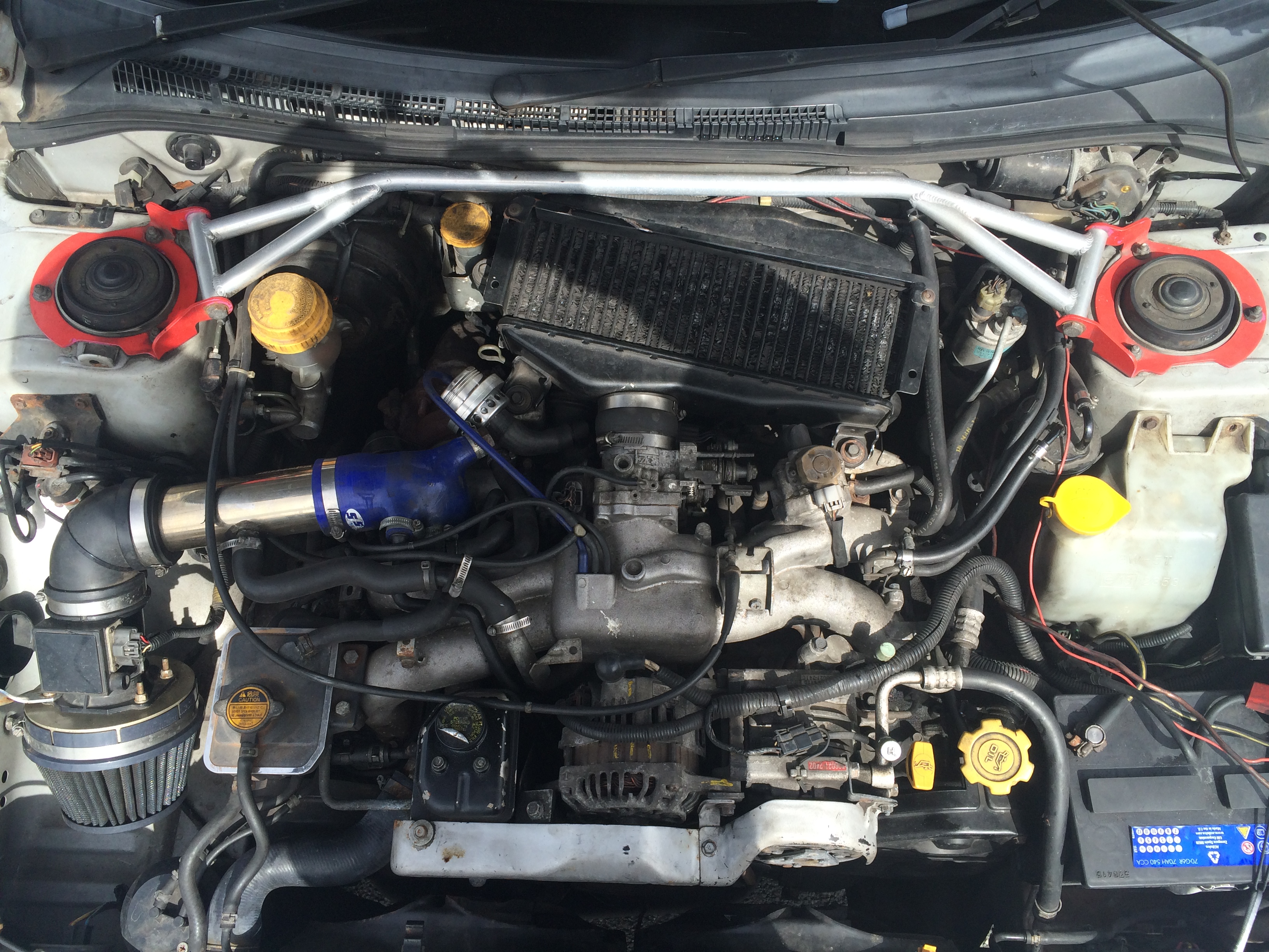

1996 JDM Impreza wrx import model gc8 c48d
mileage is 130,000 mixture of kilometres and miles
couldn't tell you when cambelt was last changed either sorry
driving along at 75- 80 mph heard a noise like something was loose slowed down noise was still there sped up noise got worse so I quickly stopped on the motorway with engine running with a knocking noise and when revving it sounded like something was loose but none the less engine was still running with no warning lights on dash
I really need help on this I'm a first time Subaru owner and only had the car 2 days before this happens other than this the car ran and pulled like a dream for her age very tight and stern never missing a beat. Please help

As its ticking over its tick tick tick tick tick and then when I apply the throttle gonna sound funny but only way I can describe it is from a tick to a clink noise then back to the tick I have a video but can't post to this if you pass a number or email I can show you and you would understand need to know exactly what the problem is before I decide what to do

It's never easy to diagnose faults without seeing it but if the knocking sound increases in volume with a increase in revs it doesn't sound good I'm afraid.
Even with a video it can be easy to misdiagnose a sticky tappet lifter or a bad manifold blow for a knocking bottom end .
If it has "spun a shell" it's gonna need a full rebuild, as you can't access the crank shells without splitting the block halves and removing the heads .

If you do need a replacement long engine (block and heads) or any other bits , yours is a version 1 with a phase 1 inlet manifold/fuel system .
Any v1 to v4 impreza long engine will fit if you use your car's inlet manifold, auxiliaries and sensors.
