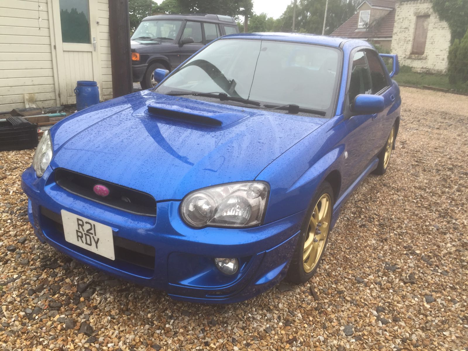

So imagine that you have just bought a JDM blobeye for relatively cheap. It's pretty much stock except a few STI parts.
You find that because you spent less than you was expecting, you have £1k spare to start the mods.
What would be the first few things you'd buy?

After driving it today, i feel handling mods are the way forward, starting with brakes.
It's just had a full service including all fluid, even gearbox and diff.
I'll be looking to get a health check and dyno run ASAP!
